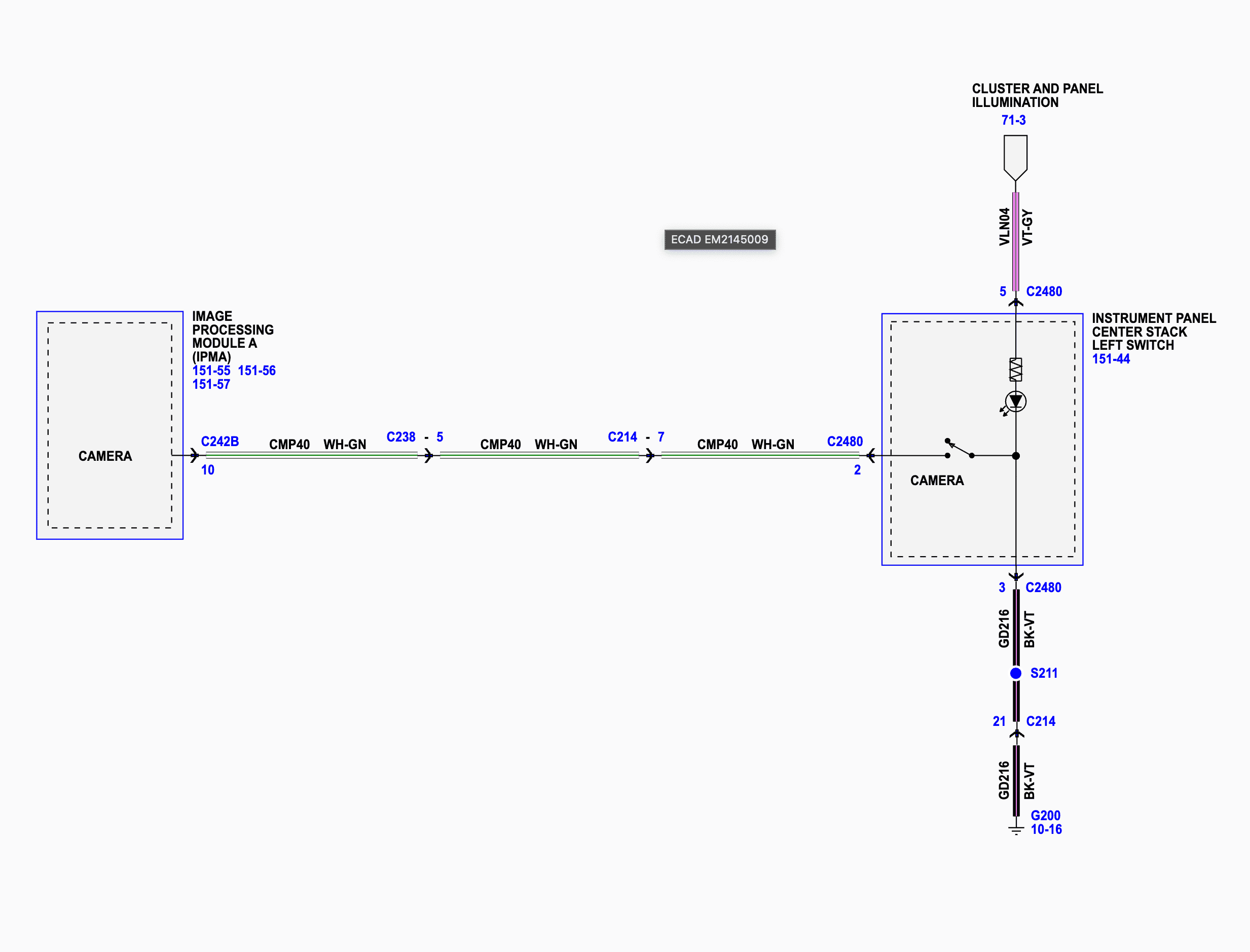

I'm looking in to wiring up my own button. Here's the wiring diagram for the button that you get with the 12" screens.
Looks like we need to add a switch to pin 10 of the IPMA module's connector C242B.
Hey Pete, not sure where you got these diagrams but are you able to find the same for a 2021 + Ford Edge? I ask because the edge has a Sync 4a 15" screen and a physical camera button. I'm wondering if the APIMs wire differently and your diagrams would confirm. Side note, and MAYBE a reason why Ford didn't include this in the F-150; Ford Edge has an outstanding recall to repair the button not activating the 360-camera/reverse camera and is yet to develop a fix.
