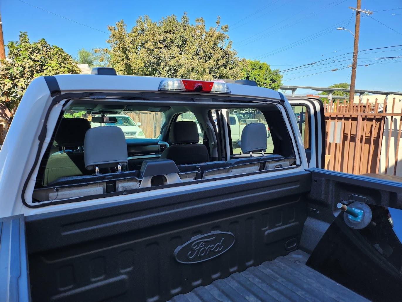

Our XLTs and Pro trims don't have a sliding rear window. Not even an option for us unfortunately. I had an aftermarket manual sliding window installed yesterday. It's the same glass size from the previous generation F150. I wanted the window for trips to Home Depot. I haul around 2x4s and pipe often enough and I hate having those stick out a few feet past the bed. It's just easier to load and tie down if I can stick 8 or 10ft items through the window.
I initially wanted to do an OEM power sliding window however the wiring is not there. Buying the hardware and switch isn't a big deal, but I didn't really want to run my own wiring in such a new truck. I went with this aftermarket manual option. It was cheaper and solves my use case.

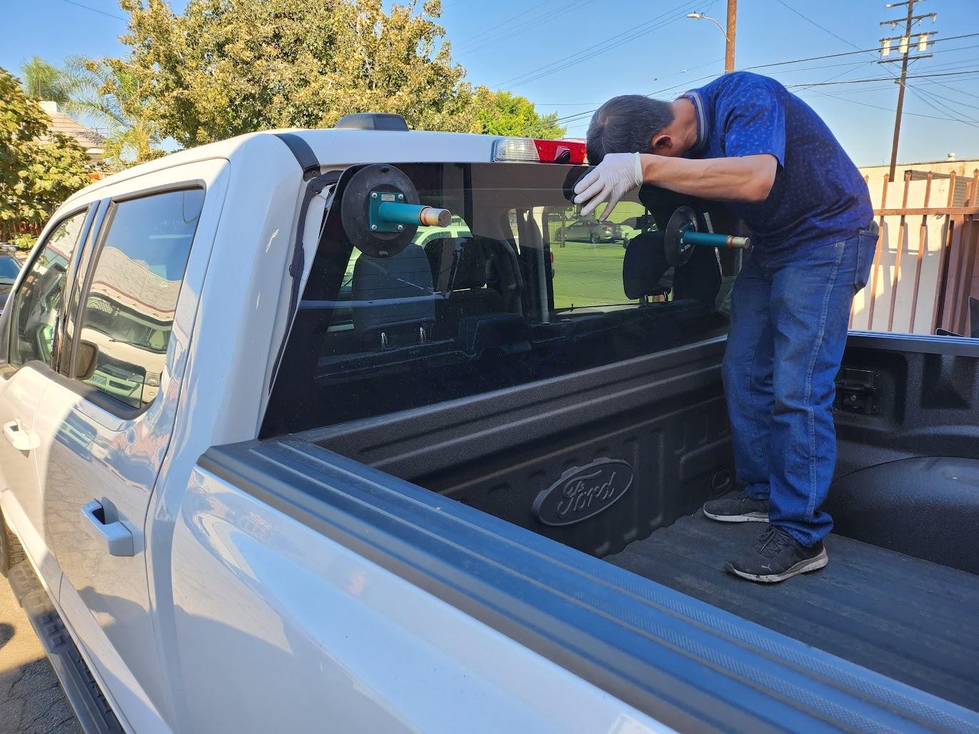

If you're in SoCal, I went to JDS AutoGlass in El Monte. They also sell on eBay and ship nationwide. They import the glass themselves from China and apparently supply a lot of other shops. The prices seemed very affordable and I'm happy with this.
Cost: the whole window was $289 and I paid them $100 to install it.
Ford F-150 Lightning Sliding Rear Window Retrofit (Manual) 20221018_141142
Ford F-150 Lightning Sliding Rear Window Retrofit (Manual) 20221018_141227

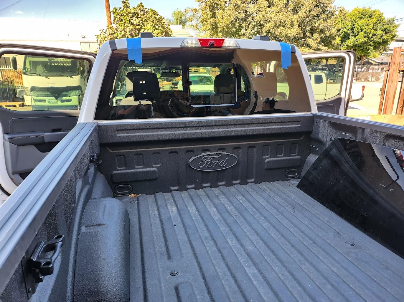

Ford F-150 Lightning Sliding Rear Window Retrofit (Manual) 20221018_142123
The factory sealant was pretty thin over on the lower right hand side. They definitely made sure there would be enough on the replacement window.

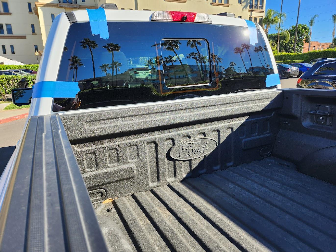

Ford F-150 Lightning Sliding Rear Window Retrofit (Manual) 20221018_144120
Its all flush and clean like the original. Yeah it doesn't say FORD on the glass but the price was right. I wish aftermarket glass companies would instead put no logo. Just adds no value seeing another brand on the truck. I'll wait 2 days and water test the seals.

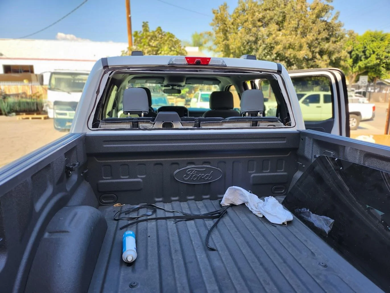

Ford F-150 Lightning Sliding Rear Window Retrofit (Manual) 20221019_092526
The replacement glass has defroster wiring. You can see the trace lines a little more than stock around the window opening. It's more visible in direct sunlight but otherwise not really noticeable. I don't have any pictures of the OEM Power Slider inside to compare to that. If someone could post one and I could speak to the interior differences. Only the top part of the window frame is visible from inside. It doesn't really seem to stand out.
