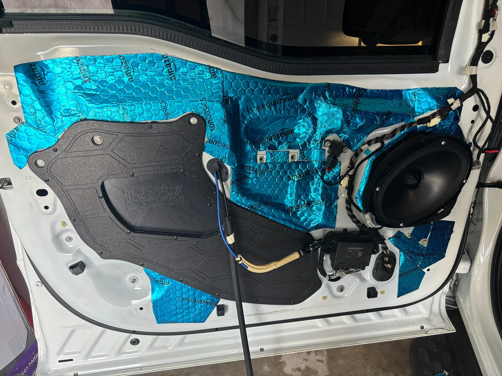

I’m going to find out soon on my xlt base system. Got the kicker 200.4 amp, Amazon sound deadening and the sgs door plates. Gonna see what them stock speakers can take

On a positive note, the keypad harness is inside the door connected to a dummy plug clipped to the side impact reinforcement. I miss that keypad on my 2013, now I can have it again on my 2025, keypad and pillar cover ordered. 😋

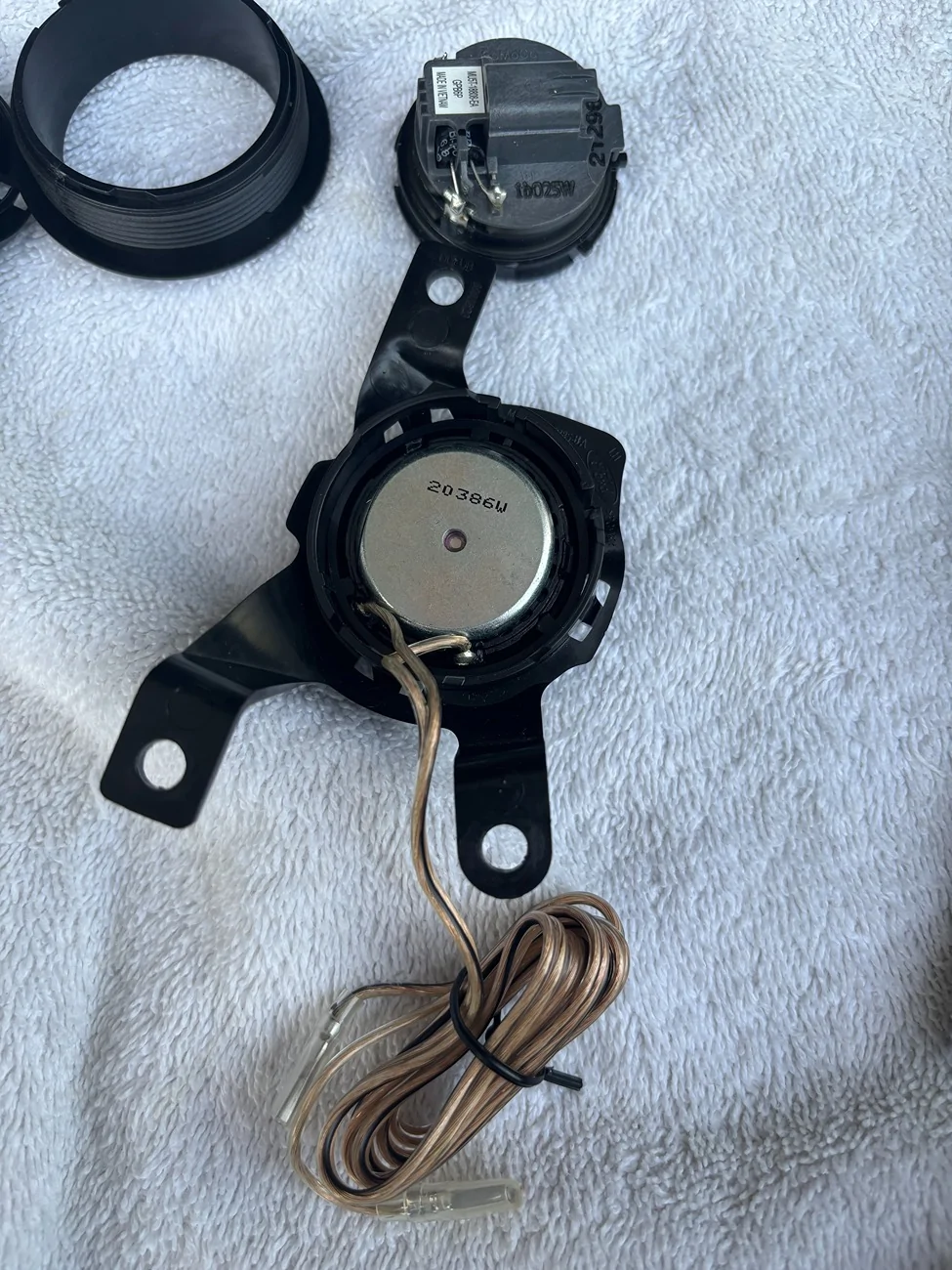

I went with the coax models over the component, left the oem tweets.The highs are brilliant now, much better than before just needs more power.

Alpine S2-S69, using the Metra 82-5606 adapter plates. It all fit nicely, but I thought the provided screws were too small. I think the screws came with the adapter, they were #8, I used #10 sheet metal screws.
They must have heard the feedback because the kit came with a bunch of screws, many were too long lol but had the proper screws. I reused the original speaker screws to attach the spacers.
