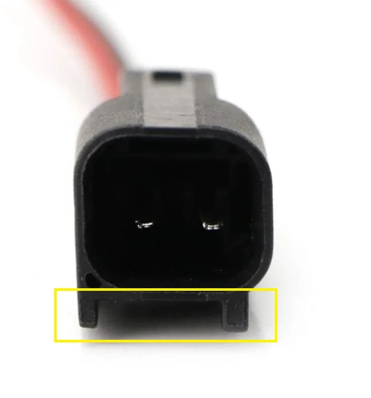

That ended up not being worth the cost & hassle...you have to cut one end off of the new harness, still splice and cut/dremel a piece of the harness off to fit in the plug when center is removed.
Ford F-150 Lightning Low / Medium Cost Audio upgrade harness
To top it off (at least in the case of the one I bought), the polarity was reversed from the new harness to the 3.5 harness...so I had to swap the spliced wires (+/-).

So you went with something different from Dayton to the mounting wings? I found this harness as a potential fit from digging in an F150 forum if anyone has experience with it. https://ebay.us/m/RD1qdW

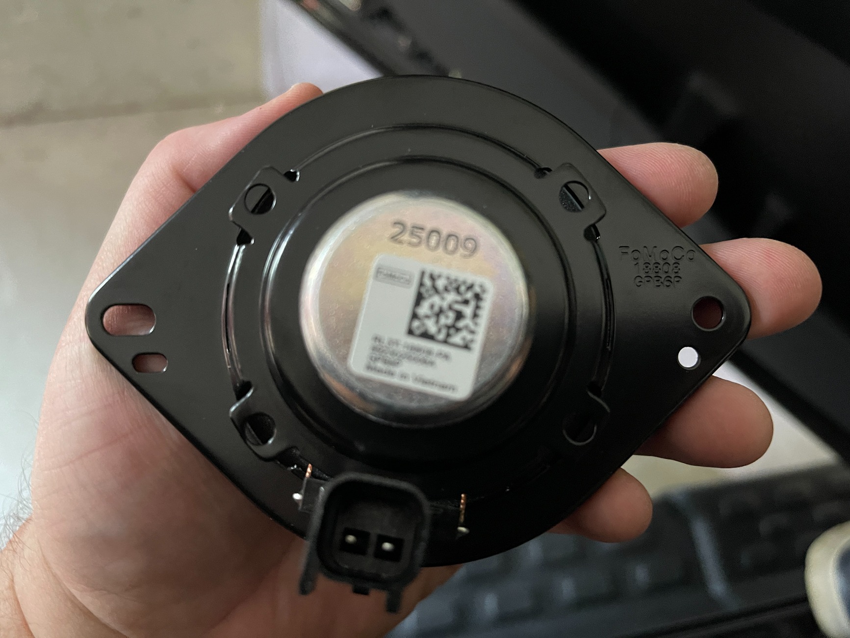

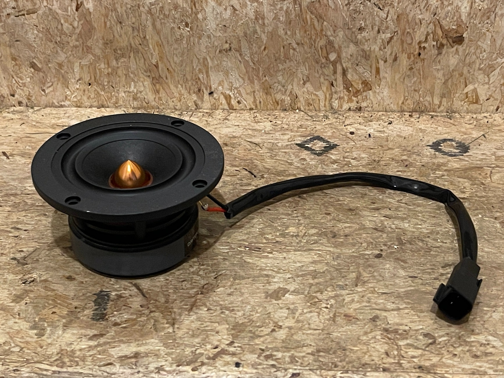

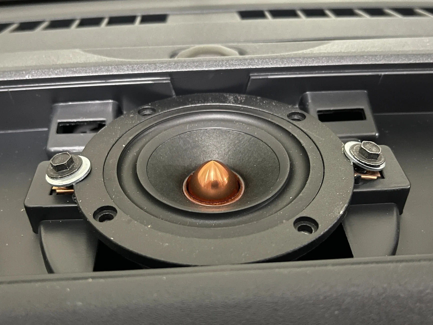

Replacing the center speaker
NOTE: I have a 2025 Lightning Lariat. The factory speaker/mount/connector look different than some of the pictures I've seen in various posts.
Today I got in the "Dayton Audio PS95-8 3-1/2" Point Source Full Range Driver 8 Ohm" (came a couple days early from Amazon via USPS) and the "iJDMTOY 18-Inch Plug-N-Play Third Brake Light Extension Cable Harness, Compatible with Jeep 2007-2018 Wrangler JK JKU". Links at end of post.
I was afraid the cable harness wouldn't work based on posts here and other sites, but that was unfounded. I just cut it in half, trimmed back about 1/4" of the wire casing, and soldered them to the Dayton 3.5" (black to smaller negative lead on the left, red to larger positive lead on the right). NOTE: Before soldering I made sure I had the right half of the harness and plugged it in temporarily just to make sure it was working.
To mount the actual speaker, I wasn't sure what I was going to do. Any mount with "wings" that looked like it would fit seem to be coming from China. And I don't have a 3D printer to print my own from thingiverse. I pinged a couple friends but haven't heard back from them yet.
I thought of chopping the factory speaker out of its mount, but didn't want to spend a bunch of time with a dremel cutting the supports/etc.
Turned out, I don't really need any kind of a mount. The Dayton Audio speaker fits perfectly in the stock hole, in fact, the alignment nubs work to center it/hold it in place. The factory 7mm screws have a washer head and there's really enough there that the two screws would hold the speaker securely in place. To give it a little extra I added some slightly bigger washers.
Tools used: trim tool to pop out speaker cover from dash (the two back/middle clips broke and fell into their holes never to be seen again), 7mm socket, wire cutter/stripper, soldering iron.
Haven't really spent any time in the truck yet since doing this. Will report back on any perceived differences when I can.
Original factory 3.5" Speaker

Dayton Audio 3.5" Speaker

Fantastic, thanks. You say you used a soldering iron? For what exactly?
F150Redux
Daniel
Jun 13, 2025
154
166
2025 F-150 Lightning Lariat
Computer Geek
I used the soldering iron to connect the harness/adapter to the replacement center channel speaker, as shown in one of the pictures. This way I didn't have to cut the OEM wiring.
