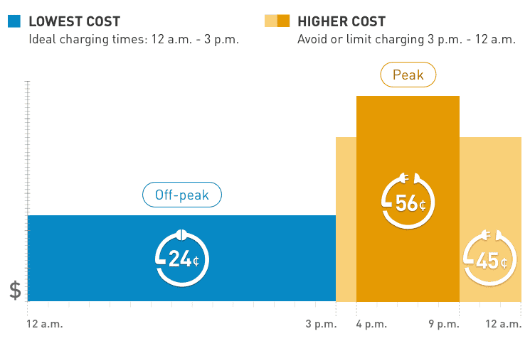

For the setup you detailed - it looks like you are considering the EV-B plan....-
https://www.pge.com/en_US/residenti...cle-base-plan/electric-vehicle-base-plan.page
https://www.pge.com/tariffs/assets/pdf/tariffbook/ELEC_SCHEDS_EV (Sch).pdf
Ford F-150 Lightning Stand alone off grid solar charging, given CA &PG&E 1655241704691

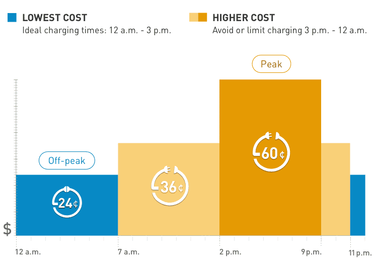

Compared the EV2-A plan (no extra meter required):
Ford F-150 Lightning Stand alone off grid solar charging, given CA &PG&E 1655241893999
...From the looks of the charts, Unless you needed a lot of power between 3pm to 12 midnight, it doesn't look like you'd get much of an advantage with EV-B and would take a while to recoup the price of the second meter?....
