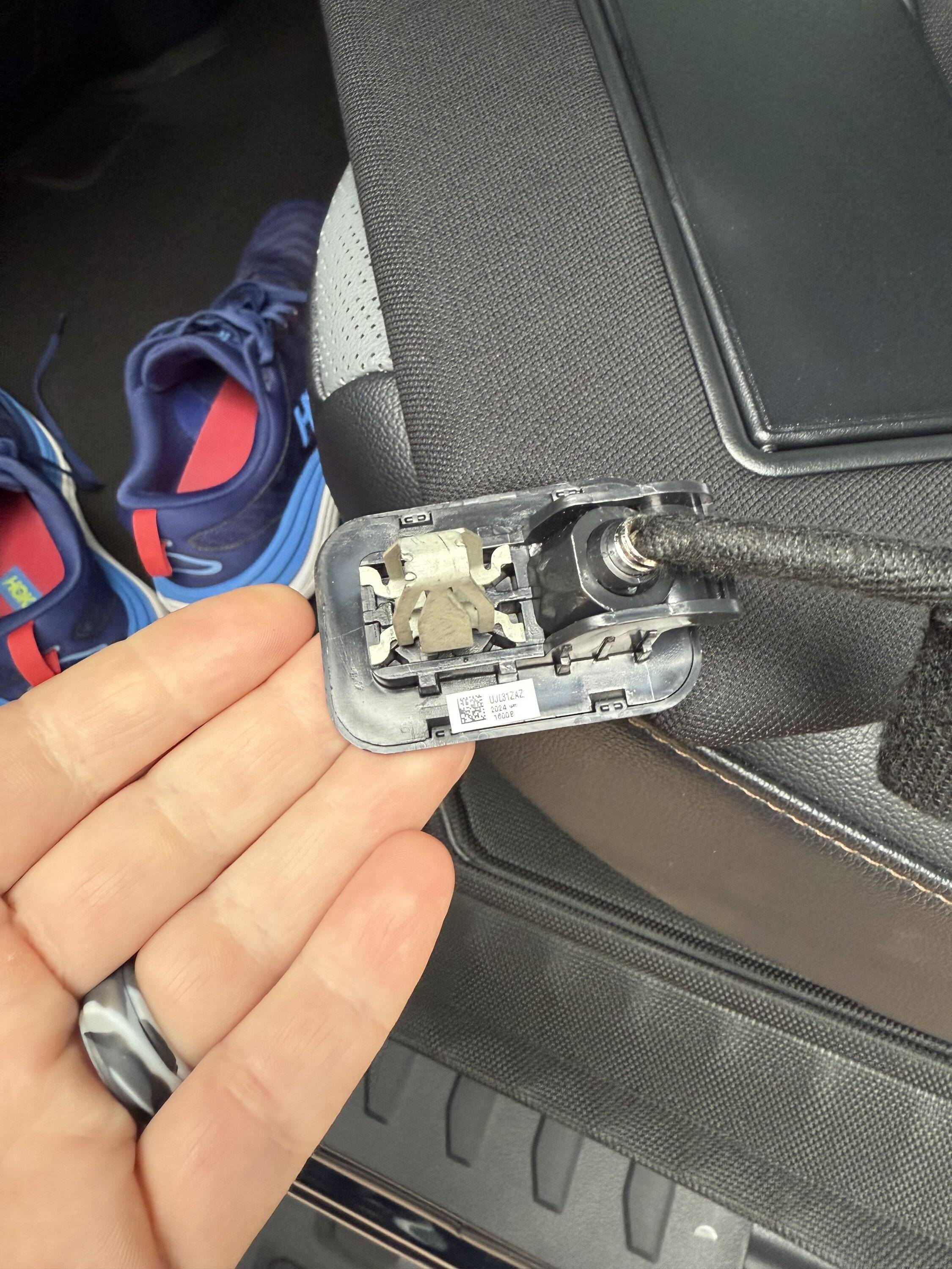

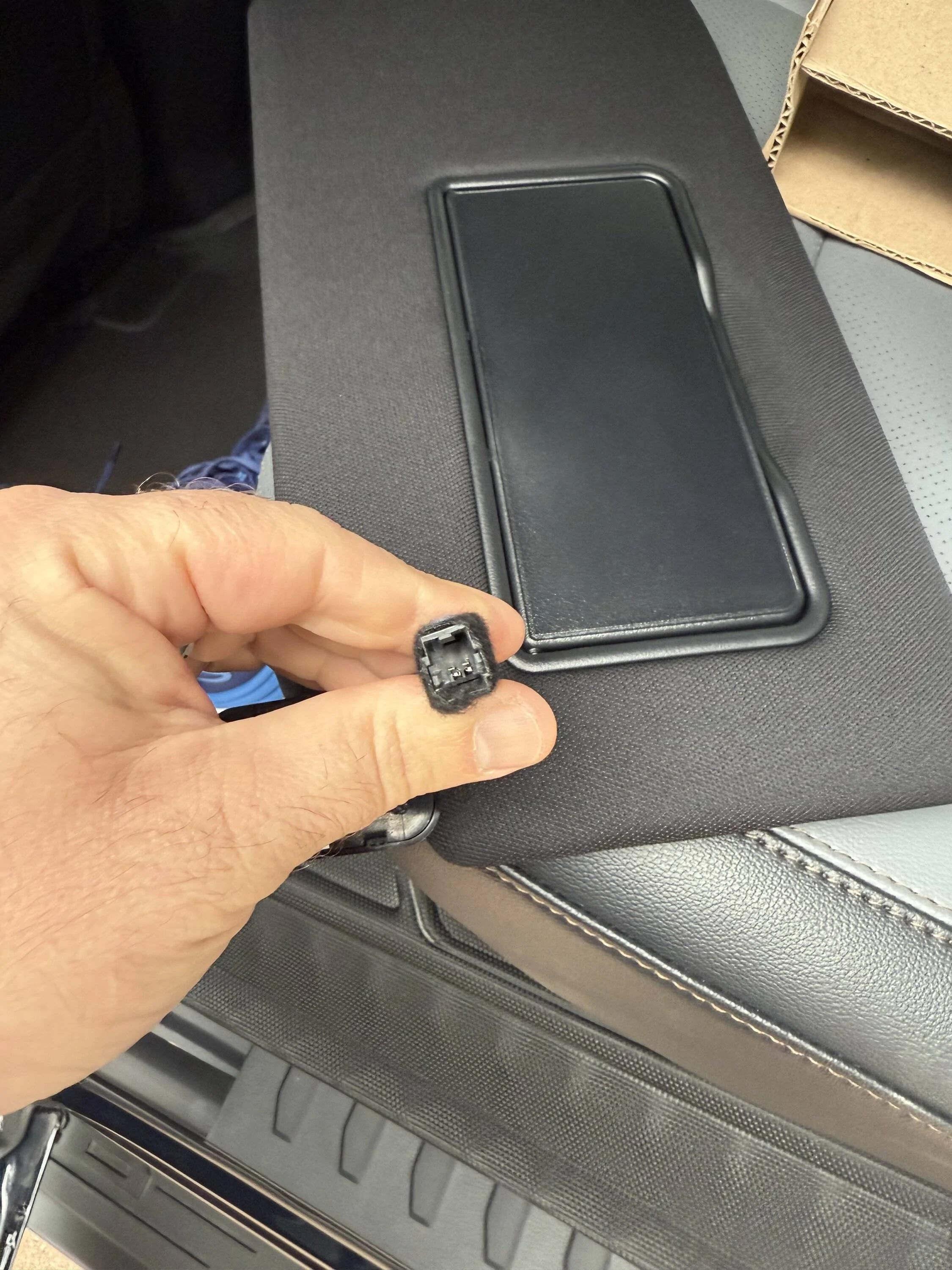

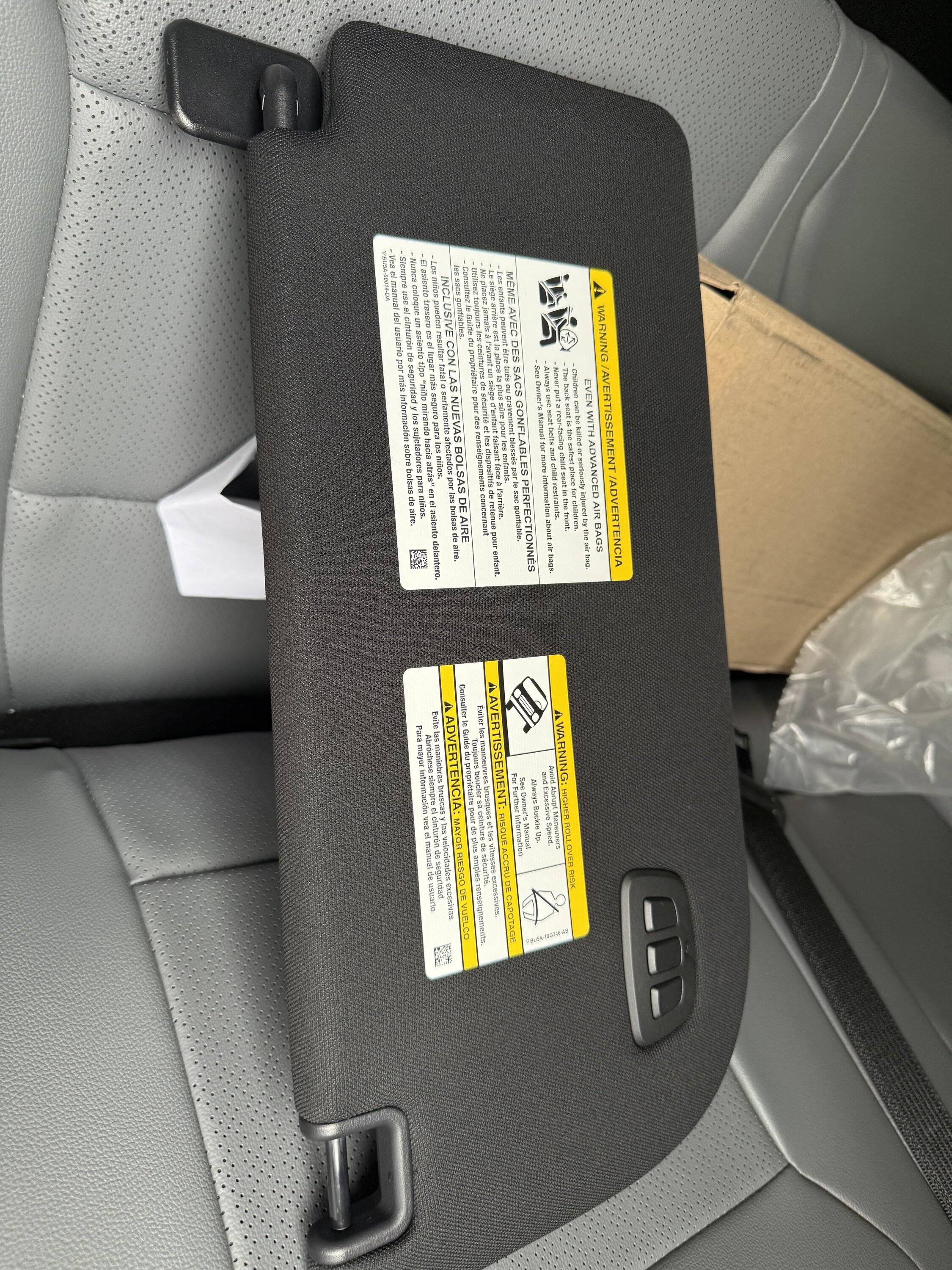

Purchased a 2024 Lightning Lariat. I saw the posts regarding the rear view mirror mod/change...I don't like the reach and I really don't like touching my rear view mirror.
So decided to go this route.
If you have a lighted mirror in your visor its plug and play.
Part number for black: # JL3Z1504105ZC
This is for a truck with a sunroof. I searched for a 2023 F150 visor and just narrowed it down to a left side with sunroof, black, with remote.

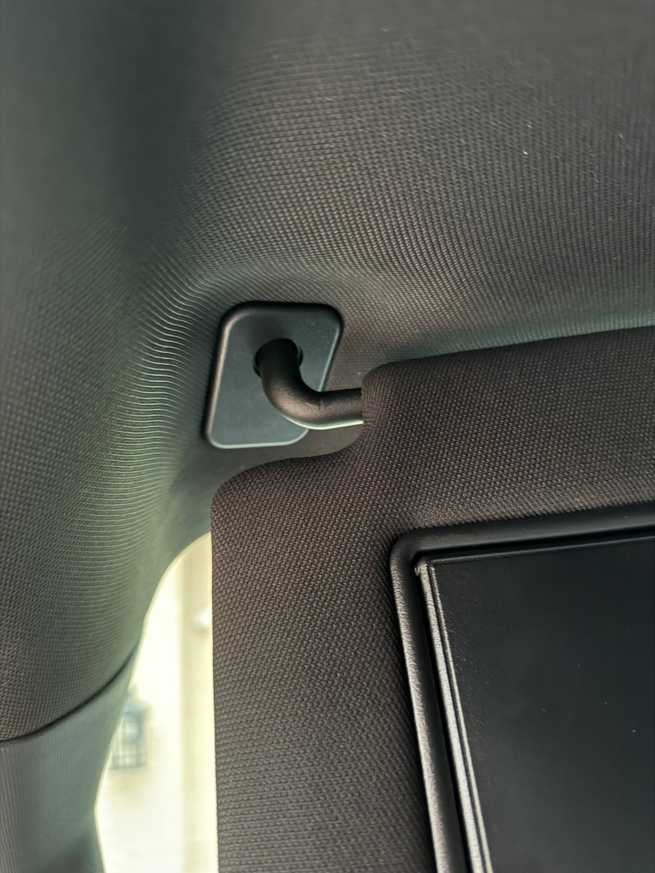

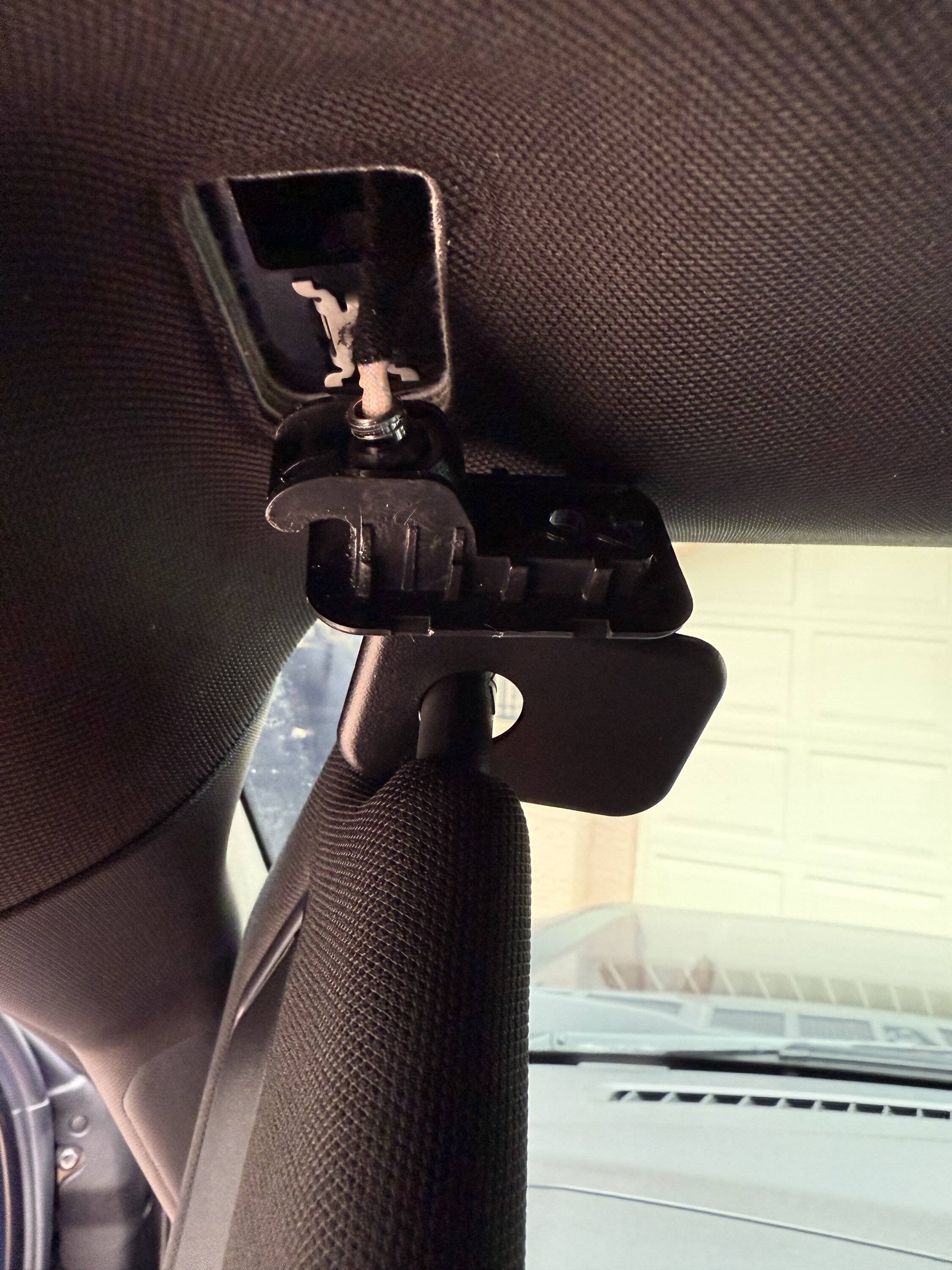

Pry the trim cover off the bracket where it connects to the ceiling
Used a 7MM socket to remove screw
visor assembly swings toward driver and towards ceiling to get anchor out. When doing this step, swing visor back to normal location but fold down as if the sun was in your eyes and it will rotate out.
un plug and you are free.

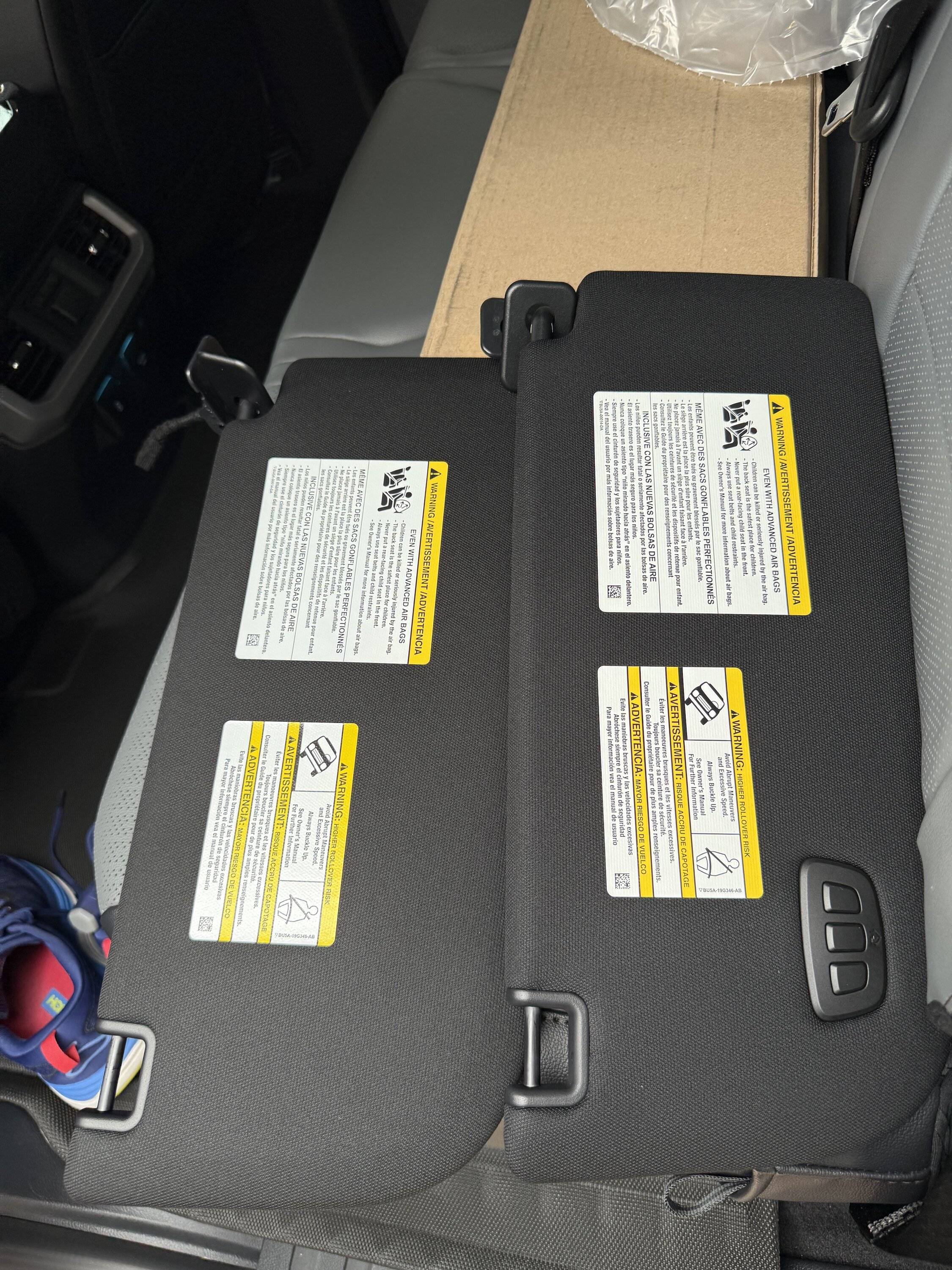

As you can see the visors are identical.
I plugged in the new visor and went the reverse order and it worked perfectly!
