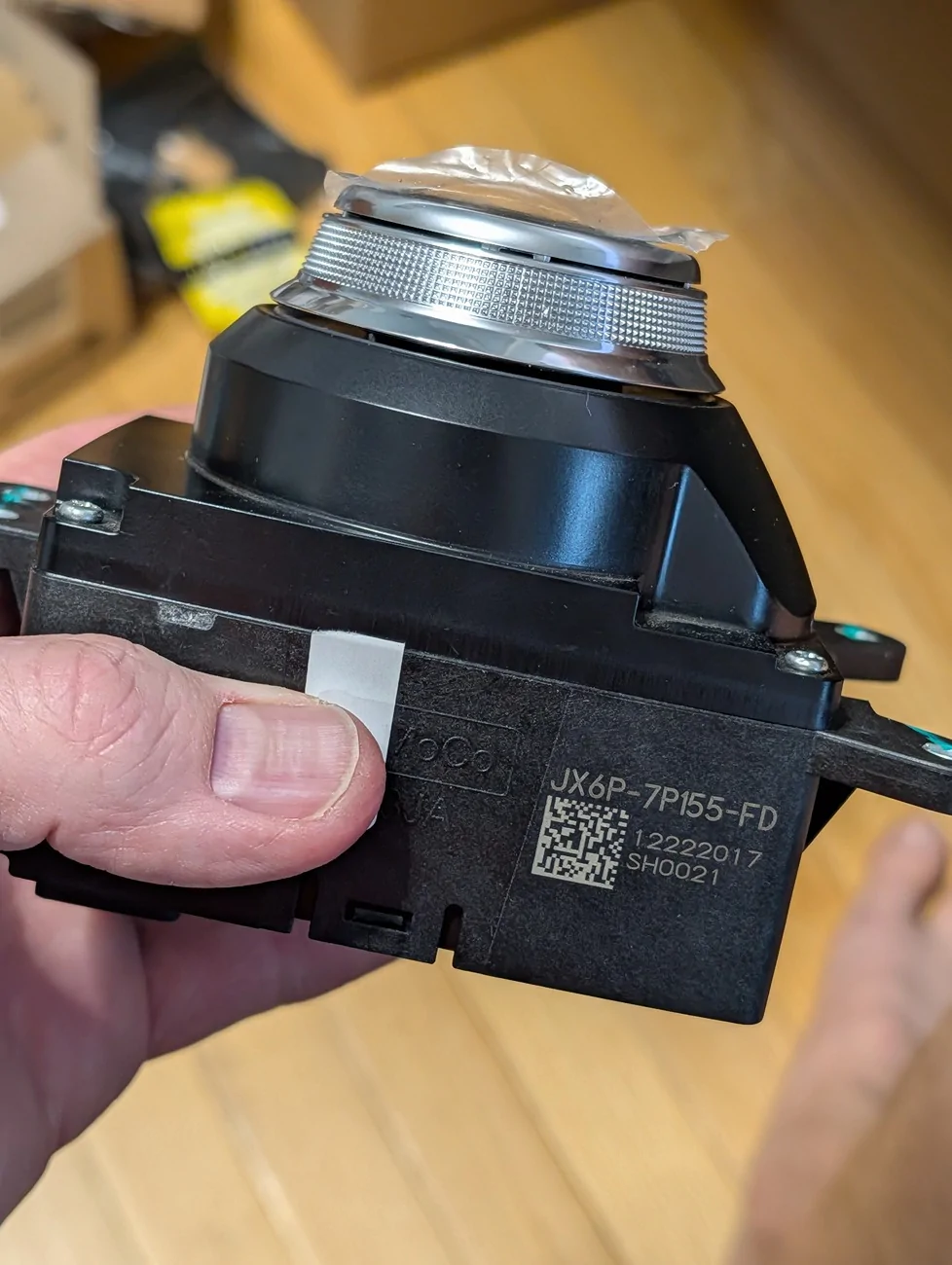

Well, I just received a LX6P-7P155-FD and my '23 Lariat super-rejected it. I had ordered a LX6P-7P155-EH but was sent the FD. Now working on a replacement.

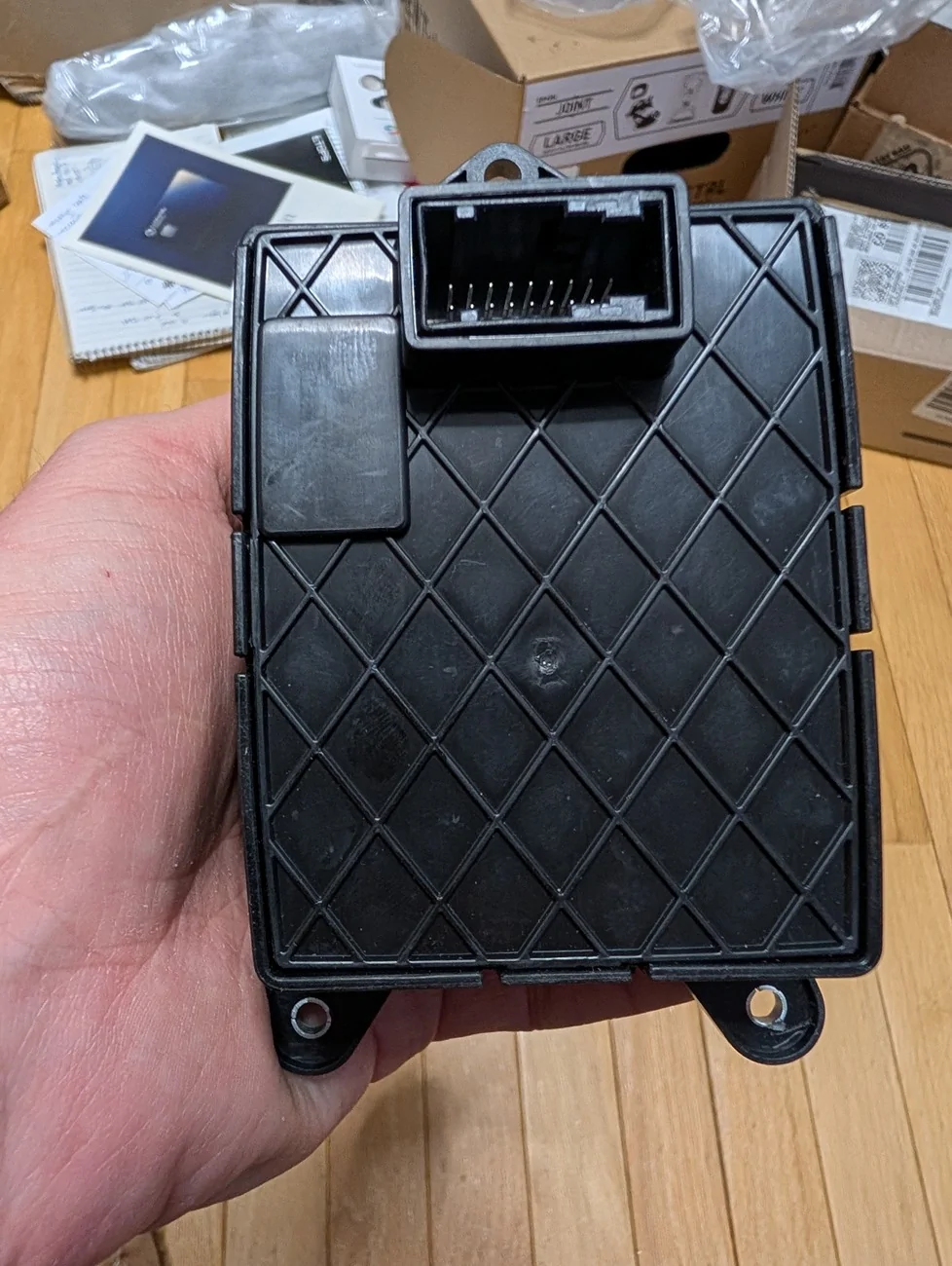

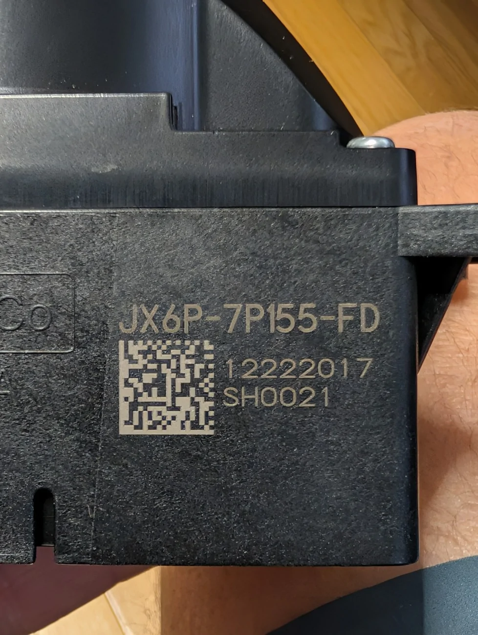

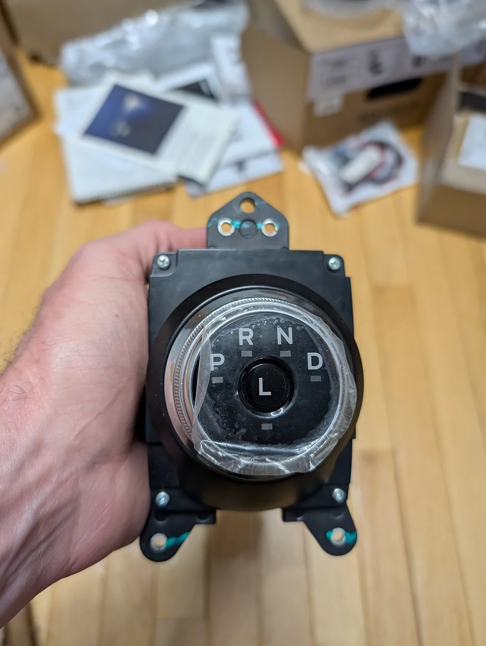

A bunch of "service vehicle now" messages, along with others on the same theme. I plugged the OEM shifter back in and zero messages and the truck ran fine.
Here's some pics of the -FD device. It came from China with no packaging other than in bubble wrap in a plain corrugated box. Kinda looks like new-old-stock.
That is JX6P.
Looks like from a 2018 Focus. If they had it listed as LX6P, I'd ask for a refund.

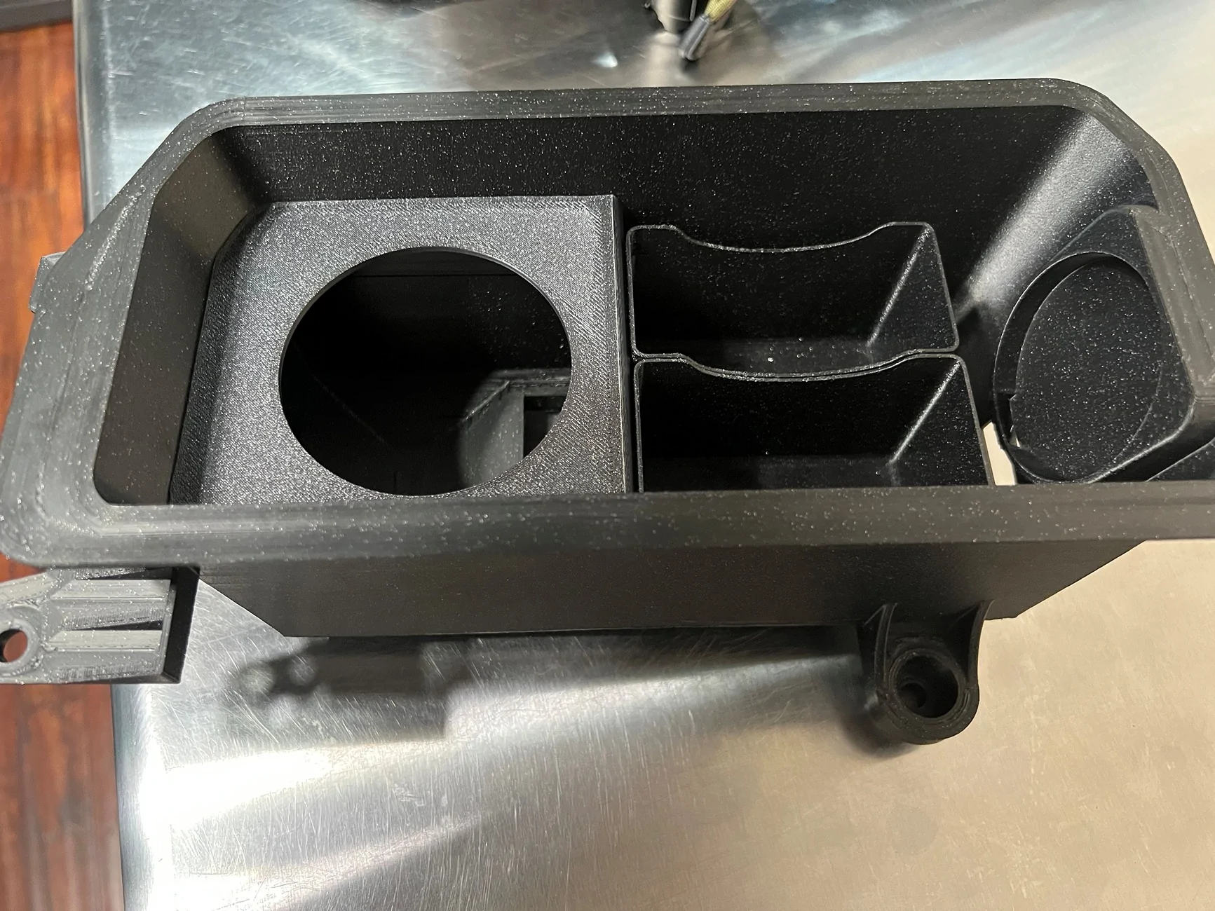

I am in the last stages of printing the thingiverse cubby using Polymaker Polylite galaxy black ASA. The version I'm going for is the gridfinity storage boxes with the magsafe charger in the front wall. I'm reprinting the cover so it doesn't have the build plate pattern on it. I may do a cupholder insert to replace the two small gridfinity boxes. I have an apple magsafe charger that fits nicely in the charger position it just needs about a 2mm spacer behind it to make it flush with the cubby mount. I have not purchased the shifter yet, I'm still trying to sift through the pages and pages of comments about part numbers and installation techniques and try to figure out whether I want to purchase off Ebay or pay the extra money for one from a Ford Dealer.
