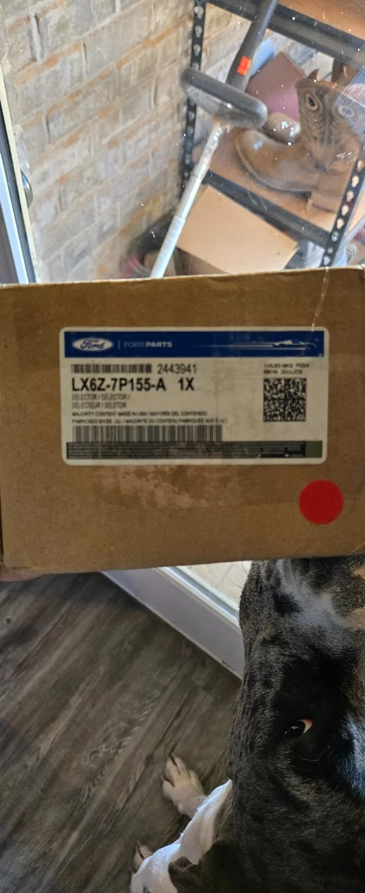

LX6Z-7P155-A is motorized with ambient.

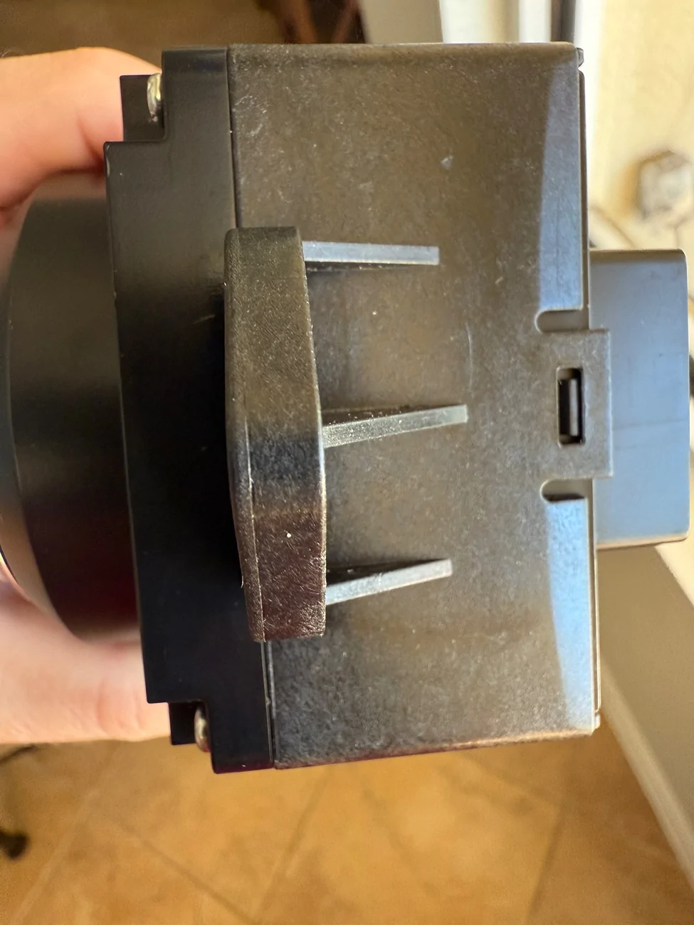

What tabs are you filing off and why?
The mounting tabs, So it will fit in the cubby. I like this design much more than the ones with the mounting holes on the bottom.

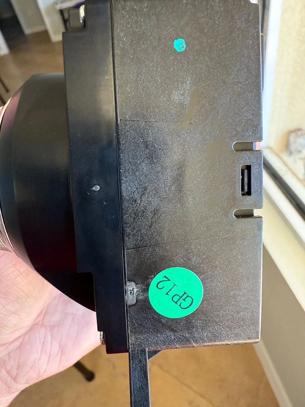

Tried looking for pictures of what you’re explaining but haven’t found any . By mounting tabs do you mean in the truck or on the new parts? Just curious because I would what this reversible if need be .
https://www.f150lightningforum.com/forum/threads/rotary-shifter-part-numbers.29588/post-551503

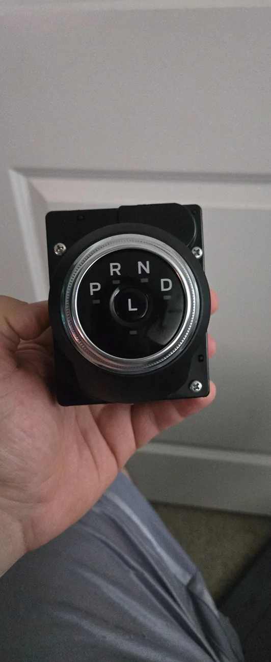

You file the mounting tabs off the rotary shifter and it drops in. It gives you more storage space and I was able to swap it without taking my console apart. It doesnt effect the ability to revert the truck itself back to stock. Only difference is that you end up with a rotary shifter without mounting tabs. I didn't like the idea at first, but tried it anyways and am glad I did.

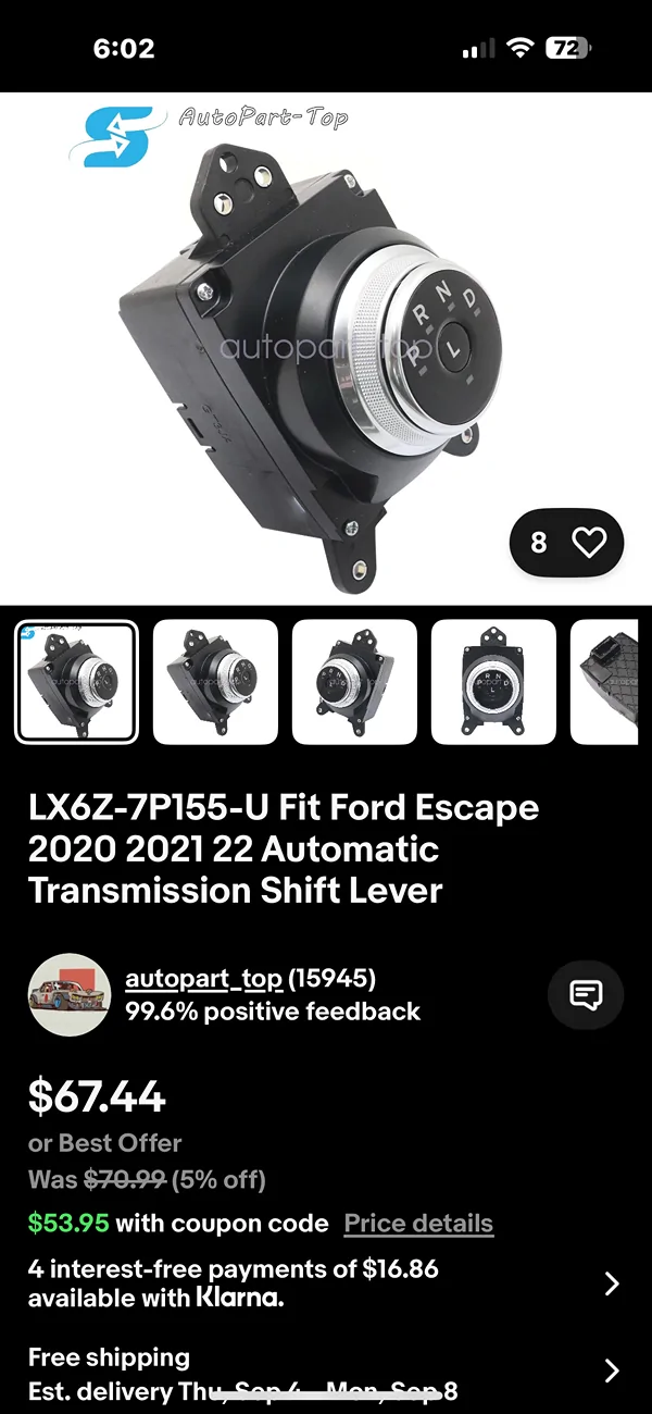

I just received my LX6Z-7P155-U from eBay. What is troubling to me is that I do not see FoMoCo stamped on the part, or the actual part number for that matter. It looks like they have been scratched out.
I am going to attach the eBay listing I purchased from along with an image of the part. Maybe someone can confirm they purchased from the same seller and installed without any issues. I am hesitant to even install it.
I am in the same boat as UncleTony. I feel like I want a motorized dial with an illuminated base/ring. However, I am having some trouble locating that.
I haven’t been able to find a lit base and motorized so I’m just going with the lit base for now.

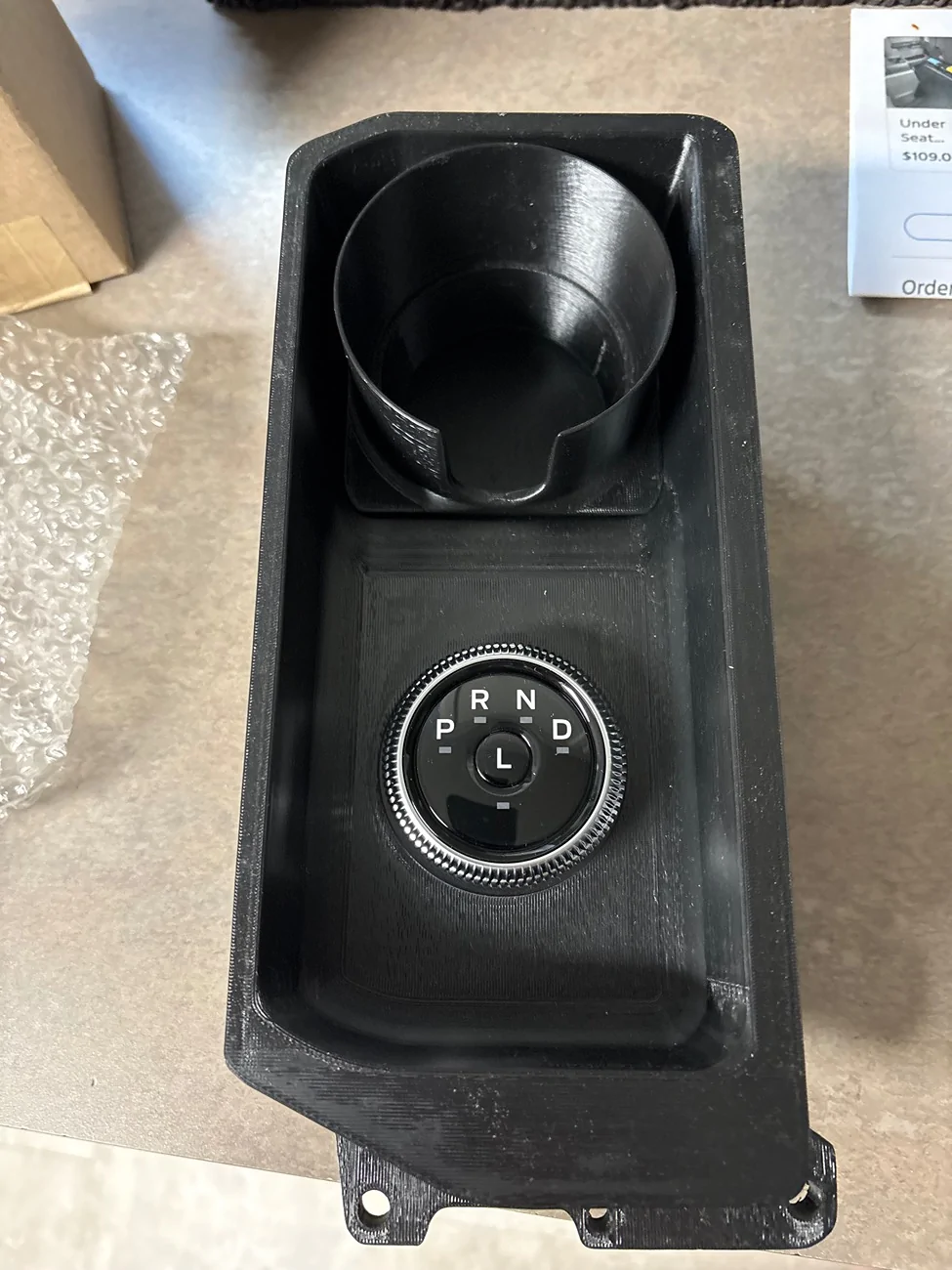

I am able to sell the PZ1P-7P155-AC now if anyone wants it. I can print the cubby for you as well since it doesn't have the mounting tabs. It was brand new a couple months ago. Figure $120 including shipping is fair. (Saves about $40 compared to buying the shifter and $70 for the etsy print).
That is if @opioid doesn't want it.

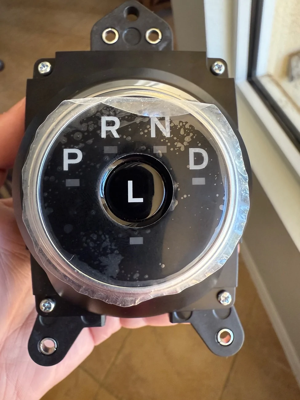

Thank you for explaining . So I don’t have to do this with the one I’m using.

Correct, the shifter should mount on the bottom and use the stock mounting points of the shifter.

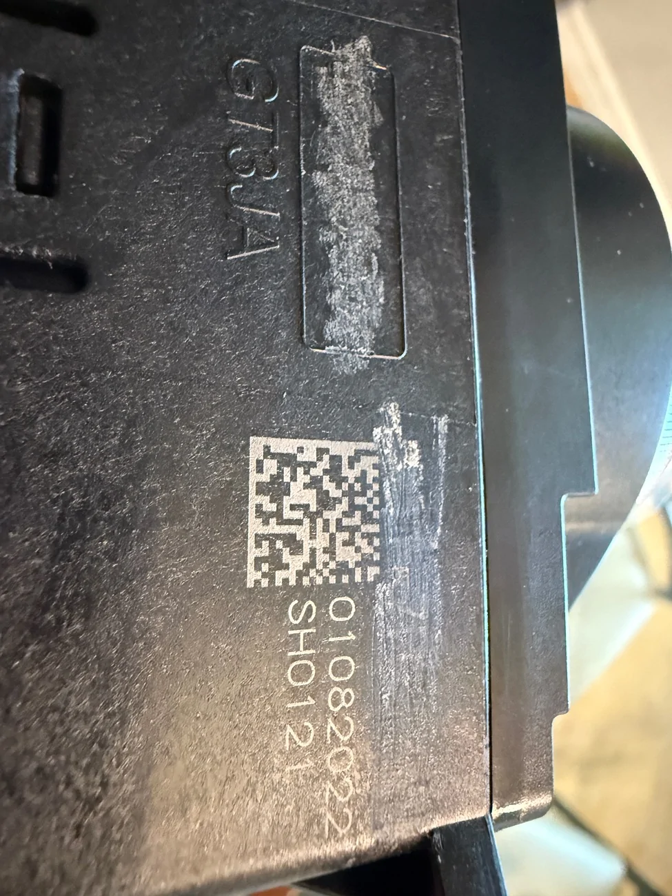

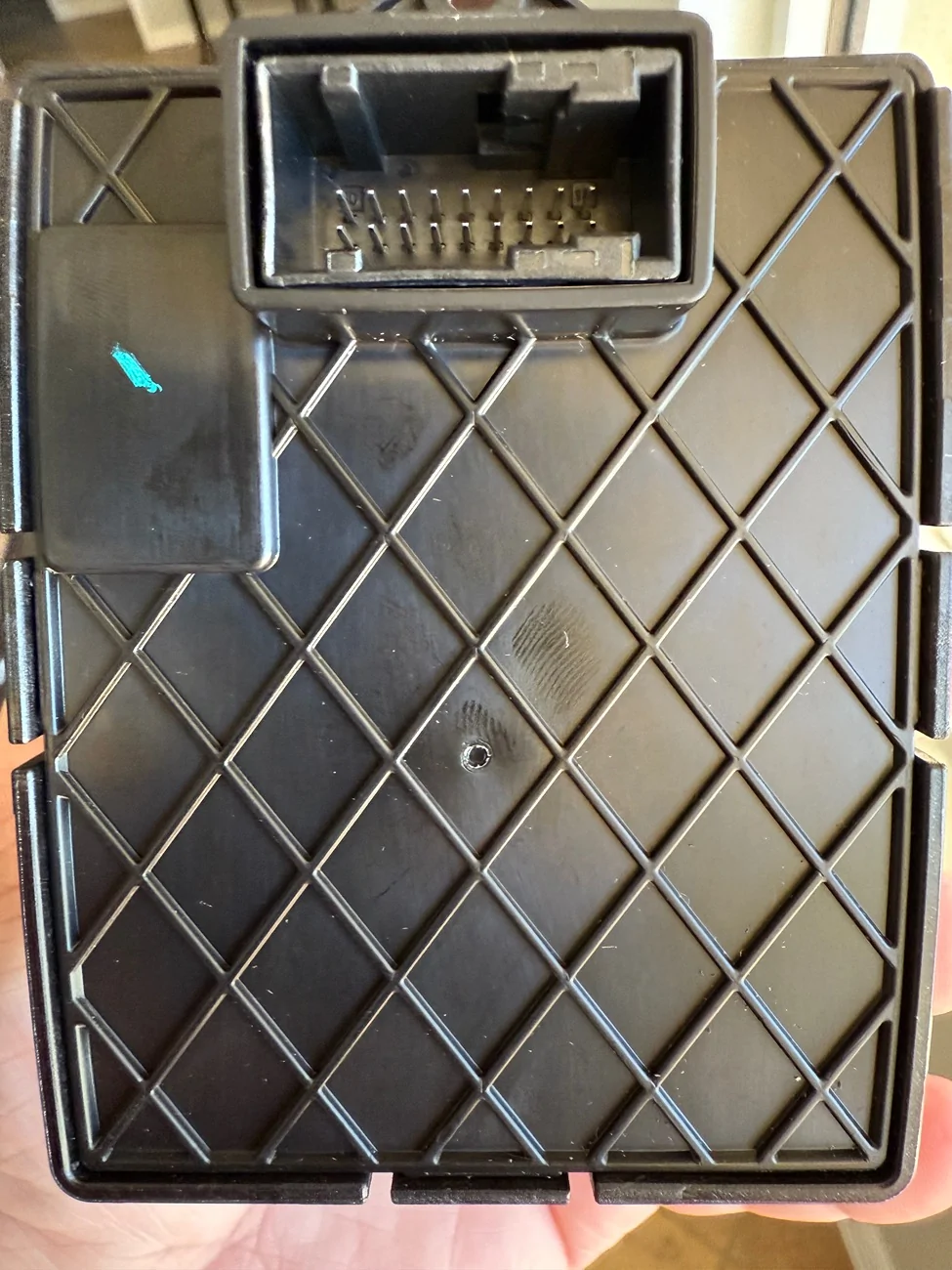

Here are those additional pics of the part I promised. I tried to take them with as much daylight bleeding in to aid in visibility.
if you look real close to the scratched out section, I can make out a Z and P. It shows up better on the first picture I posted.
I think this may be motorized. Between the two I have (One motorized and one not) yours looks like the motorized version - 4 screws on top and the diamond bottom.
For the non-motorized, would the silver ring free spin, or be locked into place when it's not hooked up?
