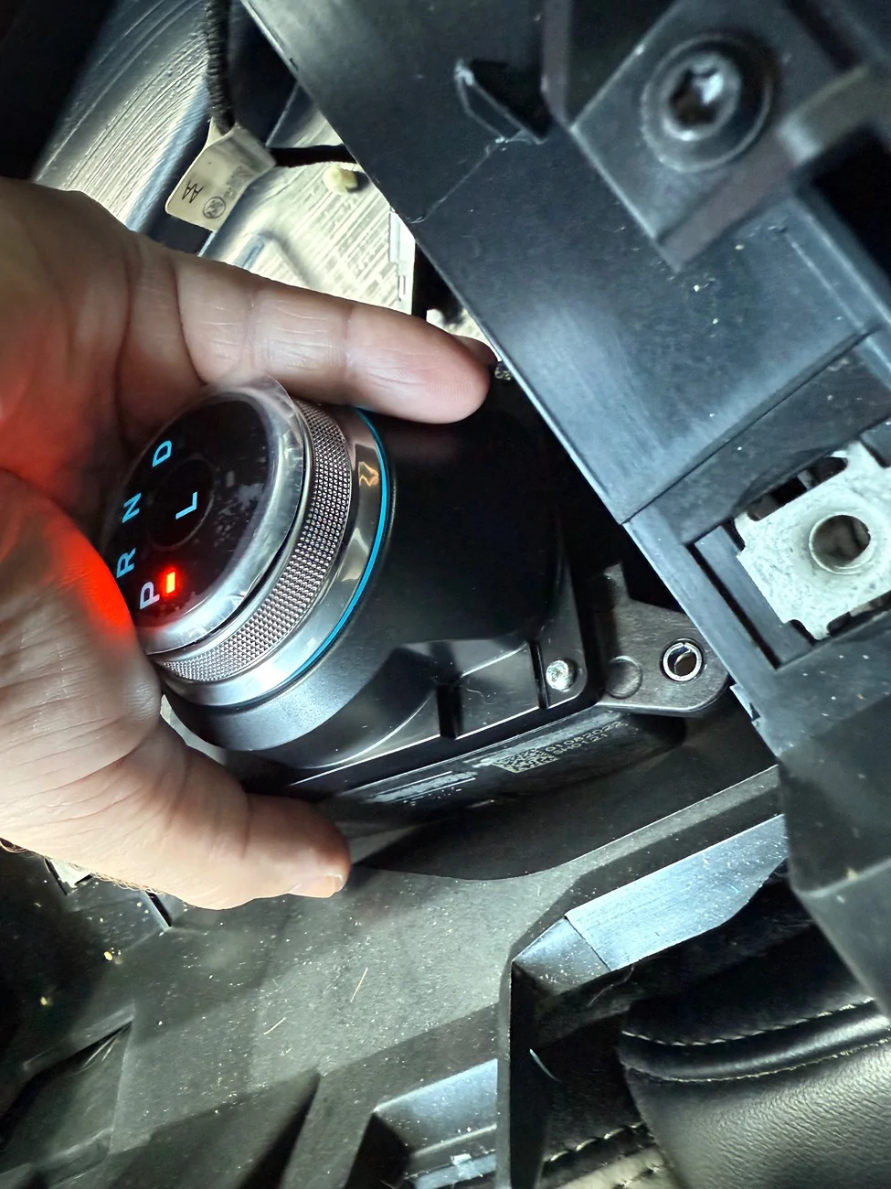

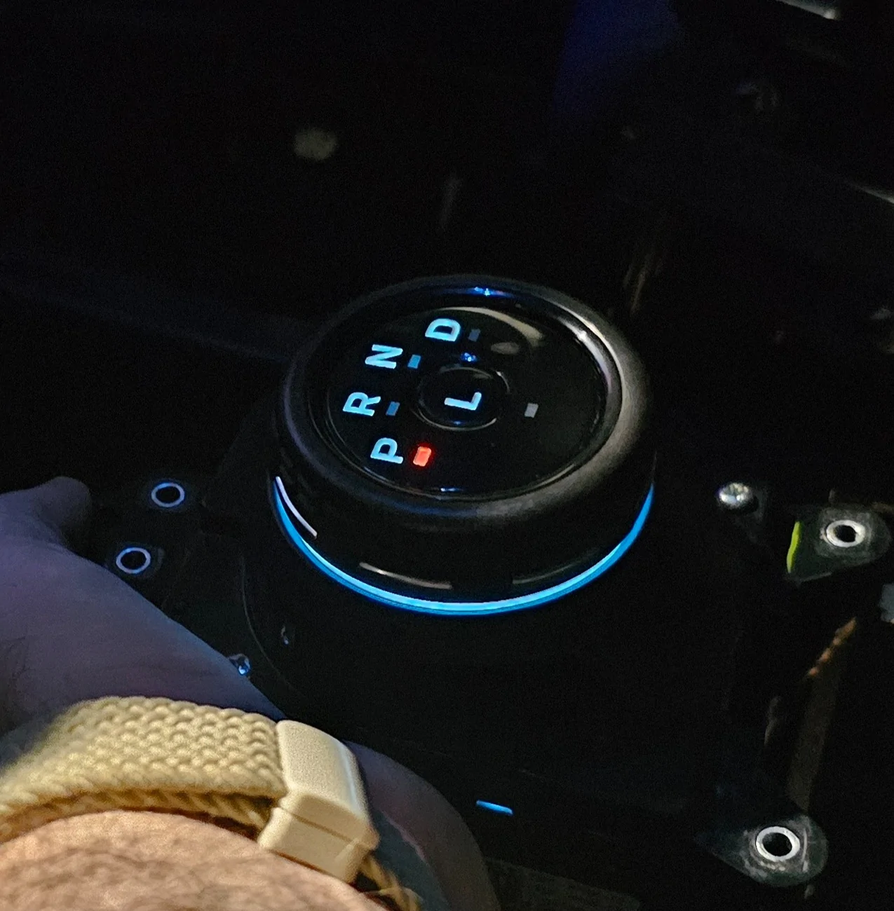

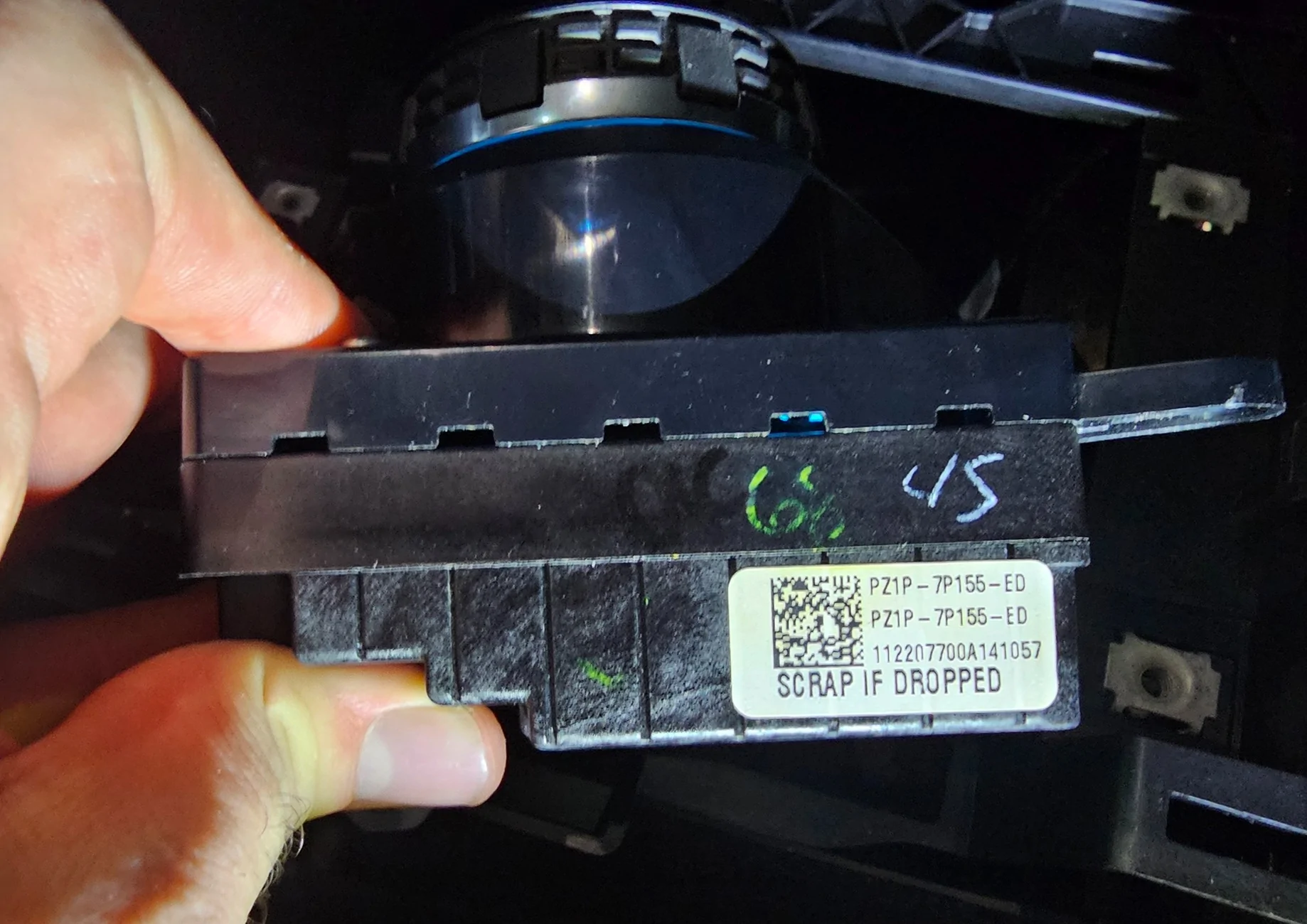

DIEProphezeiung
Charlie
Apr 6, 2024
102
Birmingham
23 Lightning XLT ER
Got a new part number for the list. PZ1P-7P156-ED.
It was plug and play, and came out of a '22 Bronco Sport.
It has a blue ring around the base of the dial.
It is not motorized and electrically shifts back to P when you open the door in D.
"L" button activates N hold.
It will not rotate unless you push the brake.
It will rotate past D and P, but doesn't do anything.
