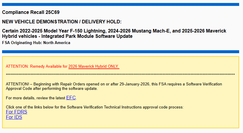

31 Jan 26 and even though the full compliance bulletin has been released for 25C69 (parking module update)...the actual software remedy is only available for the 2026 Maverick Hybrid so far.
Ford F-150 Lightning SYNC-25.2.1.6.5.2: SiriusXM Improvements 25C69_full_bul_released

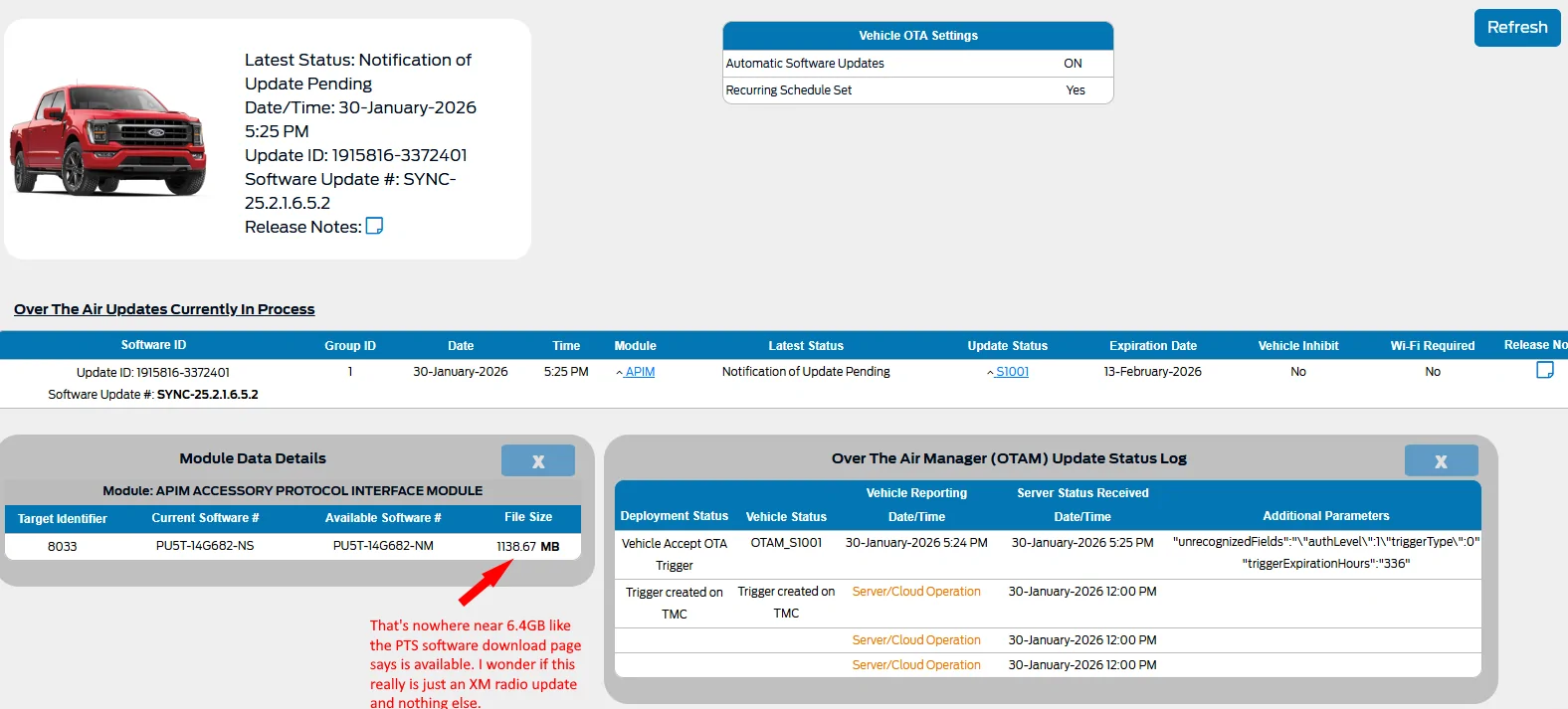

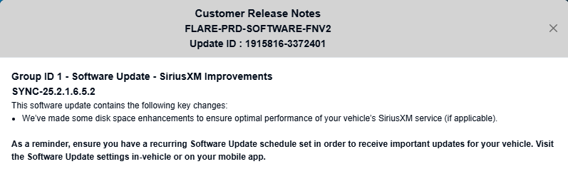

In other news, my '22 Lightning VIN shows that I have a new 6.4GB APIM update as of this morning (wasn't there yesterday). Oh, and I just noticed that I also have a pending OTA for that same APIM update ( SYNC-25.2.1.6.5.2 )...jeez...I would hope that a 6.4GB APIM update would address more than just "XM Radio Improvements"...but that's all the note says....wow.
Ford F-150 Lightning SYNC-25.2.1.6.5.2: SiriusXM Improvements Sync_25-2-1-6-5-2
I got that SYNC-25.2.1.6.5.2 OTA yesterday while driving. Same XM notes. I haven’t dug around much to see if anything else changed.

Getting a bit further into it...
Ford F-150 Lightning SYNC-25.2.1.6.5.2: SiriusXM Improvements APIM_OTA_Pending_31_Jan_26

Time to take it for a short drive or let it sit running where you have good AT&T coverage. Probably easier than getting out the FDRS setup.
