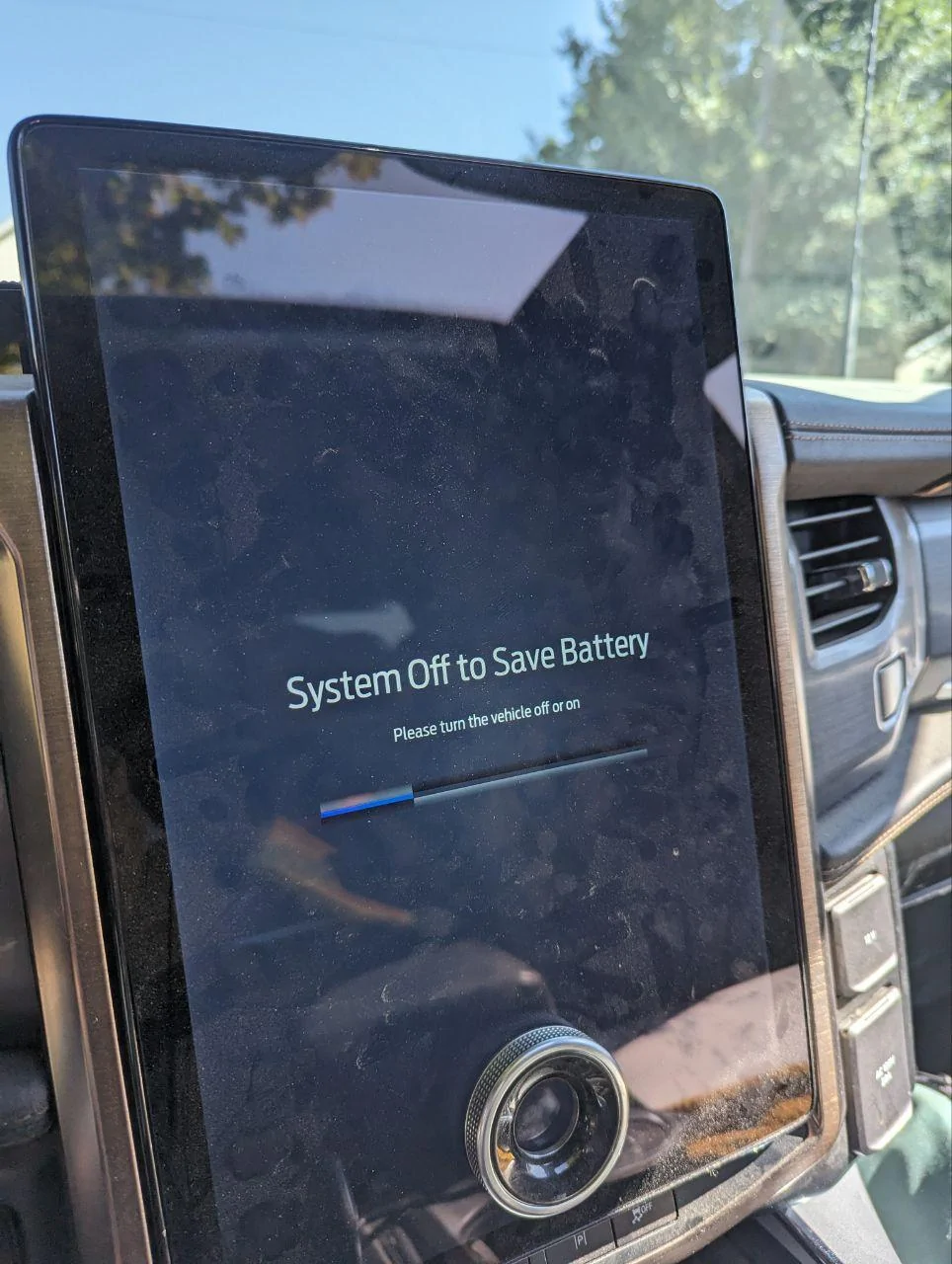

Anyone suddenly get this alert? Always after I turn off vehicle, before I open door to exit.
Lasted a few days and now it's gone!?

It happens when the 12v battery is at a certain voltage / state of charge. For me when in this situtation, also the phone-as-a-key unlocking only works on the driver side.
I've noticed the 12v can get low enough to get in to this situation but not low enough that the truck charges it from the HV battery (it has to be pretty low for that to happen), or that it doesn't charge it enough.
I've charged my 12v battery manually and haven't had this situation in a while.

Theory: the truck was in accessory mode (start button on without pressing the brake pedal) for an extended period of time which drained the low voltage battery (LVB). Driving the truck charged it up and it's fine now.
Accessory mode uses only the LVB. However, when the truck is on it is charging the LVB even when not driving. You can charge your battery by turning your truck on and turning "walk away count-down timer" off.

Since learning how the 12v battery charges/discharges, I never use Accessory mode - there is no need. Simply turn the truck on and no problems. Benefit - Air conditioning.
Would be good if Ford would tweak the parameters to charge the 12v battery from HVB before it gets low enough to throw warnings. It's not like we don't have enough power in the truck ;-)

Just got my truck back from the dealer for the CSP-23B57 for High Voltage Battery Notice. Module was not changed but software was updated. Now getting this error. Also noticed steering wheel heater was not working when it had been working fine till now. As others have noted, truck no longer "wakes up" upon approach and the screens and cabin lights do not activate until I push the start button.
I'm going to do a charge cycle and perhaps put my trickle charger on the LVB. If that does not clear things, I guess I'll be going back to the dealer.

I charged to 80%, then put the trickle charger on the LVB which showed 100% charge after only a few minutes. So clearly a low LVB was not the issue. I then followed the reset procedure as described by Mike G in post #1 here. https://www.f150lightningforum.com/...fix-a-problem-bms-learned-values-reset.15900/
Once done, all was well and all worked as expected. Thanks again to the forum members who make this site a valuable source of information
