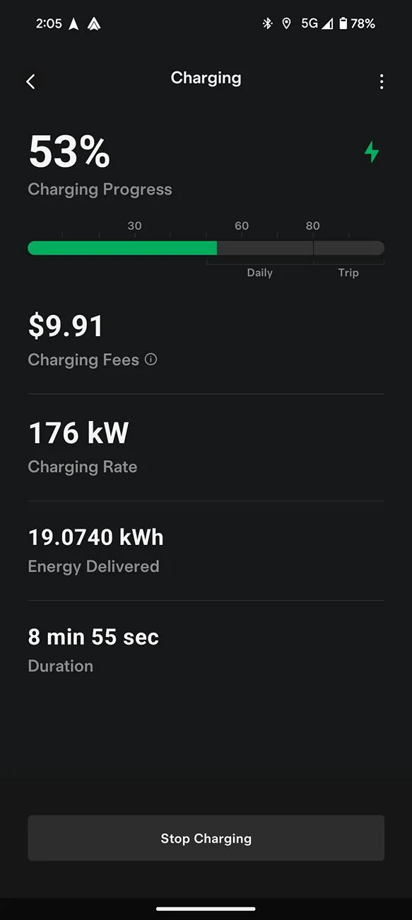

Completely normal. I’ve gotten 180 I’ve seen some at 190. It will pull that for a few minutes then go down as the SOC gets higher.
Ford F-150 Lightning Tesla charging giving 175kwh IMG_1256

This past weekend charging at a Supercharger in 25F weather with the truck preconditioning prior to charging...normal.
Ford F-150 Lightning Tesla charging giving 175kwh 1000000598

That is identical to my scenario right down to the price. Except mine was in Canadian dollars lol.

In it, he describes how Ford implements a "max power boost" (his term) period where the charge rate will go above the usual rating for about 4 to 6 minutes, depending on battery temperature. In the video, it climbs to just above 160 kW.
One benefit of this is that if you find yourself only needing a small top-up to get you to your destination, this can cut your time needed so you can get back on the road. In the video, he shows how this will get you about an extra 30 miles of highway driving with a five minute stop.
