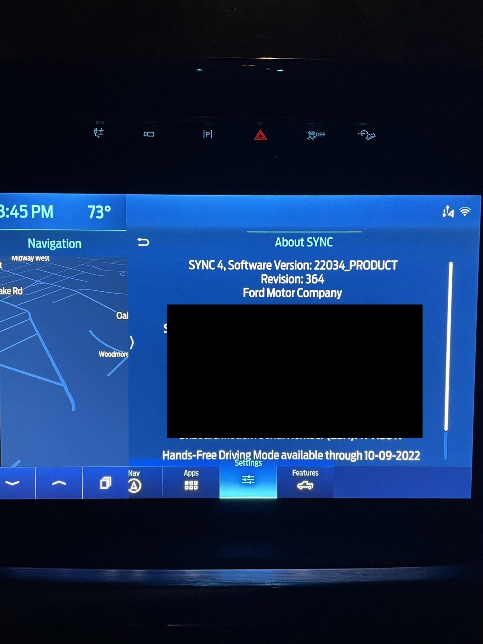

I have an issue where the tiles / cards (whatever they're called) moved to the left side of the screen after recently getting sync 2.3.0. I cannot get it to move back to the right, and it's covering up the other screens and the bottom row. Anyone else run into this issue? I tried soft and master resetting sync, and nothing gets it back.

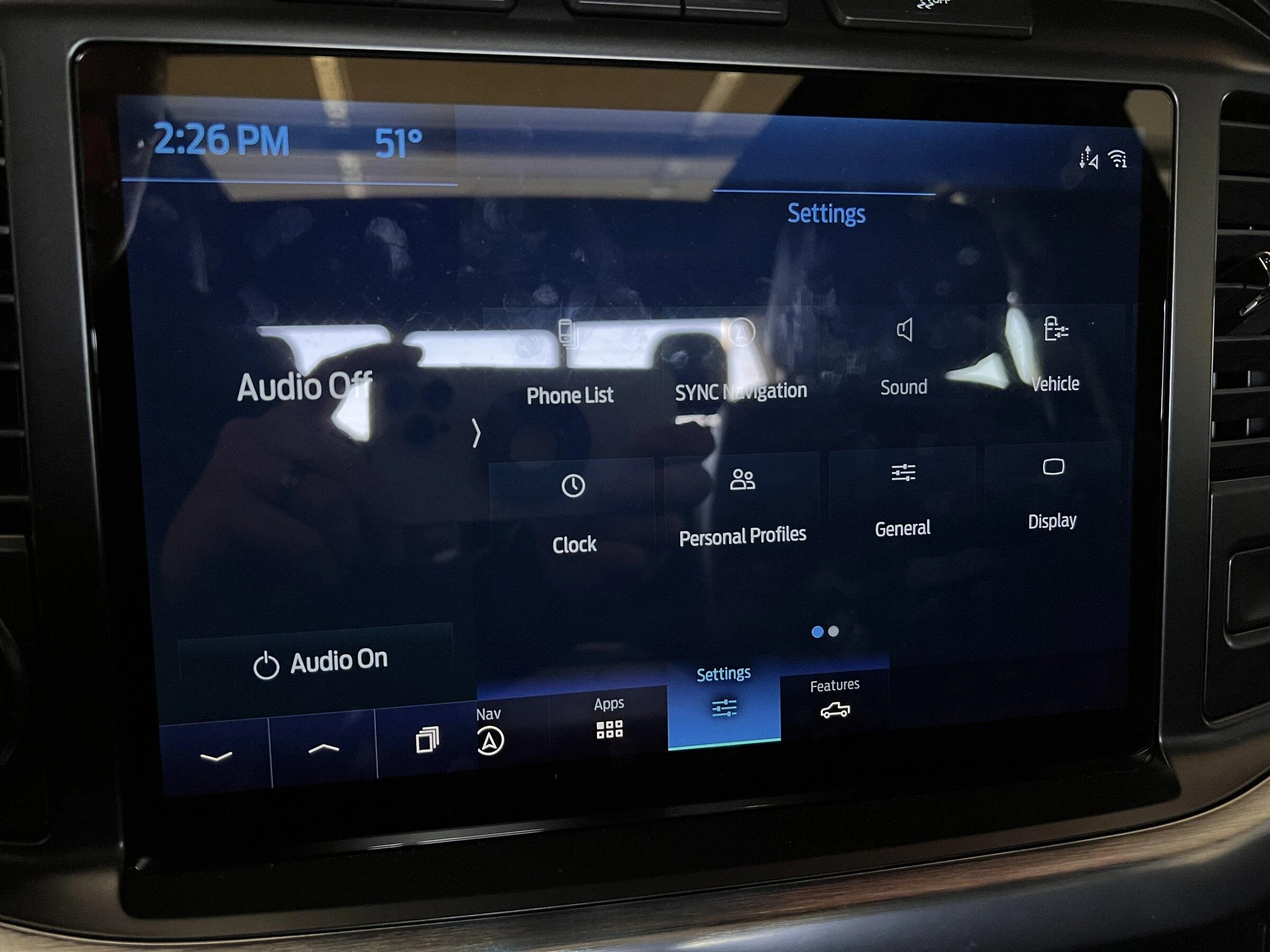

Well, got a whole new stereo and APIM put in. And it’s still not fixed!! I am livid and very confused on what the problem is and where to go next. They’re going to talk to an engineer again, but this is crazy.

That’s crazy. I wonder if your “as-built” file is wrong, and they keep loading the wrong codes?? Seems like they have the wrong display size and right hand drive instead of left.

That’s my assumption. The tech made a comment like it’s setup to drive in EU countries. I know it’s all new to dealers, so I’m trying to be patient with everything. They’re having to fly in an Engineer to try and fix everything using some special computer and process the tech supposedly cannot do.

I worked with freeman Jr. I tried everything I could think of. I have his vin and his as build is fine. I even had him change 03-01 the sceen layout bit. I had him change it and then change it back to try and force it. I had him pull the fuse to the APIM overnight. I had him do resets and PMI. I tried everything. If you replaced the APIM and its still like this then the issue is the update files that are being called for.
There was a guy a while back that had a 12: and he was updating. They sent him the 8" files for his truck. It did away with the side card in total and just blew everything up to the 12" He was lucky and a PMI resolved his situation. He was able to do the PMI and Ford saw the wrong files and sent the correct ones. He had already bought a replacement APIM.
I would like to ask the dealer that since it is still the same way after the APIM replacment when the new apim went in was it ok until the PMI was completed or did it go to this straight away. If so then the issue could possibly be the screen.
