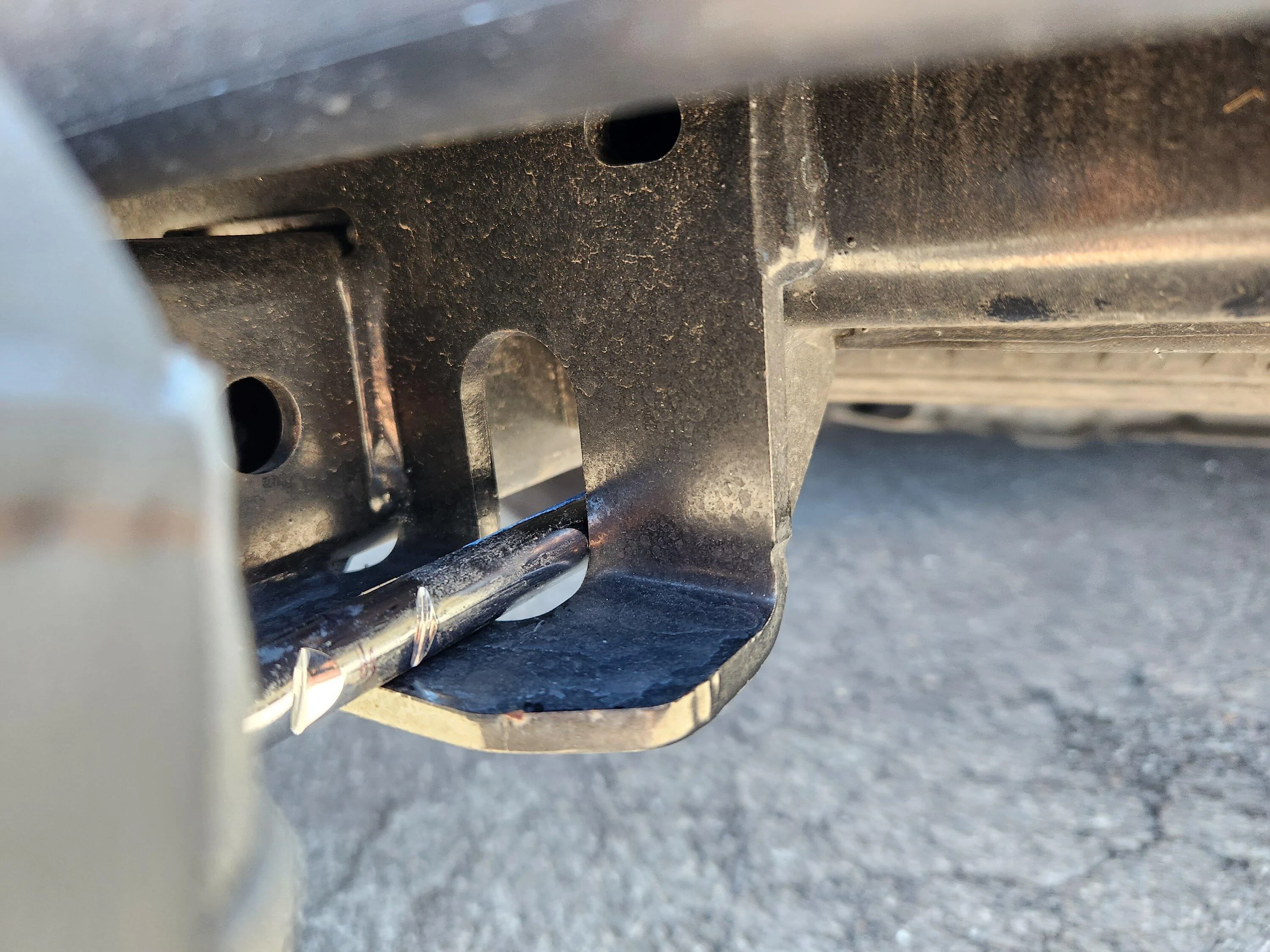

Bending the headrest, which is an integral part of crash protection, is a really poor idea.

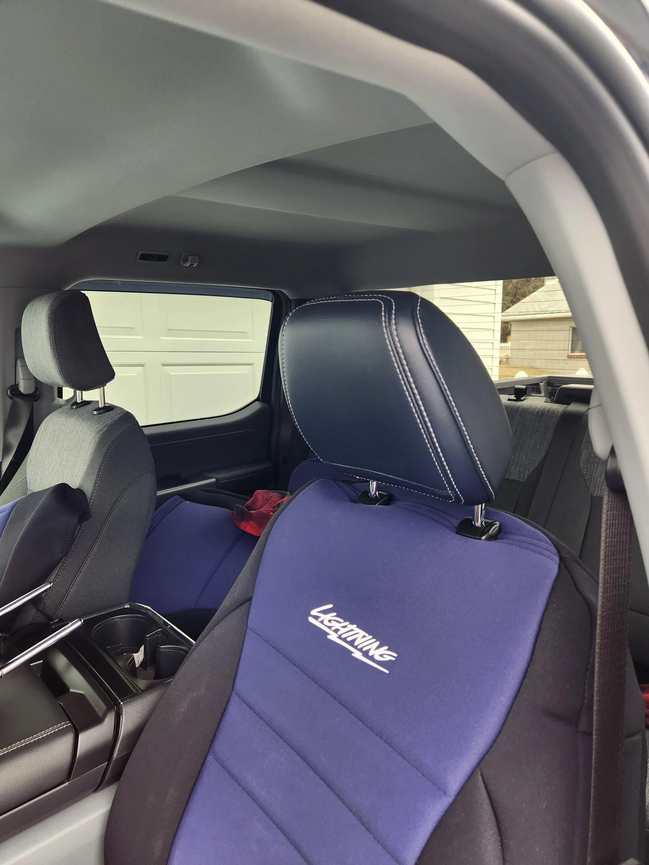

Been lurking on this thread... While installing seat covers on the Lightning today it occurred to me that the Lightning front headrests are similar to the tilting headrests on the 2021 Bronco... Confirmed!!! 2021 Bronco FE 2 door tilting headrests fit a 2023 Lightning XLT, no mods, drops right in. The detent notches on the posts are a little different but it all works fine.

/\Nice find.
I flipped my headrest around and reinserted. It's not perfect, but not horrible like the forward standard option.

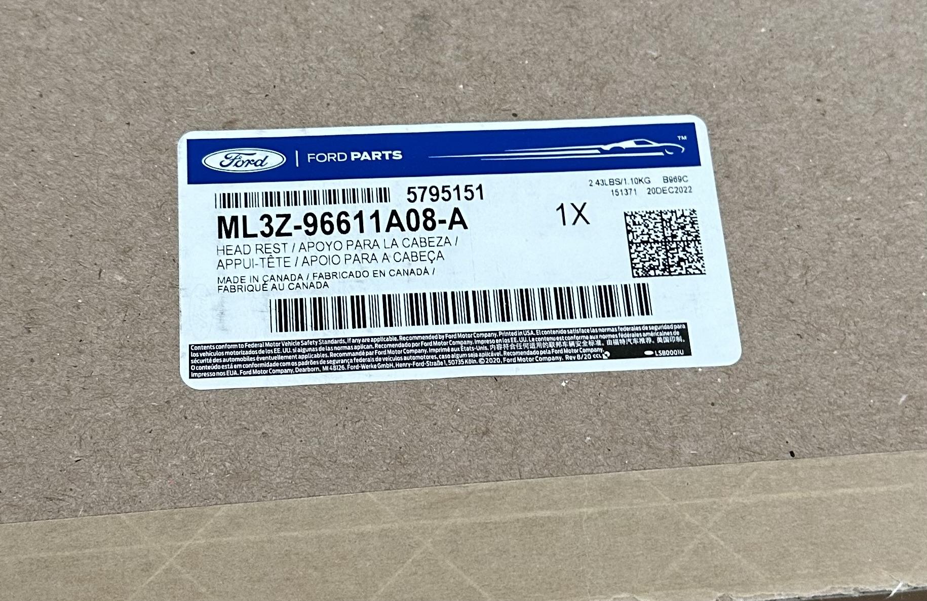

Did some searching, and read in another forum that this part number works in 2022 F-150s for a tilting headrest: ML3Z-96611A08-A.
I found the headrest here for $90 plus shipping. It says:
Fits F-150, F-150 Lightning
CAPTAIN CHAIR, W/MEMORY. CAPTAIN CHAIR, W/O MEMORY. MANUAL, VINYL. POWER SEAT, CLOTH & LEATHER TRIMMED. SPLIT BENCH OUTER SEATS, 4 way headrest.
Who wants to order it and see if it works??

It does work. I assume it is the same part @PV2EV ordered. I ordered two of them and the covers transferred over without issue. I personally think they make a huge difference in comfort vs the fixed forward tilt of the stock headrests.

ML3Z-96611A08-B is what I ordered.
Upright it is a few inches rearward of the standard headrest, but less than I wanted. I am now used to it. With three more adjustments forward, it will be far forward of the standard headrest.
I transferred the cover myself. It is tight, so be careful you don't tear a seam.

Haha, fixed the problem today for my truck. Stuck the headrest in the hitch holes and stood on it. Spent about 5 minutes gently bending it in a few different places. Perfect angle!
Put down a clean rag on headrest first...

Just picked up mine today, $99.59 each. When I ordered them a few days ago (after testing one from a Platinum in our truck), the PDR guy was there. He popped a dent from my driver's door for $40 in about 6 minutes. Bollard at a charging station 18 months ago. Made the stop at the dealership worthwhile.
