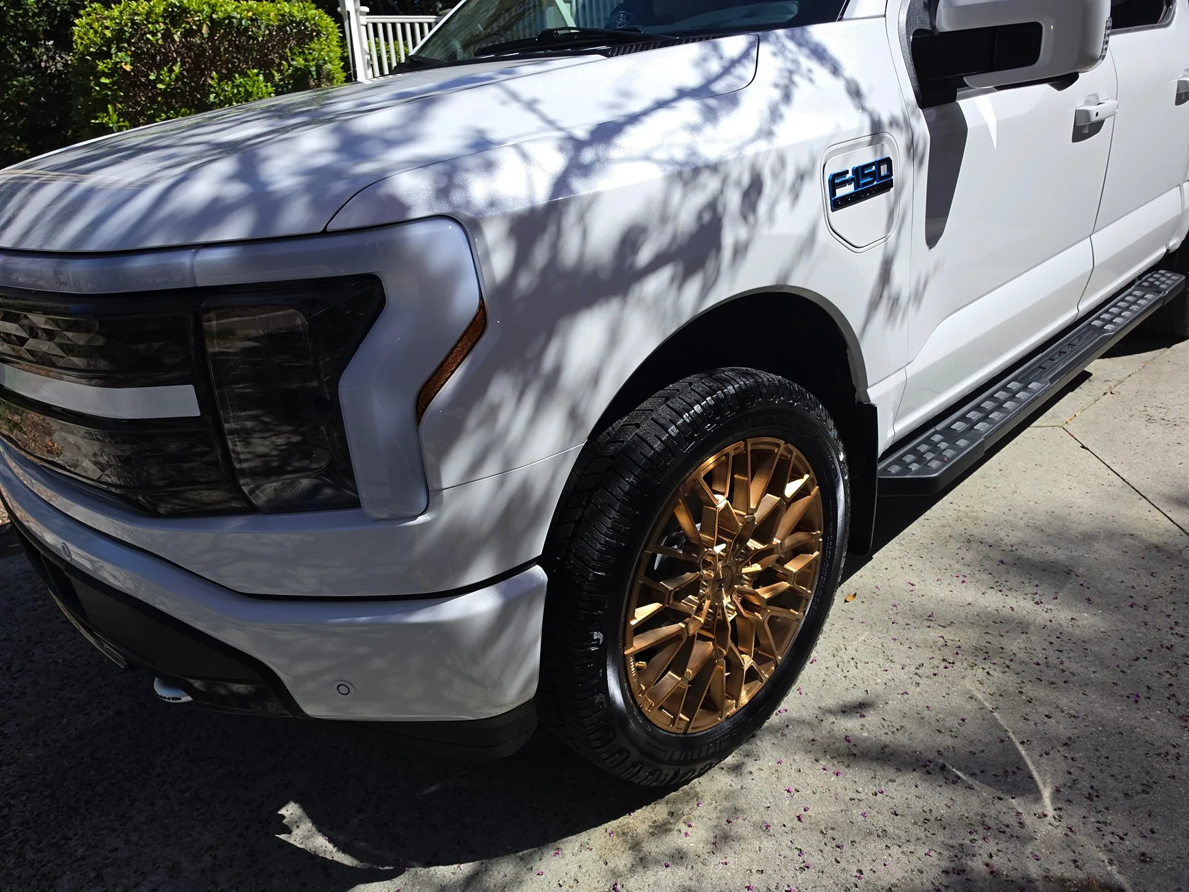

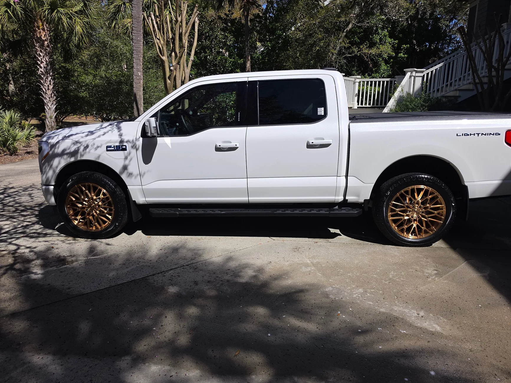

I have both a 2023 Lariate with 20 Inch OEM wheels and tires and a new 2025 Platinum with 22 inch wheels and Michelin Defender 22" tires. I swapped out the tires on the 22 Lariat with the Platinum tires and noticed a decrease in range of approximately 15-20%. At 90% charge on the 25 Platinum I noticed the range to be approximately 285.
2023 Lariat with OEM wheels and tires (20") was normally 320 at 90% it is now 290 at 90%. Reading up on the effect of weight at each tire I should have expected this to happen. Has anyone come across a set of 22" wheels and corresponding tires that are light enough and LT (light truck) rated that approximate the 20" tire range?

Not sure what the offset on those wheels are, if they protrude much more than OEM, but I notice a 5-10% drop in efficiency when going from OEM Lariat to OEM (non-aero) 22s and my 22s are Heavy!, like 75-80lbs.
So I think you're looking at other things than just weight with your setup.

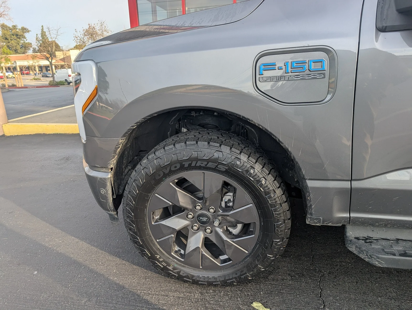

I can't comment on wheels because I kept my OEM wheels, but I replaced the grabbers with these Toyo Open Country AT3 EV tires and haven't noticed a measurable difference in range compared to the stock tires. Tirerack link. It's nice that they also look way better than the grabber tires.

The stock tires are not LT rated so I'd say so. Every tire is different though so look at the actual weight ratings and compare to the OEM tires before slapping a set on. I went with a set of goodyear electric drive AT's in a 275/65r20 (non LT) and have been very happy with them.

the OEM 22" Platinum wheels are very heavy. do you know how much those gold aftermarket wheels you have there weigh? They look cool but what do they weigh? is the OEM 22" setup and the aftermarket 22" setup the same weight?
For road cars, reducing weight is one of the most effective ways to improve efficiency, as every extra 55 pounds (25kg) can increase fuel consumption by roughly 1%. Weight ranks above the #2 most important factor, aerodynamics.
The only way to cut unsprung weight without compromising wheel strength is by going with a forged aluminum wheel, and at 22" it gets expensive. I suspect the 20" is the sweet spot between looks/weight/efficiency but I won't be able to measure it until later in the summer.

I know the tires are 53 lbs each approx 14 lbs heavier than the MOM'S. I assume the gold wheels are roughly 10 lbs heavier. So Im ~25lbs per corner heavier or 100 lbs overall. Im site this accounts for a noticeable reduction in range.
Going forward, Ill either get another set of wheels/tires that are #1 more aerodynamic #2 lighter. Since I only have 5,000 miles on the '25 I'll for sure end up getting a road trip set of rolling tires/wheels and sell these to an F-150 enthusiast.

the OEM wheels are forged aluminum. what make/brand are the gold ones? what material are they?
It is mindblowing to me that the gold ones weigh more than the 22" OEM platinum wheels! with the extra weight of the tires, the total weight of the package seems crazy to me.

The Gold ones are forged Aluminum. Im not sure of the weight as I didn't weigh them when I received them from the supplier. Communications with somebody in Asia is tough as I've asked many times.
I took the OEM wheels and put on my '23 Lariat Lightning. Soon I'll take the LT's off and replace with something lighter and more efficient and will find out.
It wasn't until I noticed the difference in range did I start paying attention to efficiency and learning. Im getting a bit old to think clearly from the onset at 75.
