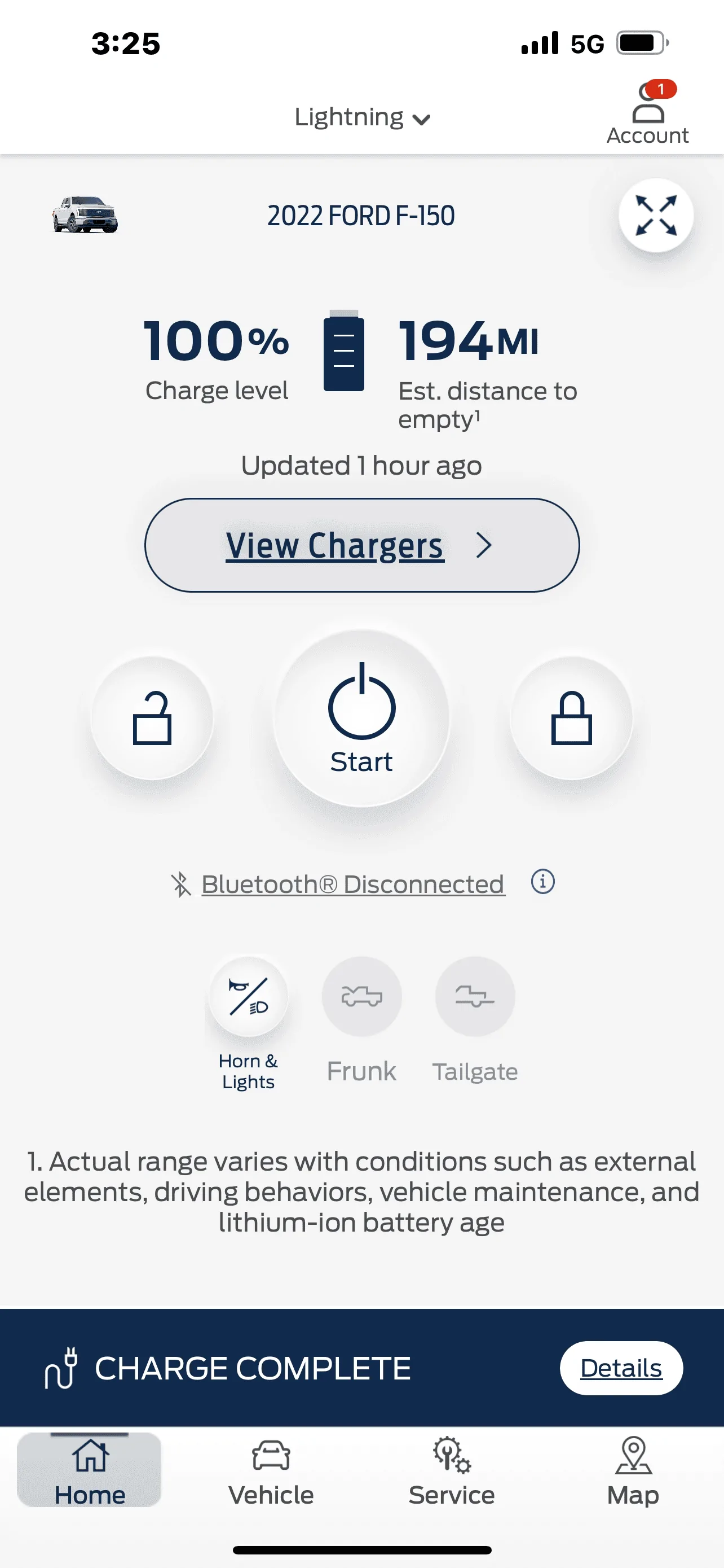

I haven’t seen any savings, we live In Michigan & we barely get 200 miles on a 100% charge. Maybe it’s the way we drive, somewhat aggressive & we like to be comfortable with all the heaters on, a balmy 72 degrees inside the cabin. And yes, that’s with the EB, 131kWh battery.
