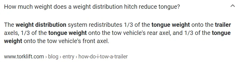

It's also worth understanding how a well set-up WDH displaces load onto both the front axle of the truck *and* the trailer axles i.e. reduces the load on the rear axle of the truck. With that in mind, making sure your WDH is set up to be distributing a little more weight will help if you are otherwise at or perhaps just over the "dead weight" payload. Key measurement here will be to ensure your front fender-ground gap is slightly less with the trailer than without and certainly no more. Don't overdo this but make sure you take full advantage of what the WDH can do :)

Yep, from what I remember reading, it puts about 1/3 of the weight over each "axle" (the trailer counts as one axle only). So you only count 2/3 of the hitch against payload.
Its a bit more complicated than that. When you do a force body diagram the location of the weight determines on which axle the weight is carried and its effect on the torque. Generally the "heavy" part of the WDH is the part that slides into the trucks receiver and is far away from the trailer axle, closer to the truck rear axle. Think about why your propane tanks and battery effect tongue weight so much (close to truck far away from trailer axle). So yes some weight from the WDH will be carried by the trailer axle but it will be a small amount.
One thing that is interested is in J2807 the weight of the WDH does not effect max hitch weight. In other words if you hitch is rated for a 500 pounds hitch weight and you have a 50 pounds trailer hitch that doesn't mean that you can only have a 450 pounds tongue. In other words the weight of the hitch doesn't factor into the max rating on the receiver (at least that is my interpretation of it). The hitch weight does have to be included in all payload calculations though as you cant exceed GVWR and yes with the WDH hooked up your 100 pound hitch might have 5-10 pounds being carried by the trailer axle but it shouldn't be enough to make a huge difference.
I did ace statics in college and I know the spring bars create a moment at the hitch but no way am I gonna do any kind of math to get the real value. I had just googled it in the past and it stuck in my head as a rule of thumb. It will definitely vary but I figure this can't be that far off

The part about the hitch weight is very good to know too!
