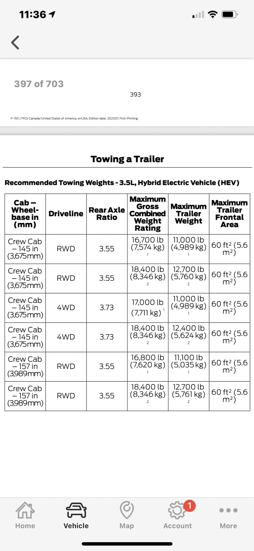

@solarity
I found this in my user manual. I see 11k being the lowest.
Ford F-150 Lightning Towing Specs Consolidated Document - Bumper vs. Class IV vs. Tow vs. Max Tow - UPDATED DOC v4 4990198B-A992-408C-B13F-351241D0EE66
Next page it continues and gives you this: medium duty is a class IV hitch, heavy duty is “trailer tow package” and max duty is “max trailer tow package”
With the powerboost, it’s 5,000 on the bumper, 7,000 with class IV hitch, then your tow/max tow as noted based on your configuration.
