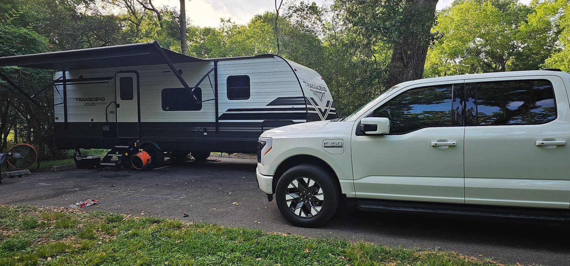

Update on my Memorial day trailer pull / camping trip.
I left my house with 100 SOC . 330ish miles on the GOM . My transcend 240ml comes in 6400 pounds dry and 7500 GVWR. i always like to pull it dry as we try to stuff as much food and stuff in the camper and coolers with beer (very essential ) into the bed. 62 miles one way light headwind from the south and i ended up .09 MPK both directions and 45 miles left in the tank. I forgot to document it as i was super excited to get everything set up and get some frosty beverages down.
I would like to add that even though it said 330 ish miles as soon as i dialed the camper in the GOM went down to around 155 miles, concerning but i wasn't too worried i knew i could make it there i was just worried about the charging. Being a state park with 50 and 30 amp service poles, i was able to use the ford mobile charger on the 50 amp was back up to 90% by midnight, so no issues with that. all in all was a great 4 days although we did run out of beer. ..... a couple of times ....

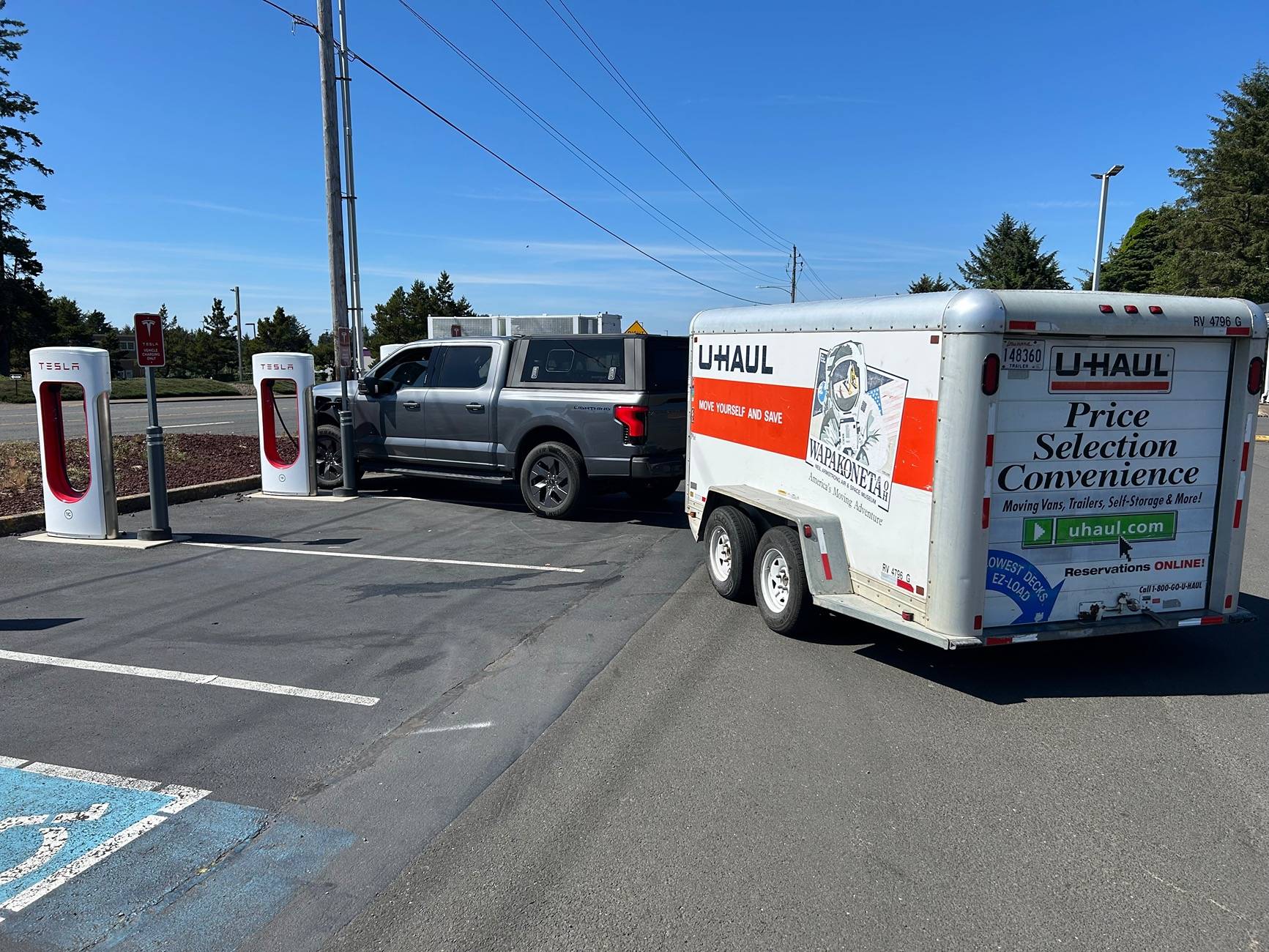

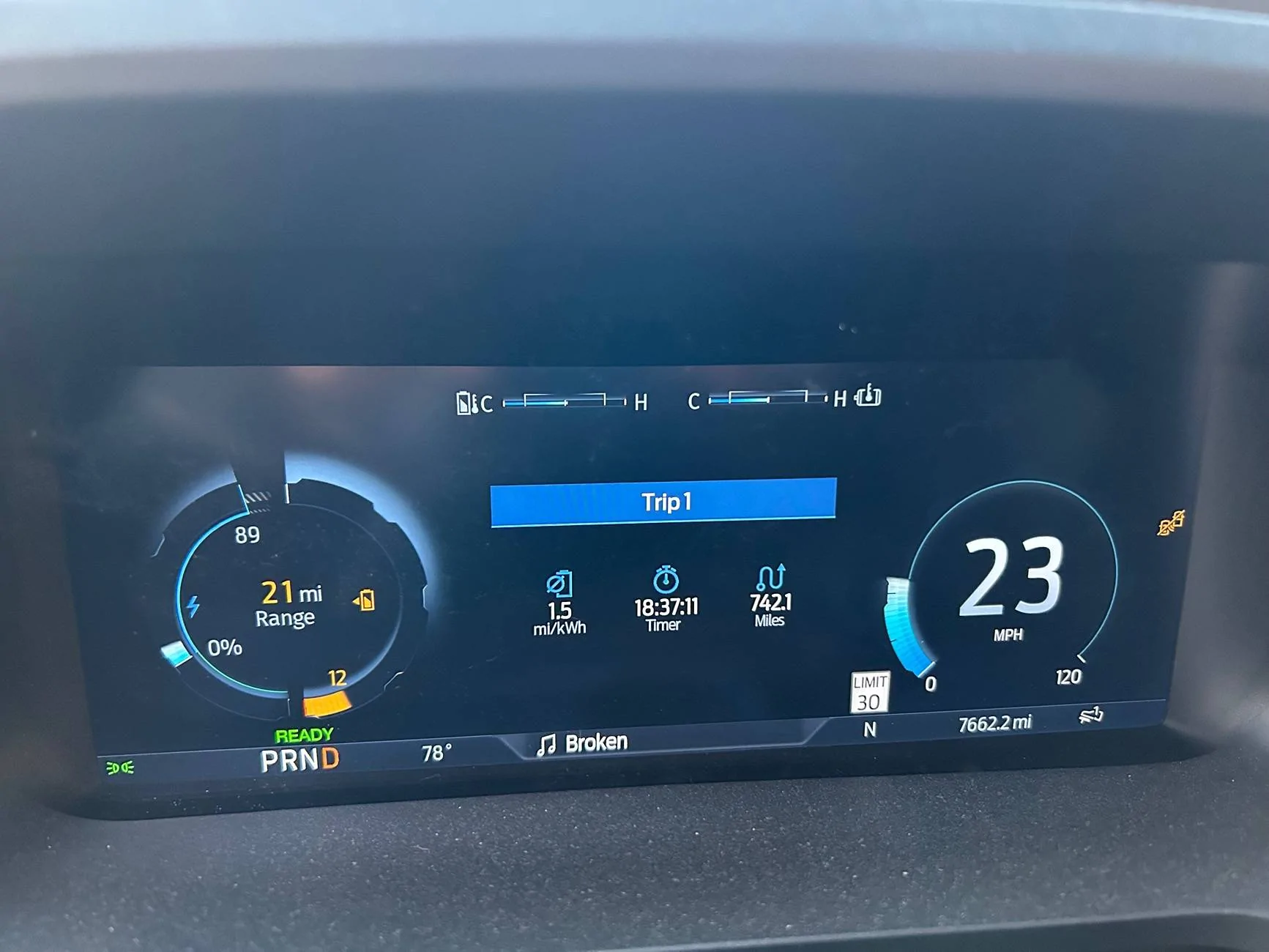

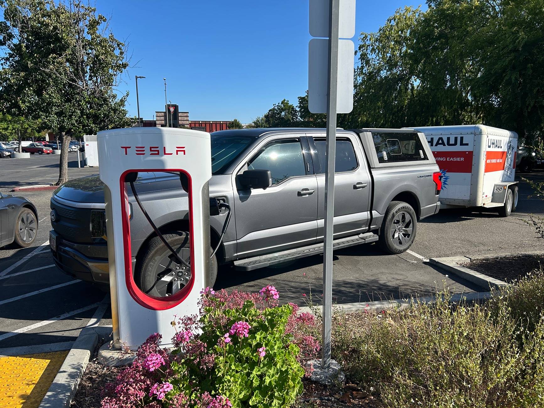

Many thanks to all here and other posted about pulling weight. With your learning and ABRP (with paid subscription), I felt very confident in my first test with my ‘24 Flash ER. I drove from NW OR to San Jose to load and haul my sister’s belongings to OR. Bed was packed as tight as possible, and 6x12 U-Haul trailer fully loaded. I estimate at least 4,000 lbs GVW, maybe 500 in the bed. Estimated conservatively 0.9 for ABRP planning, ended up getting avg 1.5 over 745 miles. Just stuck it on 55 and left it there, drove the 101 rather than I5 (liking interstate highways less and less). Charging at various CCS plus a few Teslas was excellent.
