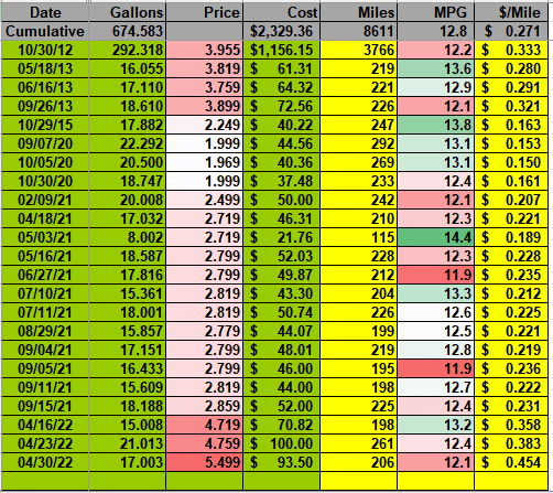

I looking at my towing log for my 2012 F250 with a 6.7L Powerstroke.
Cumulative MPG is 15.2 over 9+ years
Non-Trailering MPG is 15.8
Trailering only trips MPG is 12.8
I'm getting 81% or losing 19% while pulling the trailer with a pretty consistent load.
Ford F-150 Lightning Towing Test: How Far Can The Ford F-150 Lightning Tow a Trailer? [EV Buyers Guide] 1653148958064
The trailer is a 7' by 14' box with a V-nose, dual axle, I'd love to see the Lightning do as well, but cautiously planning a 50% cut until I have actual data.
My targeted charging location mid trip on race day is a very large Walmart lot that I can kitty-corner the truck and trailer into during the VERY early morning charging stop, I don't expect too much congestion.
note the 10/30/2012 event was a cross country road trip with many legs & fueling stops, repeating that with the Lightning would be challenging
