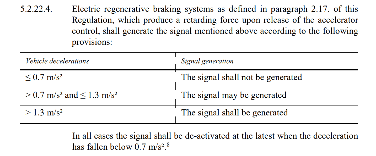

Sorry for going slightly off topic here for a moment, but in reading this stuff about regen I recalled somewhere on another forum years ago where there was a posting about regenerative braking indication requirements and I thought the source was pretty bizarre, so I saved it. Of all things, it was outlined in a document coming out of the United Nations International Regulations for passenger auto braking under Regulation 13-H, sections 5.2.22.x and 5.2.23.x of the code. Since this regulation/guidance is from the UN (though maybe just used in the EU?), it is difficult to say if (or how) it applies or might be adopted by the various manufacturers around the world.
For whatever it's worth I've included a link to the latest (2018) revision I was able to find here: R013hr4e.pdf (unece.org) and snagged some of the text:
Ford F-150 Lightning Towing thoughts/questions 1634000127166

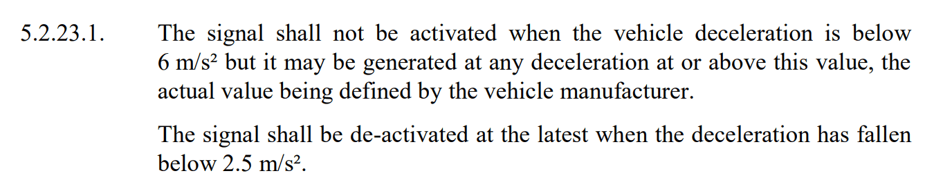

Emergency Braking / ABS:
Ford F-150 Lightning Towing thoughts/questions 1634000331361
Interesting, no? I have to wonder how much the regen is affected (increased?) while towing, factoring in trailer brakes.
