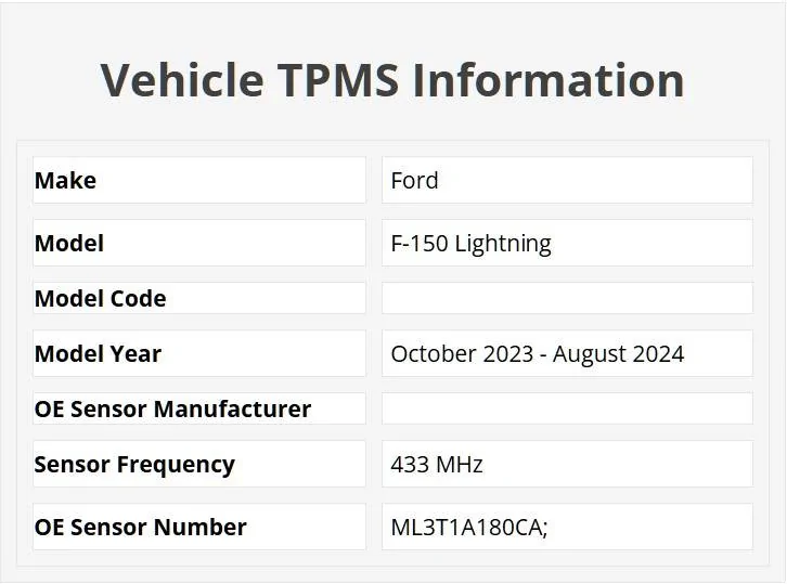

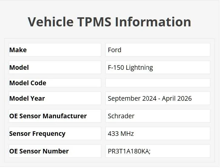

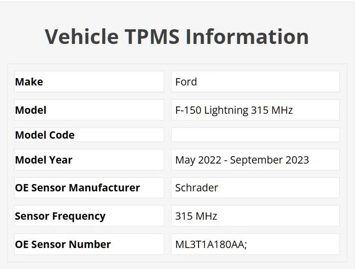

This post/thread comes up frequently in my searches, so I'm pasting for others, going forward.
Via - https://www.hamatonusa.com/vehicle/13045
Looks like there a lot of dual frequency TPMS that have both 315 & 433, bonus.
315 MHz
Ford F-150 Lightning TPMS frequency for Dec 2023 Lightning TPMS 0522-0923
433MHz
Ford F-150 Lightning TPMS frequency for Dec 2023 Lightning TPMS 1023-0824
Ford F-150 Lightning TPMS frequency for Dec 2023 Lightning TPMS 0924-0426
