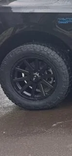

Backhistory: I bought new wheels and tires for my 24 lightning (Lariat trim) (Bought it in March 2025) at my local Discount Tire. I spent a lot of time (spreadsheets) comparing the various wheel and tire combo's that I wanted. I did ION 143 wheels (28 lbs) and Ridge Grapplers tires for the look and they are within 1 lb of the stock wheels and tires. The dealer couldn't get the offset (ordered 18) they only had 0 offset available which is a 18mm poke. Anyway they look FANTASTIC and drive so much better than the stock wheels and tires. Noise is minimal and range has not changed for me. I am getting 290 miles on a 90% daily charge.
Ford F-150 Lightning TPMS reset vs relearn proceedure for 24 Lightning 1749064936553-21
