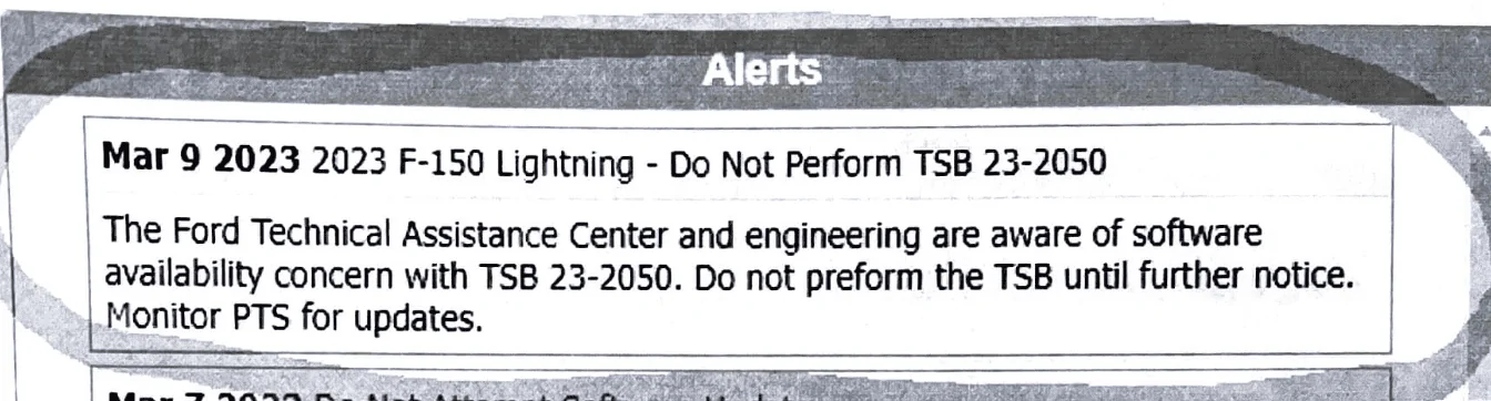

Ford put this out last night. Looks like we have to wait until at least June to get this fixed.
For what it's worth...
I had the TSB done and I still had FordPass issues. I know some people at Ford are investigating my truck and what happened with the TSB.

Yeah, that's fine. My frustration is that there was no clear communication on whether the TSB should be done or not. I took my truck in on Wednesday and they said they couldn't do it but referenced the SSM for the ICE trucks. At least it is clear now. The TSB required a check of the LVB and since they didn't do that I took it back today because my LVB never gets above 60% SOC. I'm also getting the lane centering TSB done
Great.. well I guess I’ll cancel my appt then. I was supposed to go in March 20th.

UPDATE #3:
I am happy to report that I am approaching 2 weeks (which is about twice the mean time to failure of ~4 days previously) post the updates for the TSB and no issues to report . The truck & Ford Pass are operating as expected
UPDATE #4:
Unfortunately, last night the gremlins in the system returned and my truck lost connectivity again along with Ford Pass sync & features not working. I let it sit overnight on the off chance it was some other Ford Pass issue but no such luck. Tonight, I pulled fuse 32 like I had done in the past and it restored connectivity & Ford Pass functionality.
It looks like Ford has replaced the original TSB with the below SSM which indicates OTA Ford Power-Up in April 2023 as the next attempt to resolve the issue.
SSM 51431 2023 F-150/Bronco - Inoperative FordPass App, Remote Start And/Or Remote Lock/Unlock
Some 2023 F-150 vehicles built on or before 28-Feb-2023 at Kansas City Assembly Plant or 07-Mar-2023 at Dearborn Truck Plant, 2023 F-150 Lightning vehicles built on or before 13-Dec-2022, and 2023 Bronco vehicles may experience inoperative remote start and/or remote lock and unlock through FordPass. Diagnostic trouble codes (DTCs) U0146:09 may be stored in the telematics control unit (TCU), and U2402:00 and/or U2402:92 may be stored in the gateway module (GWM). Inform the customer they can continue to drive the vehicle. A solution is planned for deployment via Ford Power-Up software updates delivered over-the-air (OTA) beginning April 2023. Software will update automatically on vehicles connected to FordPass. Monitor OASIS for additional updates. Schedule an appointment in April 2023 for customers that are not connected to FordPass once the repair is available.
The SSM is not for Lightning, it is for all other F150s.
HOWEVER the TSB is currently on hold due to technical issues on the backend
Reactions: GDN
I see. They really should correct the documentation for SSM 51431 then as it shows up when I query at https://www.ford.com/support/service-information/ using my VIN and specifically calls out "F-150 Lightning vehicles built on or before 13-Dec-2022" in the body of the article. The title of the SSM doesn't list Lightning which tracks with what you are indicating.
The TSB I referenced in starting this thread used to show up in the service information query but now doesn't. It is unclear if it is because I was able to get the updates for the TSB before the latest backend issues or if they pulled it to reduce customers requesting it while they fix the infrastructure issues. I am guessing it more likely the latter.
