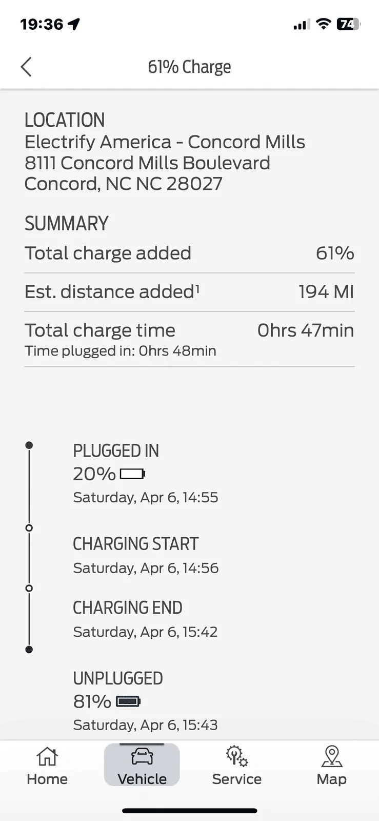

Still in the learning mode and adapting my brain to the EV world and how to drive effectively to maximize mileage since I do travel. Any guidance on the following would be appreciated.
Today I charged up at an EA station since I’m still waiting for an electrician to schedule me in to install the charger at my house. I have a Platinum (ER). I charged from 20% to 81% and then drove 50 miles…the charge went down to 70%. So my simple brain says I used 14.41 kW ….131 kW x (81%-70%). And therefore got 3.47 mi/kW….(50 mi / 14.41kW). But according to the console I was getting 2.3ish.

What was your speed, wind conditions & terrain for the 50 mile return trip?
Favorable conditions can improve results, to the degree of 3.47 is optimistic but possible under downhill conditions
The stat's on the trip meter can be deceiving if not cleared after a charging session, it is common for us to keep the truck ~idling~ in RUN or ACCESSORY mode while DCFC'ing. Once you're done charging, fully shut down the truck, to clear the current trip log, then restart and head out.

It was flat and 65ish degrees BUT…good call out on the shutting it down. I had the accessories on while I charged so the trip never reset. So I guess I need to do that. And thanks for the info on the elimination of the trip info in the app
But..the math I’m using makes sense right ? I know 3.5 is WAY too optimistic and I wouldn’t use that….but…it does appear if the charge dropped 11% after driving 50 miles (under the current conditions)is what the true mi/kW that was used ….. Right ?

Your math is correct, theoretical 2.44 for a mixed cycle drive is what Ford uses for ideal conditions, so the dash value is possibly a mix of prior better performance and then a lower performance for the highway drive.
