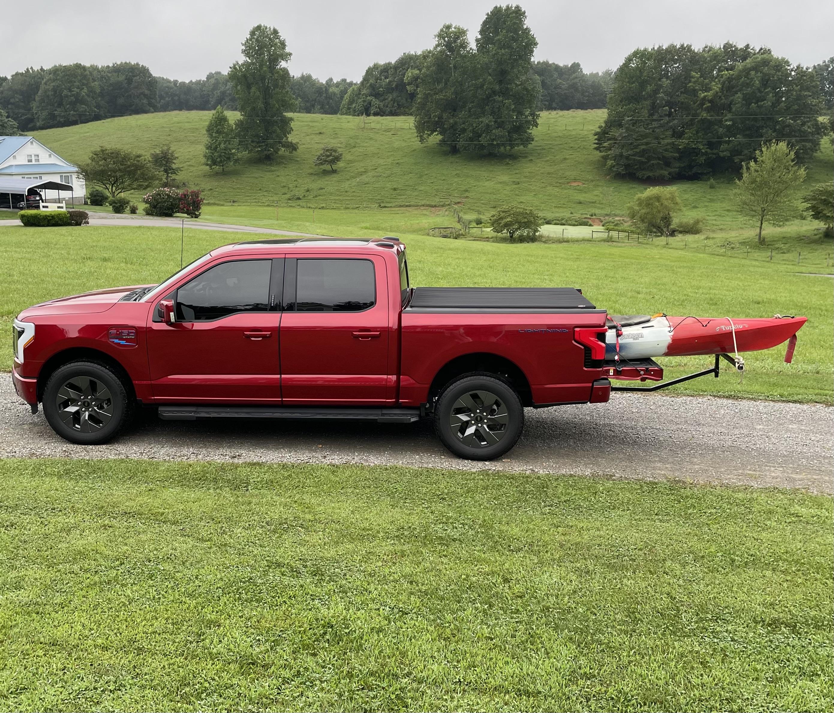

I’ve built a couple of load extenders. One for my Maverick (traded for the Lightning (miss that little truck)).
That load-extender looks super cool, and potentially weldable via ProPower Onboard. You have any plans for it that you could share?
I don’t. It’s totally custom. It also is built so it could raise the T with an extension to make it rack level. (It will raise up to be level with top of the truck.)
If you’re truly interested in building on like it, I can take some measurements and pics and PM to you.
Thanks for the offer! Let me see if anyone else has plans for any other things. That actually might exceed my welding abilities anyway, meager as they are... I may just end up doing some light repair of a few broken metal things, and then mentioning that forum members had made some really cool stuff.

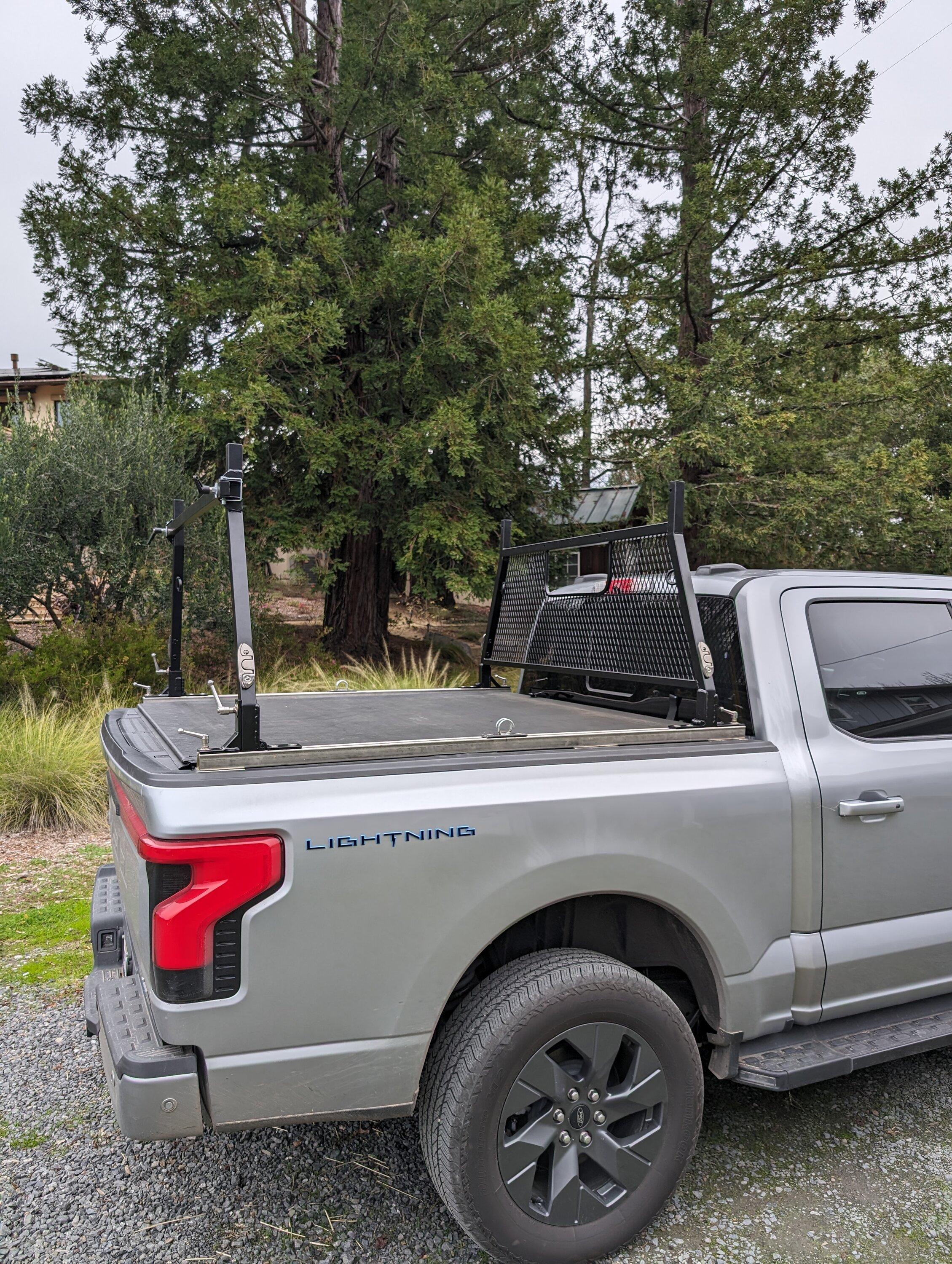

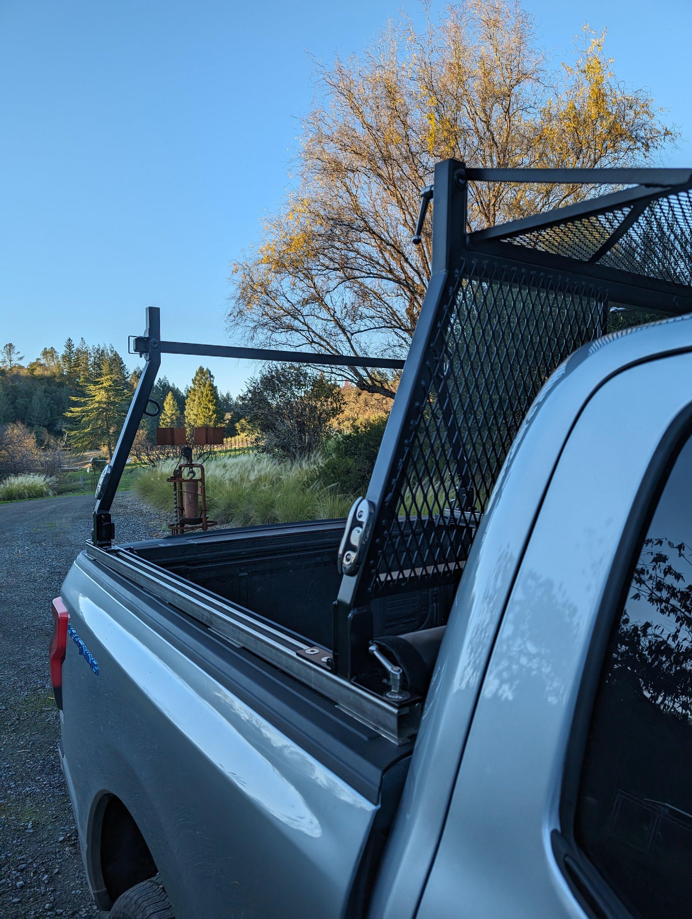

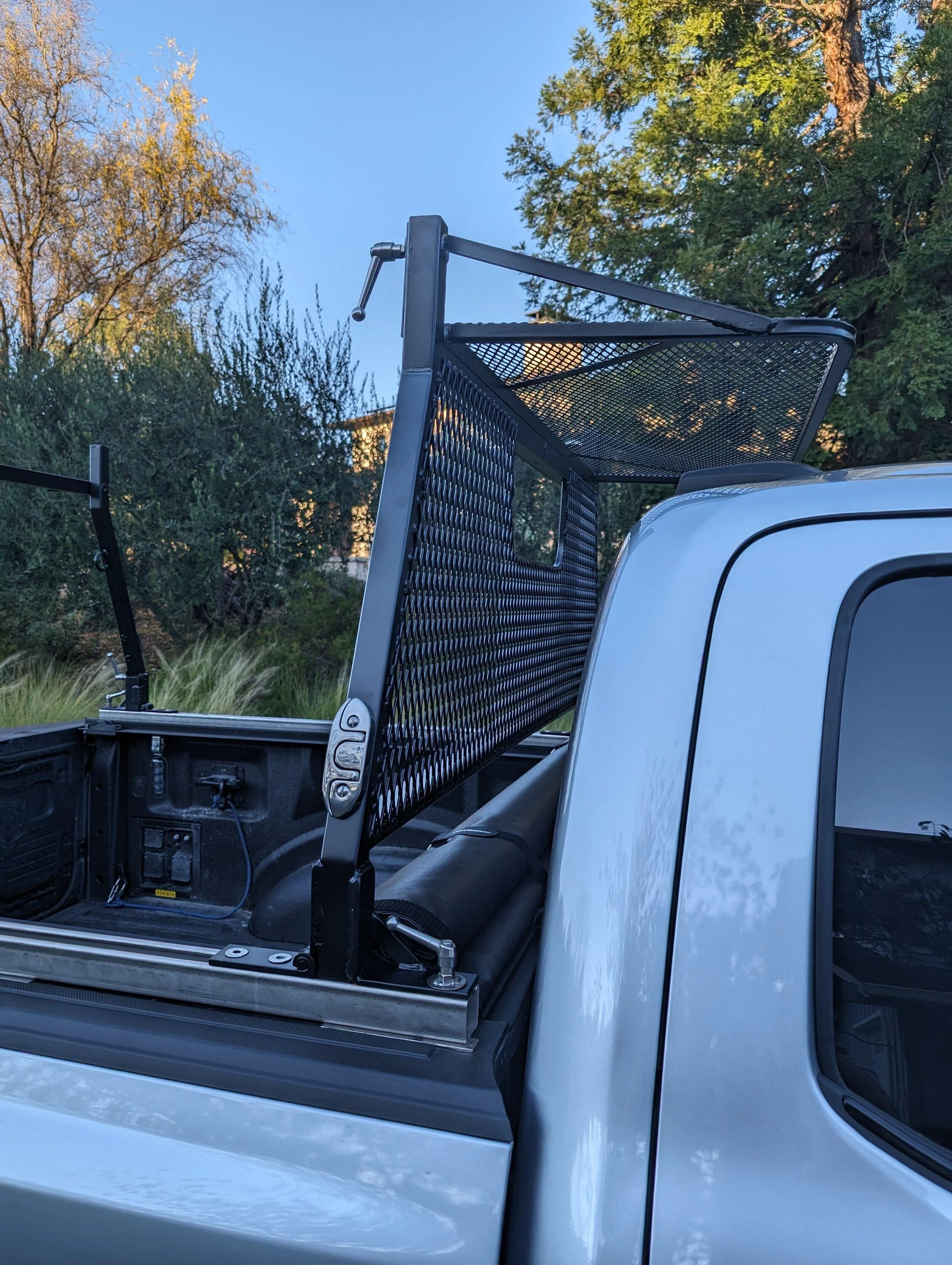

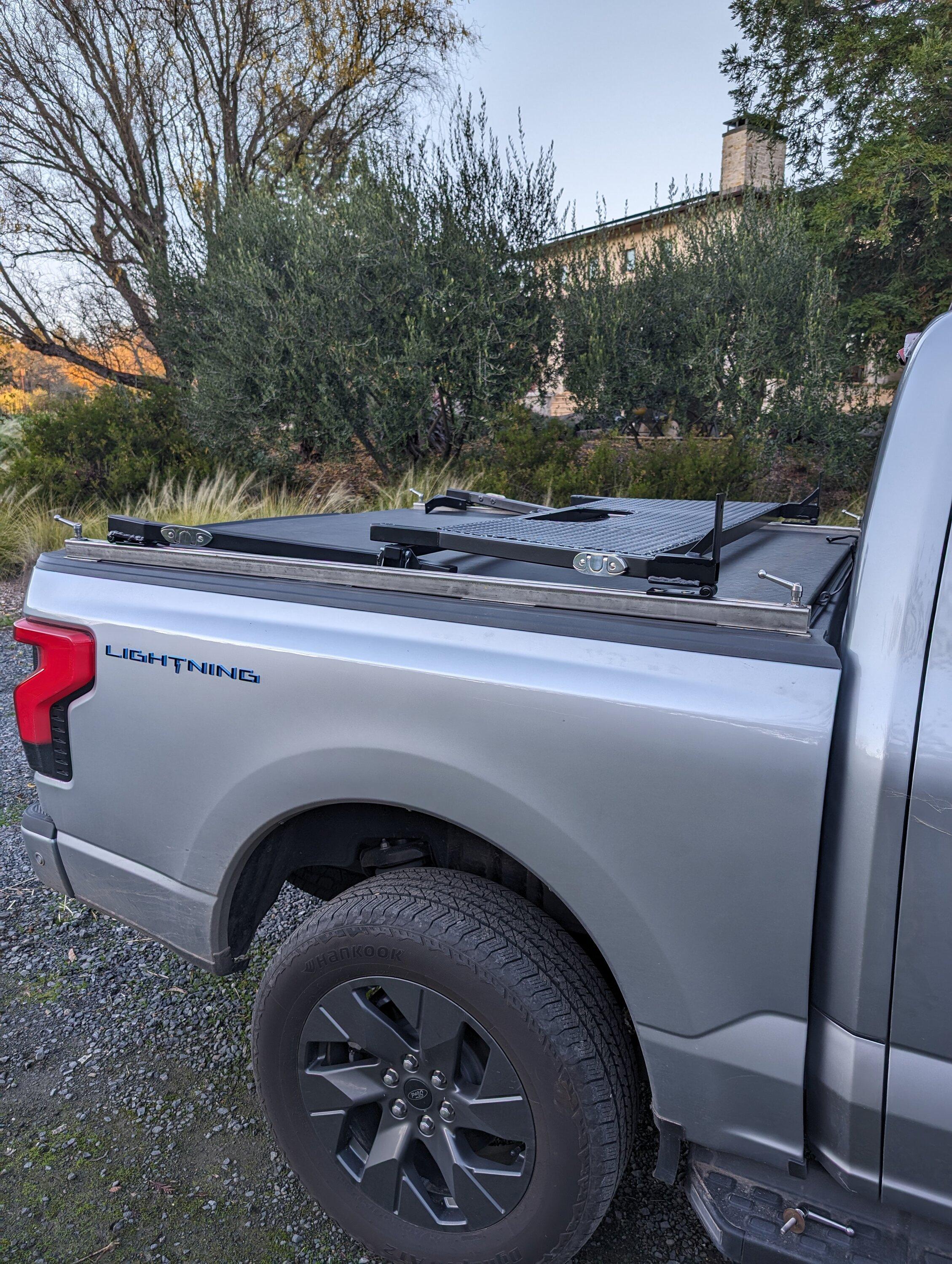

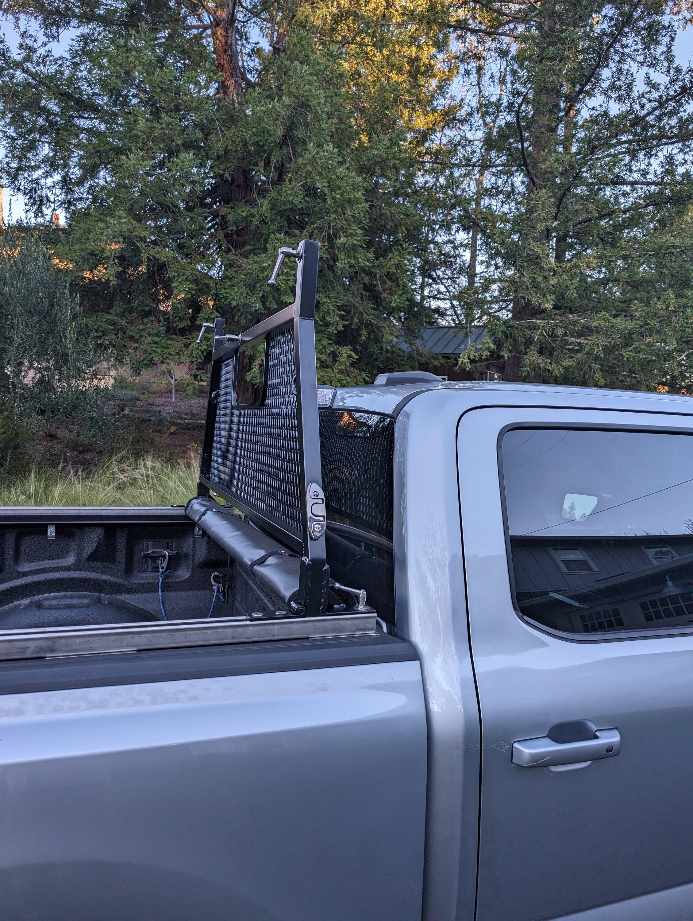

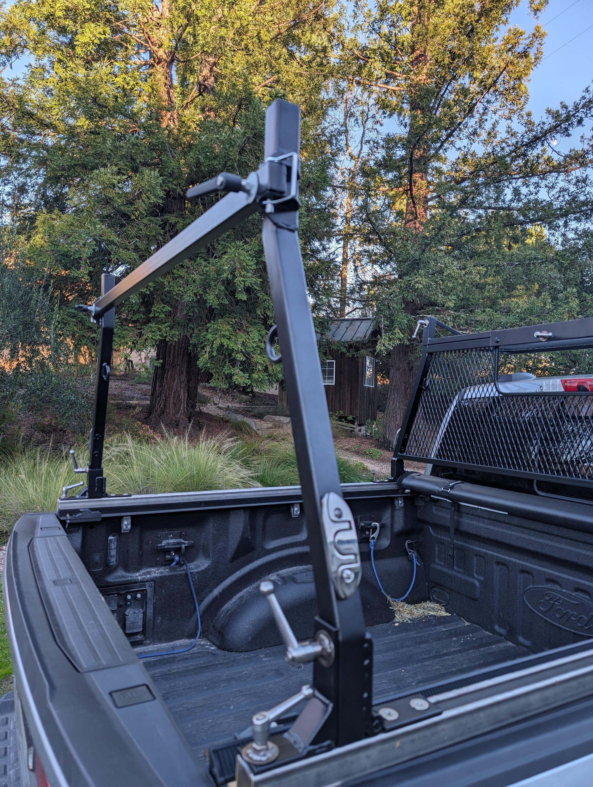

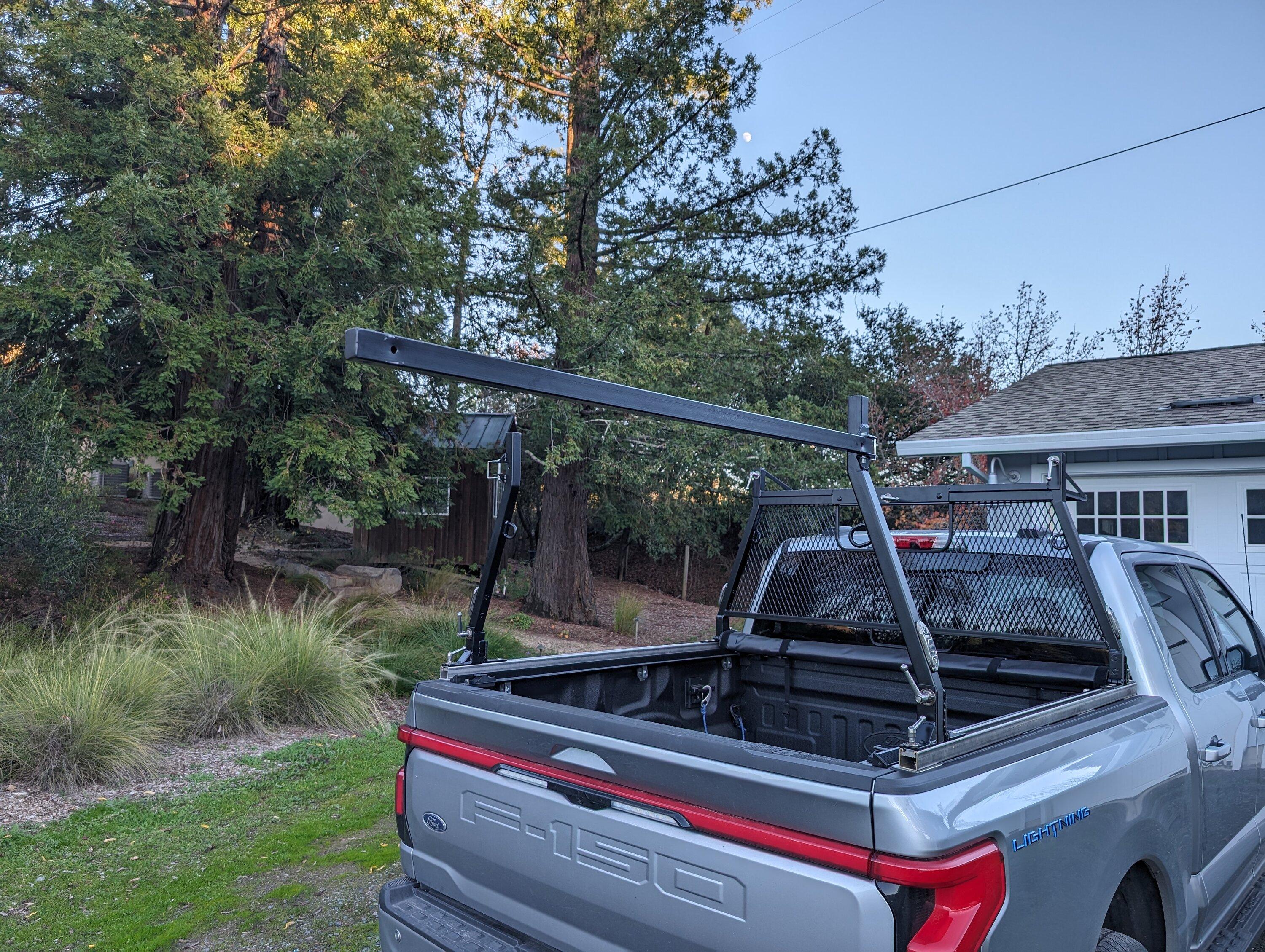

I made a rack that folds down without tools and has a detachable rack over part of the cab. Rear horizontal bar can swing out or be removed. So far works pretty well. About 1.6 mi/kwh when up at 72 mph, about 2.0 mi/kwh when folded down.

That is SO cool, and so much more important to be able to fold a rack like that down when not in use on an electric truck than on an ICE one. Replicating it is WAY beyond my capabilities, but would you mind if I shared a picture with my audience at motortrend.com when the time comes?
Very nice, high quality engineering and fabrication.
(I like your yard art too. You have a website?)
