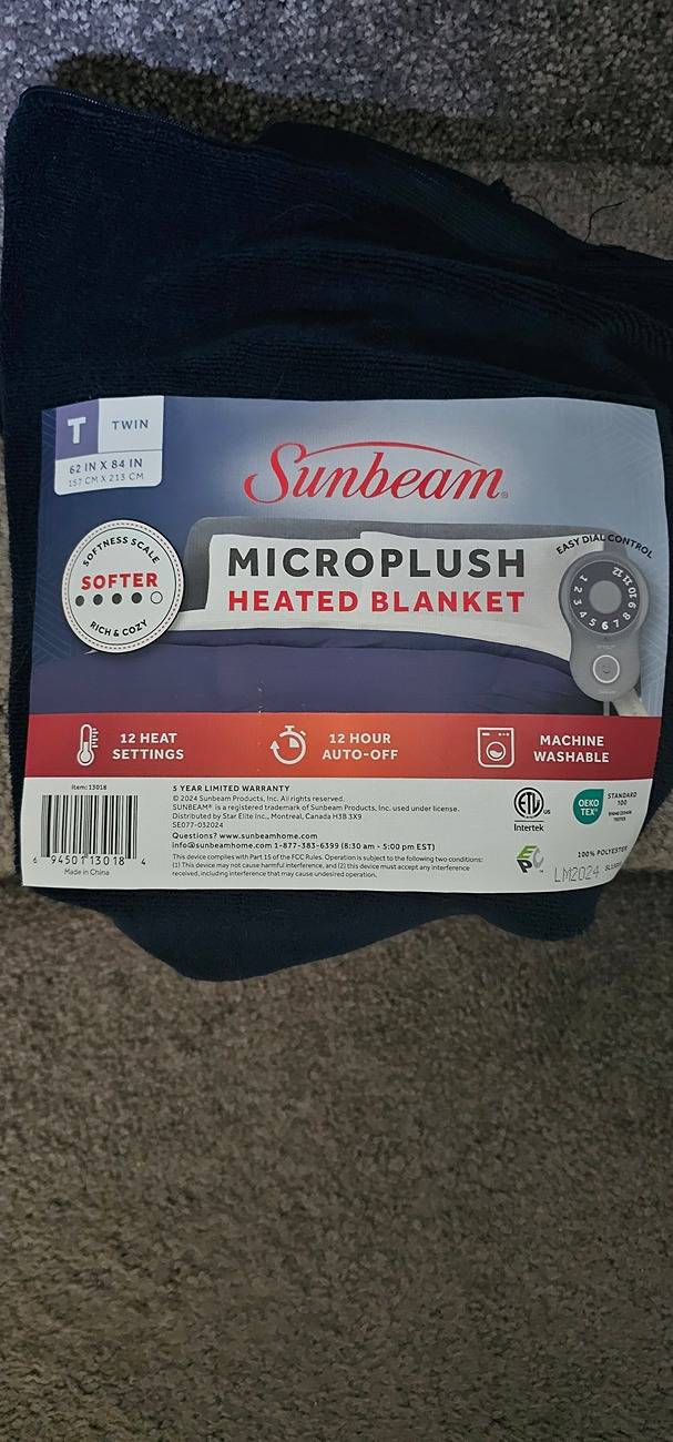

I can look into this next week as I'm headed out to acolorado to visit family. But, I did take a picture of the blanket label if it maybe will answer some questions.
Ford F-150 Lightning Using Pro power in the bed for an electric blanket? 20241029_101550
