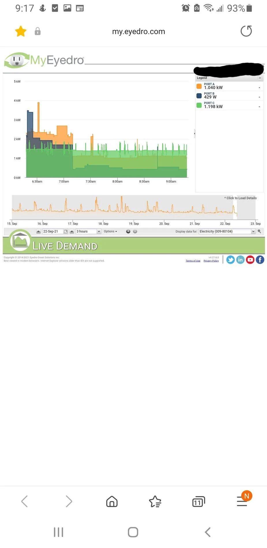

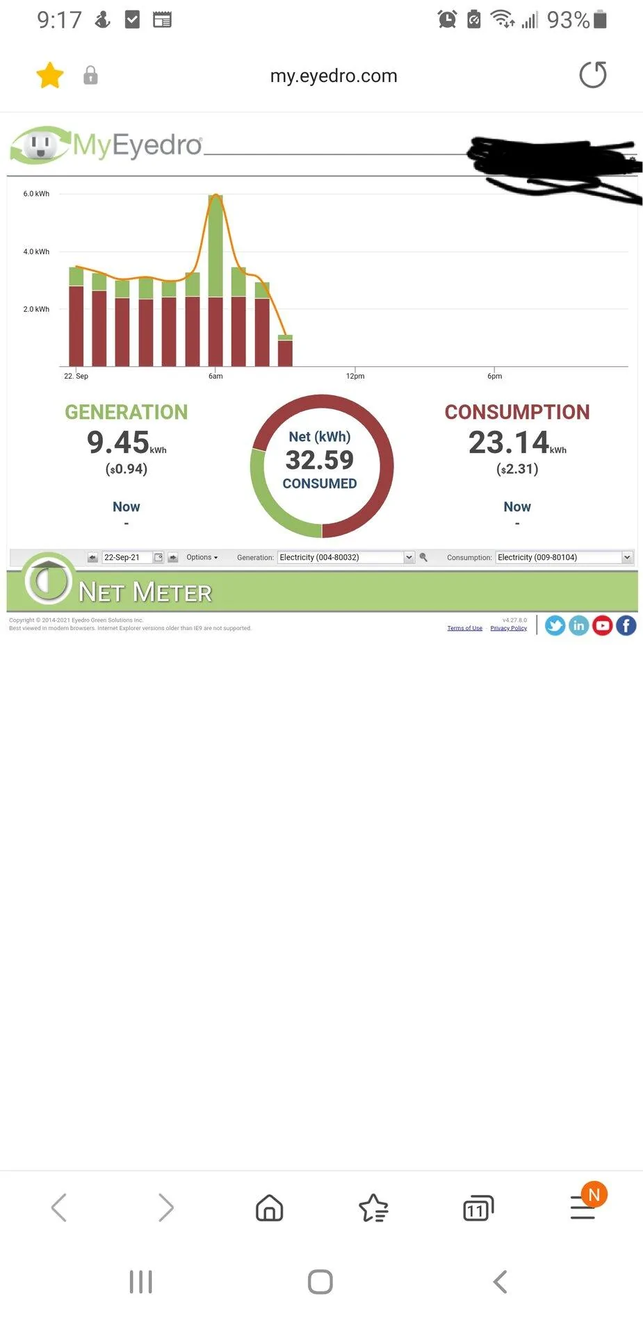

Your electric bill is supposed to show your monthly kWh consumption. Or does it work differently for you? If you want to know something in more detail, I can advise you. Just be more specific about what you are interested in. I've been an electrician myself for several years. So I have good experience. I can destroy your stereotypes about this profession. Since it used to be particularly disrespected. Now there is nowhere without electricians. And we have become more highly paid. You can't imagine the effort I went through to learn to understand all this electricity. There are even various applications where you can pay for and view your electricity in the house here. You can also use eyedro for monitoring. And set up three separate monitors to help with surveillance.
monthly bill shows kWh but not amps. I wanted to see how much is being used at different times so that I can size up gen. Also, to see how much is being used during day/night and by each circuit.
yes, it is doable with an ammeter but an out of the box solution makes it easier. For me, it is one time thing and then use it as needed.
