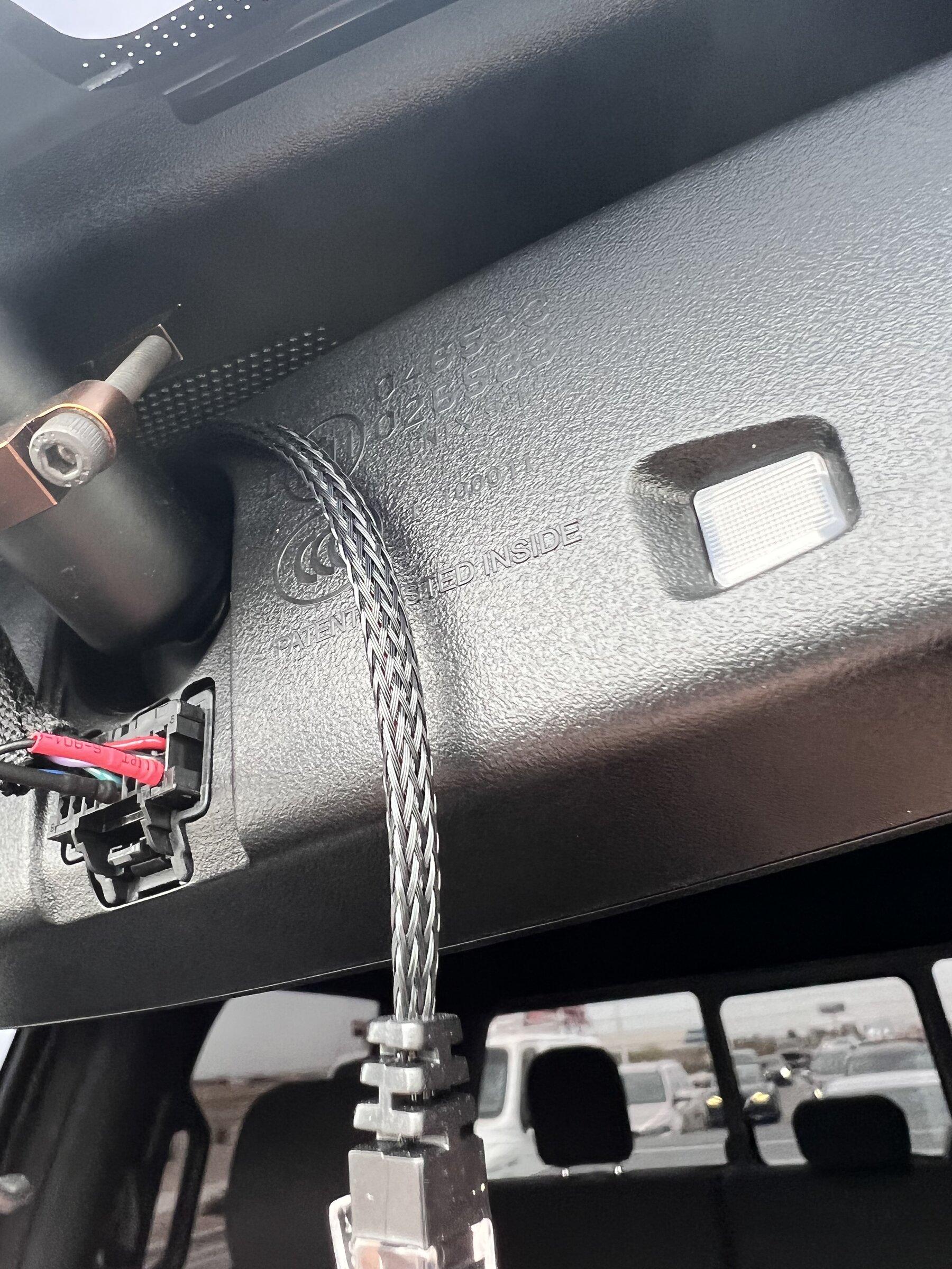

For anyone needing reference on how to hardwire. Jump C919 harness with:
PIN 2 (+)
PIN 10 (-)
