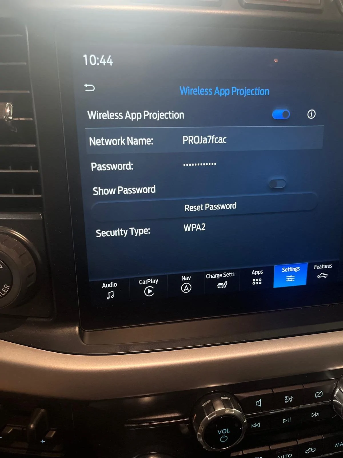

We have two F150 lightnings.
My PRO works just fine on wireless CarPlay 99.9% of the time.
it just works.
But it will not work on my wife's XLT.
I've been through all kinds of menus, resetting the phone, redoing the CarPlay, resetting the infotainment screen. And I still cannot get it to work. This picture shows what my truck looks like with Wireless app projection enabled.
Ford F-150 Lightning Wireless CarPlay won't engage IMG_8701

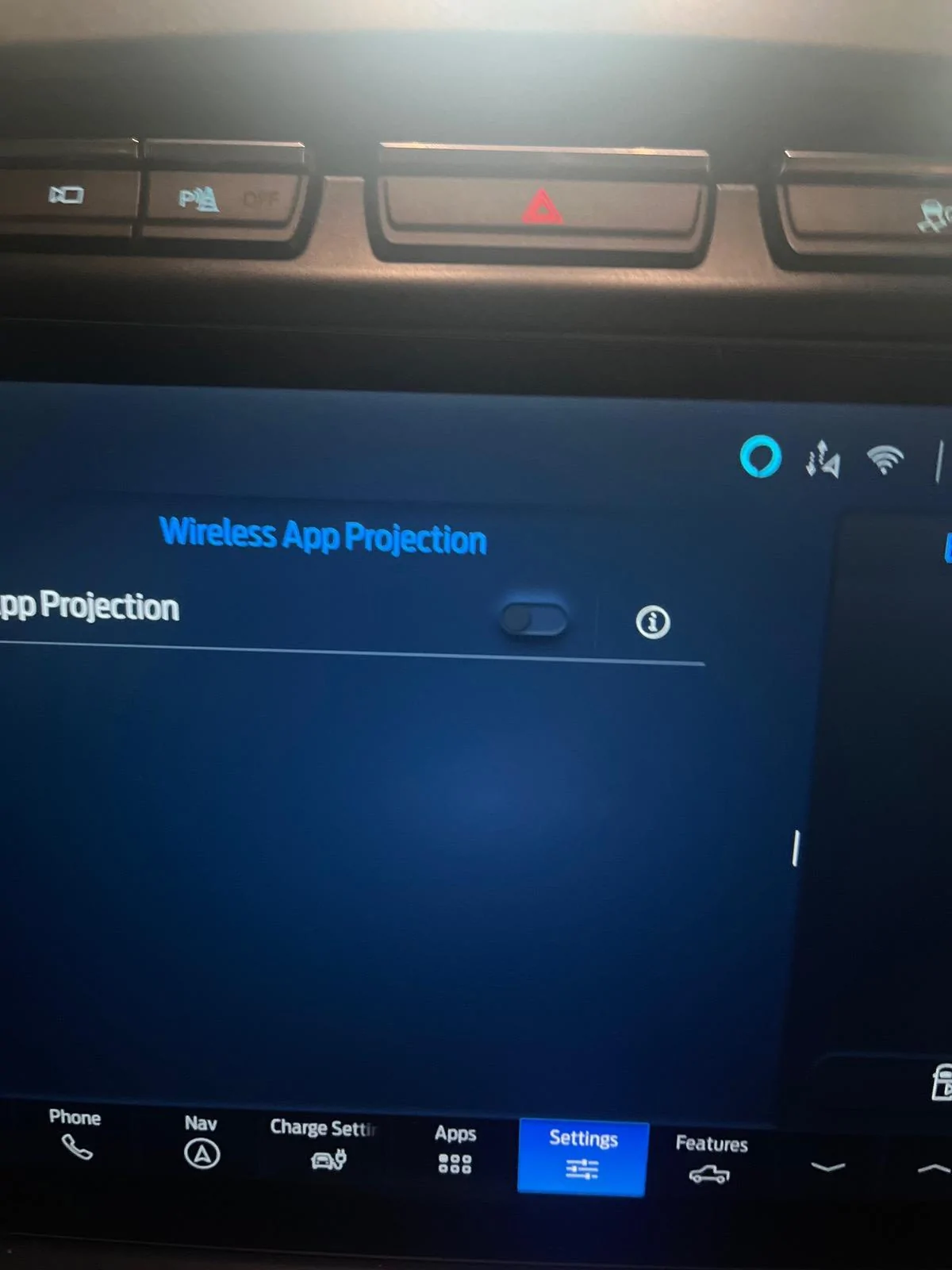

But on her truck, this is what I get, and I cannot turn that button on.
Ford F-150 Lightning Wireless CarPlay won't engage IMG_8704
does anyone have an idea of how to get that wireless projection to enable?

We have done all those things.
the truck ? just won't turn on that wireless projection.
guess it may need a software update at the dealer.
The BT and modem all work. And CarPlay works with the cord. So what the heck ?

occasionally my pro does that but I just turn off wireless car play on the truck's phone menu and then turn it back on.
My wifes truck however wont even project its Wifi. Maybe we have a bad module.

Hi there! Will you send us a message with your VIN and your local Ford dealer? I can look into things on my end.
