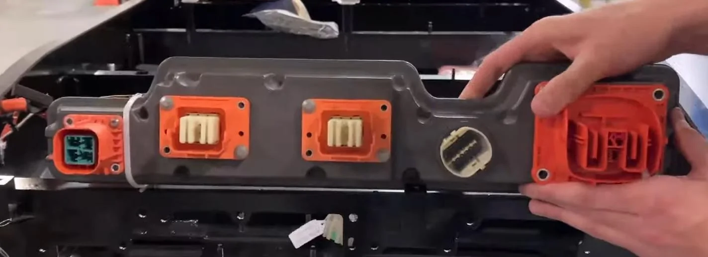

I had the same problem at 6 weeks old. Probably a fluke problem, but it had a damaged wiring harness at the high voltage battery. By damaged I mean it was already corroded enough from salt to cause problems. It must have been missing the seal in the connector. 4 1/2 week wait for a couple wires. Judging by the part numbers i saw it was the roundish white connector in the photo.
