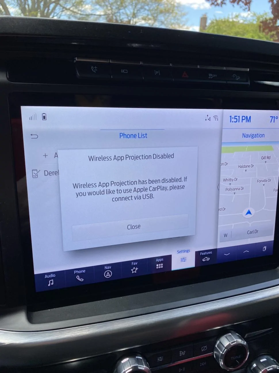

If you cannot enable Wireless App Projection using the steps above, you may be seeing the same problem myself and some others are, where it isn't working. We are also unable to activate the truck in FordPass or enable Hotspot. It looks like some trucks built in early May out of DTP, at least so far, have out of the box modem issues. Mine has been at the dealer all today and they are working directly with Ford engineering, and haven't gotten it working, so may have a new module on order.
When you tap the selection for Wireless App Projection, it beeps but nothing else. If you go through phone setup from scratch, it gets past where it says Enable CarPlay? Then says it has to Enable wireless App projection, you hit Enable, and it just says Wireless App Projection Disabled.
Mine was built 5/3 DTP. Will check to see if I get similar result. Thanks all for the help.

Well I also found out that my wireless App projection will not enable. I'm going to wait and see how you other folks get it resolved before bringing it in. AS I said earlier mine was also built first week of May out of DTP. Thanks again!
