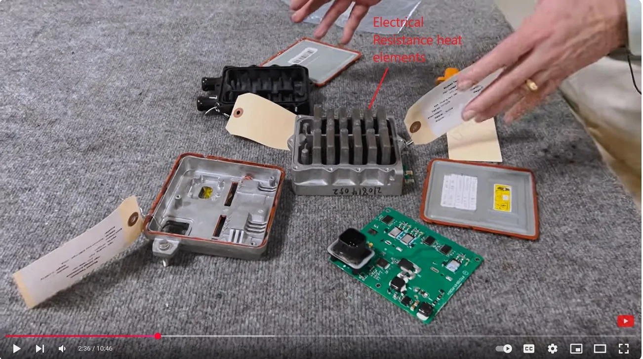

UPDATE:
The heater module was indeed the failed part. Once replaced, it fired right up. The whole truck was defeated by a freaking kettle.

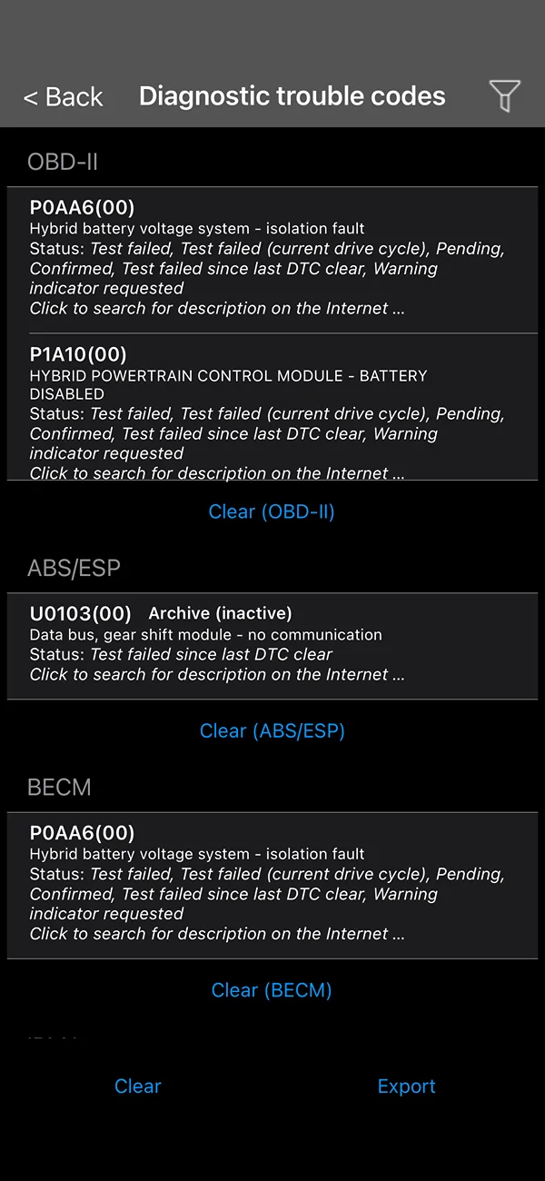

I would think if the dealer followed the full testing procedure, it didn't fix it and come to find out it was caused by a short in the PTC then Ford would eat it due to the testing procedure being insufficient. Not disconnecting the PTC before testing likely made the harness test bad if there was a short even if the harness was actually still good. From what I hear a PTC short is extraordinarily rare so it's actually pretty likely the diagnostic didn't require a disconnect before testing the harness. I'd be willing to bet that it will very shortly.

I’m hoping @Ford Motor Company can explain why and how a heater module could be allowed to blow the “spinal cord” of the vehicle? Seems like a huge shortcoming, maybe unknown, and this story can help correct that.
