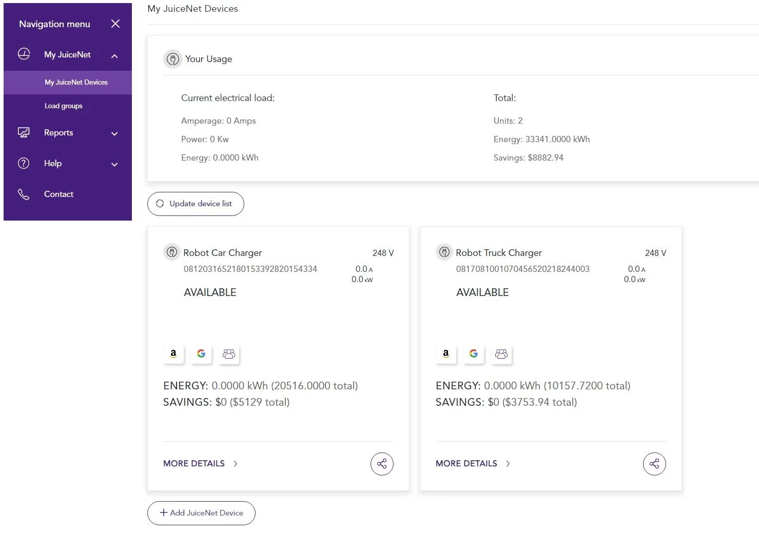

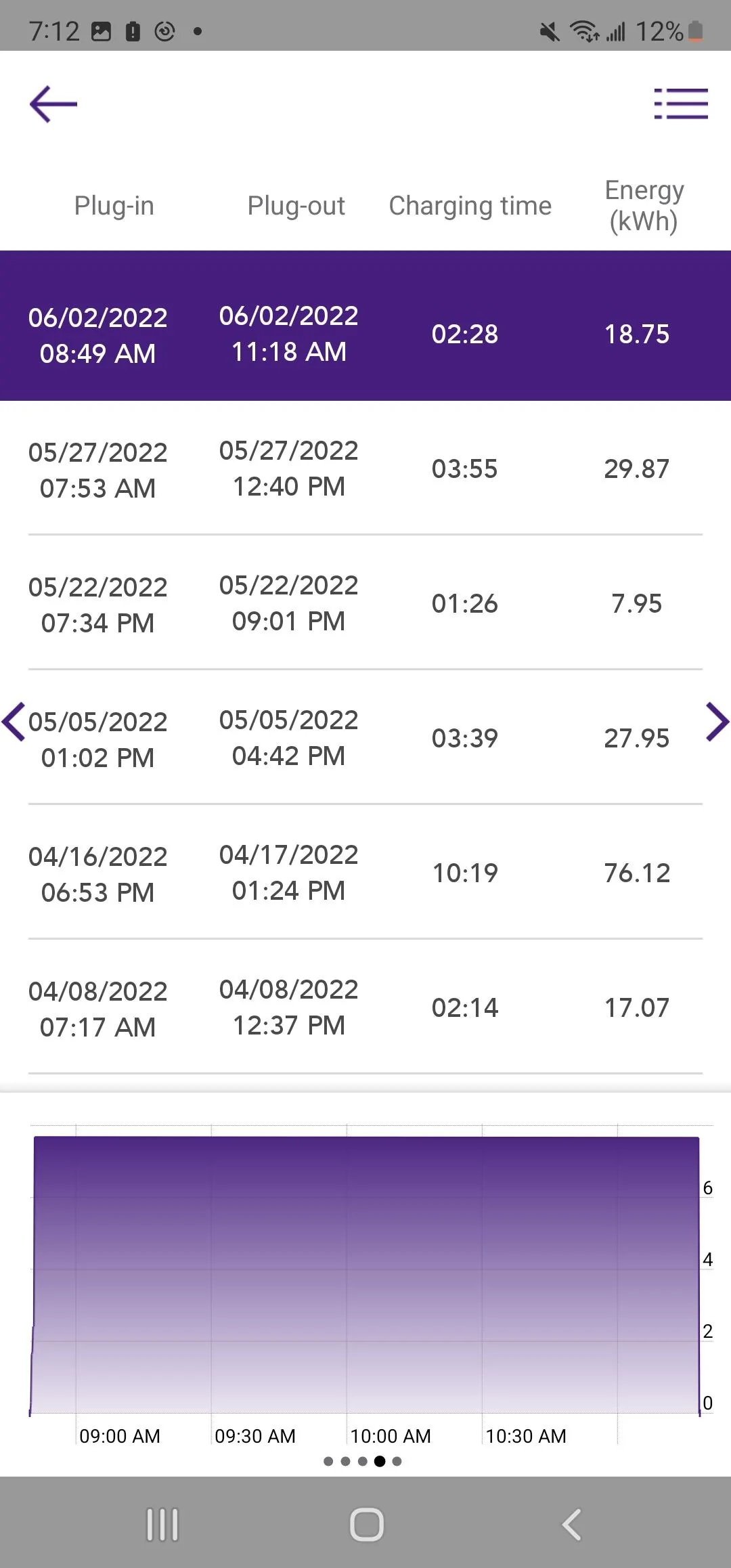

My Lightning is on the way and I finally got my second EnelX Juice Box installed in my garage. I'm using a software feature that allows both boxes to intelligently load share a single 50 amp circuit. If only car is plugged in, it will deliver a full 40 amps to the in-use box. If both are plugged in and charging, it will provide 20 amps to each box and will shift the amps over to the other vehicle once the first one has completed charging. It's a great option for those that have two EVs and aren't able to add another branch off of the main panel.
I've been using a JuiceBox since 2019 and it's been rock-solid. Customer service has also been great--I put in a request to add the Lightning to the vehicle database and they updated the software within 5 days. The android app and desktop portal work well and has many options for monitoring and smart home integration built in.
