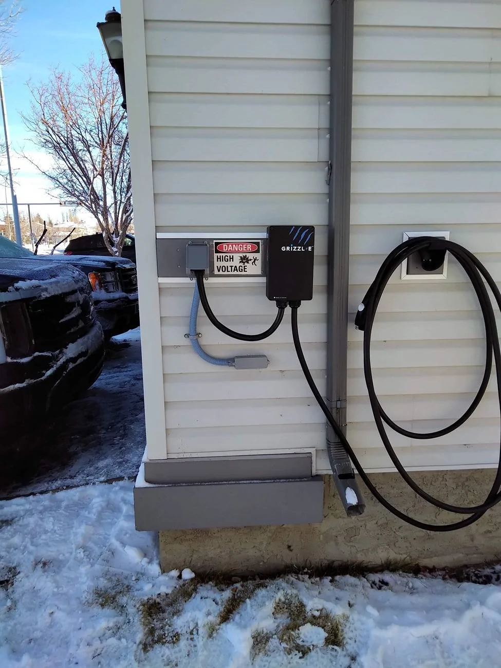

Since you are going to have an electrician out to take a look at the wiring, i suggest that you ask him to take a look at your panel to see if there is room to add 50 amp breaker. if so why not get him to provide a quote to install a NEMA 14-50 Plug either inside the garage on the left hand side by the garage door opening or outside the garage in your carport on the wall beside your garage door. you can then use the ford portable charger to charge your truck, or you can buy and install a 40 amp charger that is set up with a 14-15p plug. attached is a picture of my setup.
Ford F-150 Lightning Lightning SR - no home charging experiences? IMG_20231210_1229385
