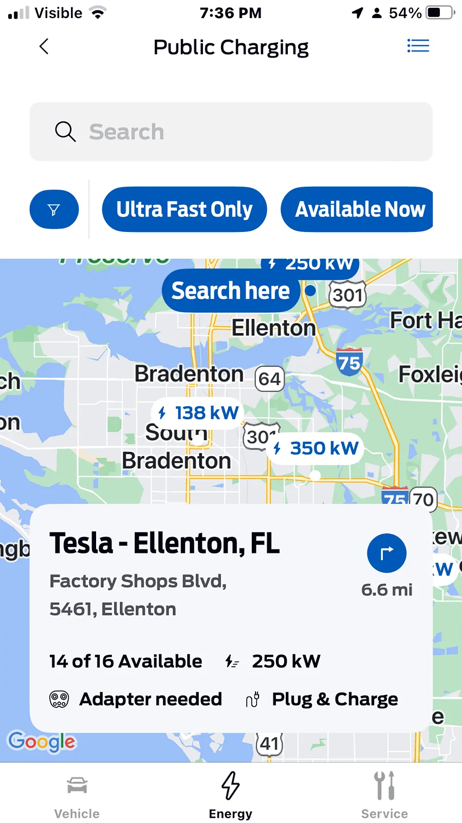

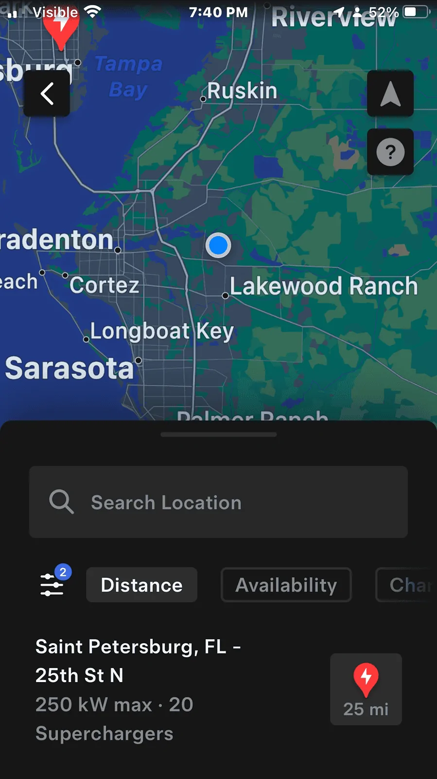

What am I missing. What did I do wrong?
I tried to charge at a Tesla location in Ellenton FL with my new Ford Adaptor this evening and it failed.
The location shows in the Tesla online site map as having ability to charge CCS with adapters.
In the Tesla APP when I go to "Charge your other EV" it doesn't show this location on the map.
The Lightning Ford Pass APP shows the 16 Tesla stations are capable with adaptor but it fails.
What am I missing?
BTW, The 4 EA chargers at this location had 2 of 4 broken. The other 2 were occupied.

Site shows up on my Tesla app. Looks like you have 2 filters applied. Might check those.
Did it fail from Ford P&C?

Thanks for the reply.
I just got of the phone with another member. I didn't have "YES" checked in the Vehicle Details for the Ford Lightning "Do You Have a NACS Adapter" checked in the Tesla APP.. Once I checked that the Ellenton site showed up on the Tesla APP. I have 2 Tesla's and never had an issue with the APP but didn't realize the other selection was required to charge non-Tesla's.
When I JUST plugged in it did fail P&C. I have used P&C at the EA chargers at this location using my free credits.
I don't know if I have the correct software update on the Lightning to P&C the Ford at a Tesla Charger.
You should be able to charge now using the Tesla app. As for P&C, you need the Tesla OTA from Feb 29. The best way to know if you got it is to post your VIN on the VIN lookup thread and ask if your truck got OTA 24-PU0119-DC-CHG4.
