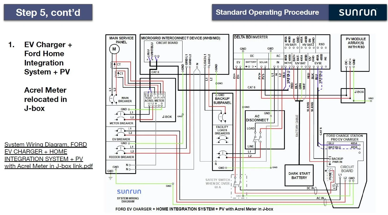

Q1: the HIS can have a solar input, but an inverter takes a DC input from the PVs and produces AC, so solar panels to the HIS BDinverter is provided for (see the Sunrun documents) as a DC input through the J box.
However, you could use the solar AC system as an alternate power source through a transfer switch to the BACKUP BREAKER panel.
Ford F-150 Lightning HIS system with AC coupled solar and ability to charge truck via DC off grid. Integration Sys CSP-SunRun-PV wiring
In this diagram, the solar cells are shown on the far right top of the diagram.
If another AC source is provided, it could be connected via the BACKUP SUBPANEL and another transfer switch.
The Lightning and the other AC source (e.g., the solar inverter AC output) could be switched with another AC DISCONNECT to input to the AC IN of the DELTA BDI. So if the Lightning is not connected the solar cell inverter AC output would power the BACKUP SUBPANEL.
Or one could switch the solar DC output from the solar cells, from the solar inverter to the BDinverter PV IN.
Best to check with Sunrun/DELTA or the installer about what is the best way to have the solar connected.
But there are definitely multiple ways it could be done.
