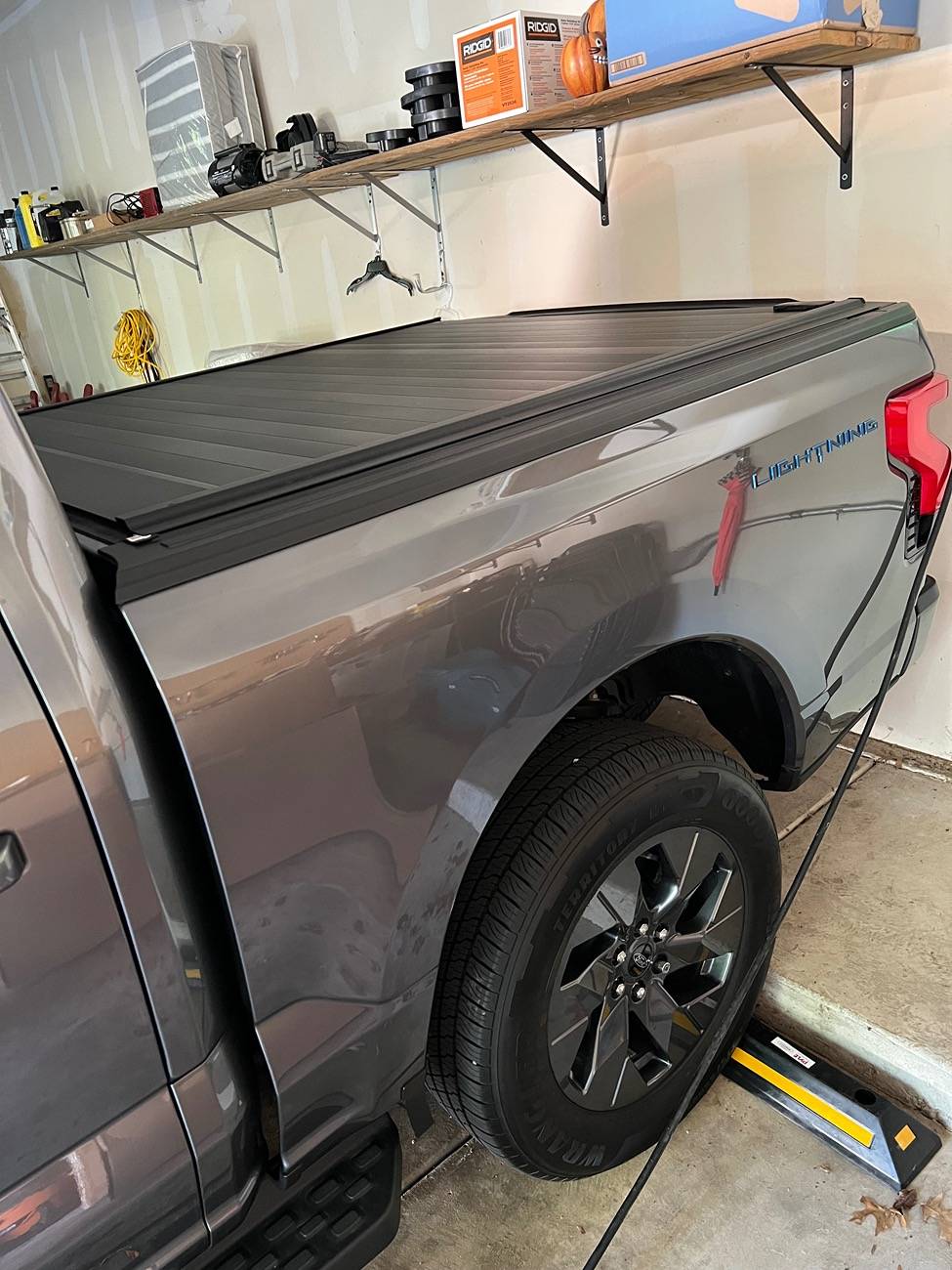

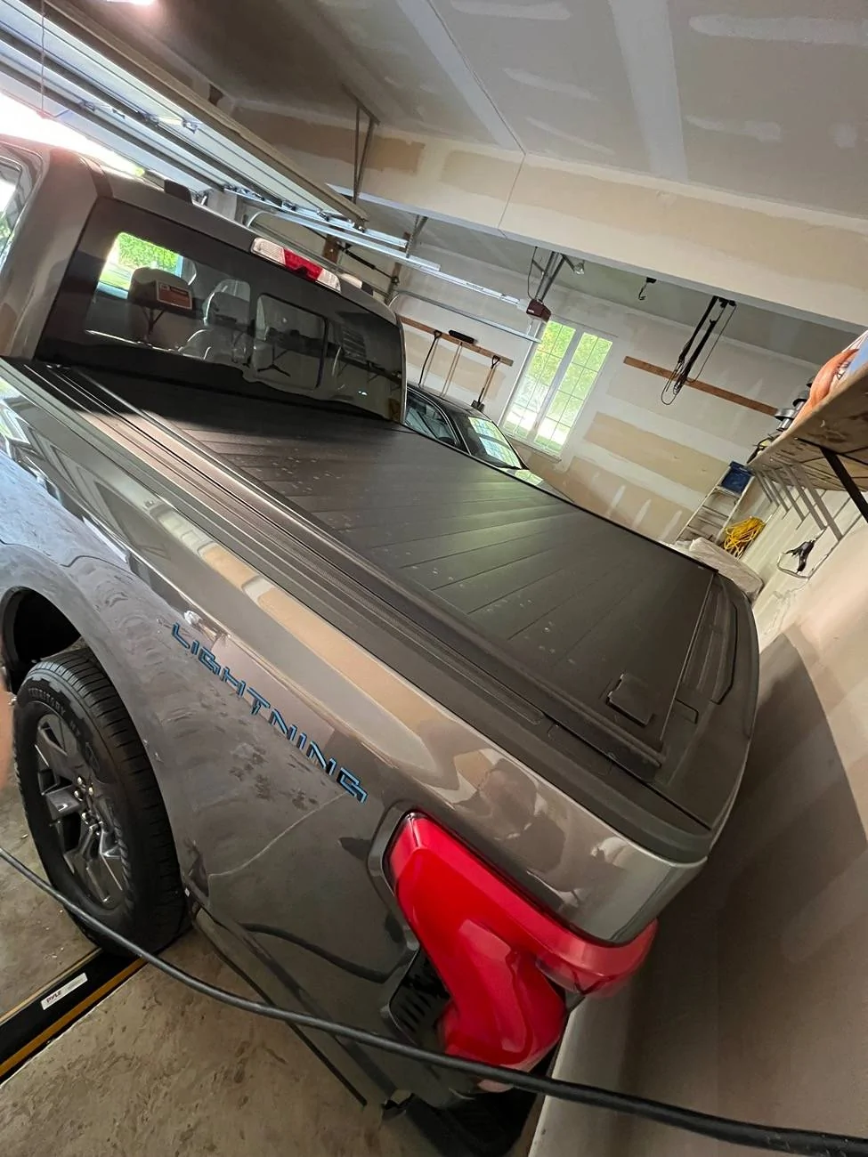

Ordered via ford accessories and paid for the dealer install last week. Picked up this afternoon installed. Fitment with the tailgate and head of the bed look good but up close I noticed it is not perfectly parallel with the bed. May need to tweak it after a few days if I notice water intrusion from the storms about to hit the Midwest later this week. Looks slick and I like the additional security requiring a key to unlock it with a physical key.

I had this exact cover on my Tremor. Kept having some issues (and I expect you may as well) with the alignment during opening or closing. What happens is the brackets that hold the railing on shift with the movement of the truck bed, causing the cover to bind when opening. Retrax sent me updated brackets to correct the problem. It didn’t.
My suggestion is to verify that the cover rolls back and forth freely and maybe once a month or so check the clamp bolts for tightness. When those things bind up it may not open or close at all and if you you force it too hard, it can cause a little damage to the tracks. I installed mine so I have a good idea how it all works.

They are, but nothing is 100%. If you get significant water intrusion it may be pitched incorrectly. The installation instructions specify a pitch to allow water to drain properly away from the bed.
