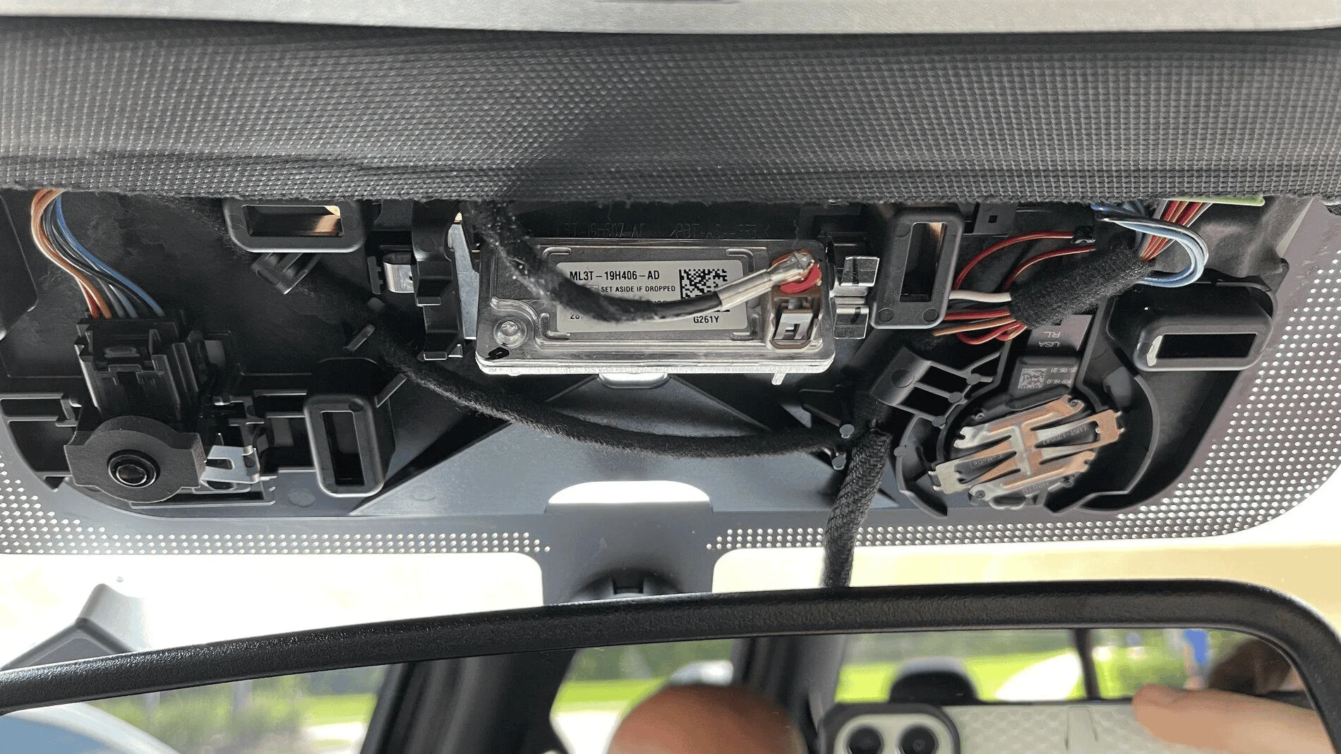

Ive been looking through the ICE forums and found this, I’ll look to see if this might be the issue

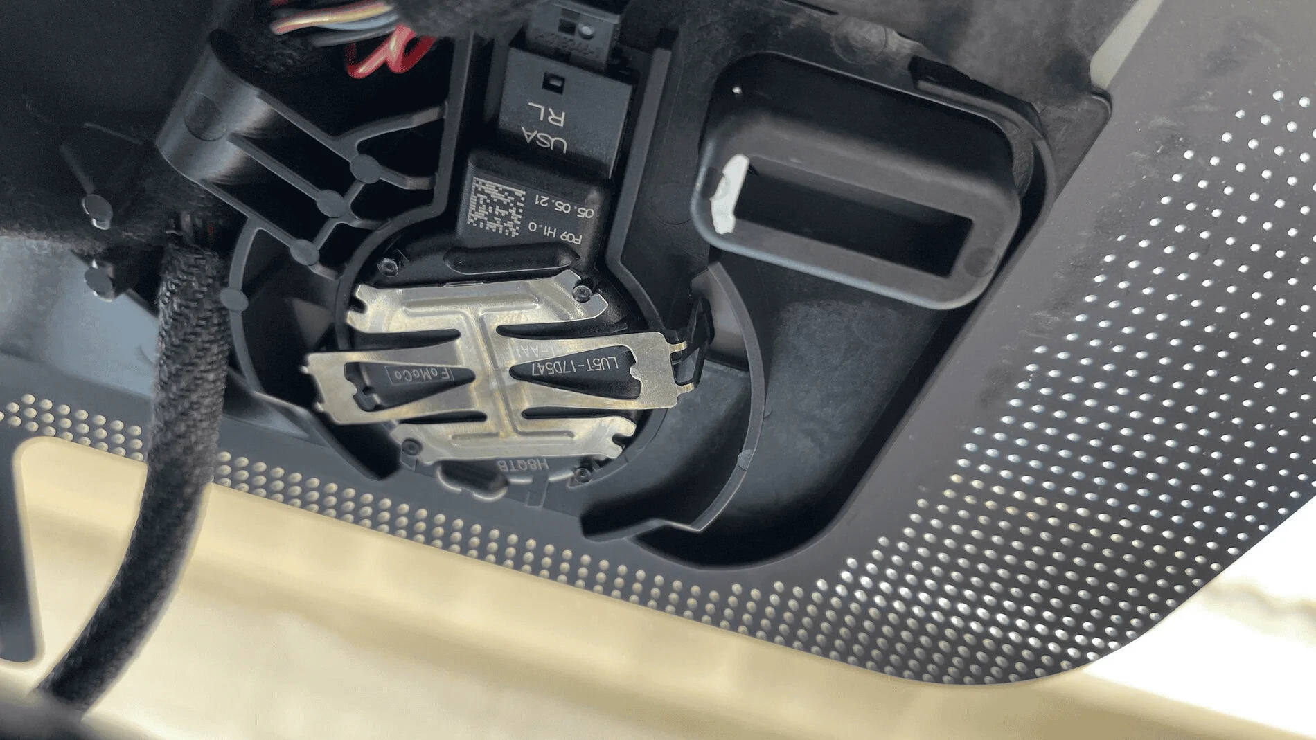

UPDATE: While outside of the truck and standing at the hood looking at the windshield and the cameras, I noticed that the rain sensing wiper sensor had a weird shadow. On a hunch, I took off the plastic camera cover by the mirror (inside the cab) and it was immediately clear what my issue was - the rain sensor has 2 clasps that snap it into place when installed, but only 1 clasp was secure and the other was not, leaving the camera hanging incorrectly and not looking out the window. I snapped the other clasp and now it works as desired. Solved!

This was exactly the issue on my 2024 Lariat I picked up last Saturday. How frustrating that they can't put these vehicles together correctly at the factory. I say this because my clip required a significant amount of pressure to get it to snap in fully. It was so hard I thought I might have to get something to push it in until I shifted over and pressed my thumb up there. I don't think this is something that could wiggle loose, it is very tight once seated.
Here are the pics from on the Gen14 forum with full credit to MYF150FX4 .
Ford F-150 Lightning “Rain Sensing” Wipers Don’t work 1723430535993-73
Ford F-150 Lightning “Rain Sensing” Wipers Don’t work 1723430675158-e6
It is super simple to remove the cover, just gently pull down and the clips will release easily.
