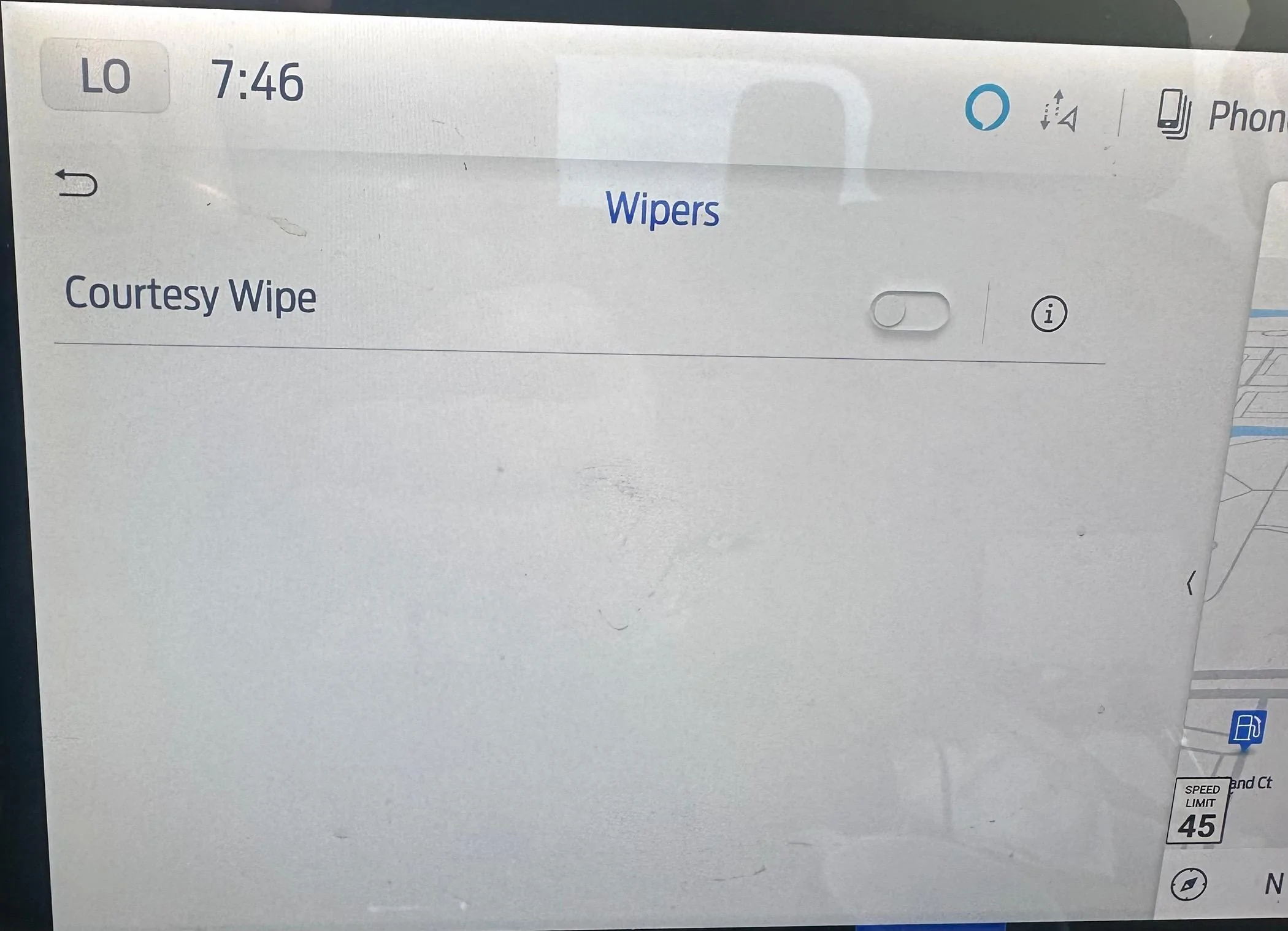

Windshield wipers completely stopped responding.
