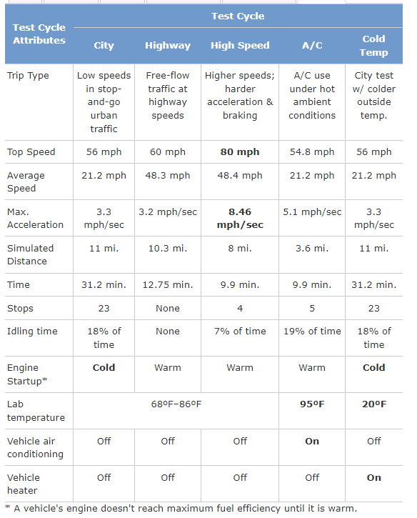

A 70 MPH highway average will yield worse range than the EPA estimates.
The three EPA city cycle tests (City, Air Conditioning and Cold Temperatures) each average 21 MPH. The two Highway cycle tests each average 48 MPH.
All good points, but I think the main point/question of my original comment was to challenge the idea that driving slow will get you there faster on EA’s charging network. It seems that at almost every state of charge and legal driving speed you’ll get there faster by driving faster and charging more frequently, depending on your time off the route to get to the charger and plug in. I don’t want to get sidetracked from OP’s post too much and 1st owner questions too if at all possible.
Not necessarily, the manufacturer can alter the data they supply the EPA in order to achieve marketing aims. I tried to summarize this here, but many trims of the Mach-E exceed EPA highway range and there's no reason to think that the F150 won't be the same.
Automakers can manipulate the rating system to achieve their marketing aims. They provide coastdown data (which encompasses aero effect, rolling resistance, etc) to the EPA and they use that data in their simulations. The automaker gets to choose the conditions in which the coastdown data is collected. They can also choose to use a two cycle test or a five cycle test. If they choose the two cycle test they have to subtract 30% from the final efficiency values and the five cycle test can be advantageous if they have better coastdown values.​
