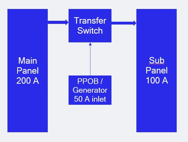

That's seems unclear from the OP. If it's for a critical loads subpanel then why a 100A switch? PPOB can only supply 30A.
Because the transfer switch can then handle more load when on utility power. That’s exactly my setup. I have several loads that I can’t use simultaneously on backup, but don’t want that limitation on utility power.

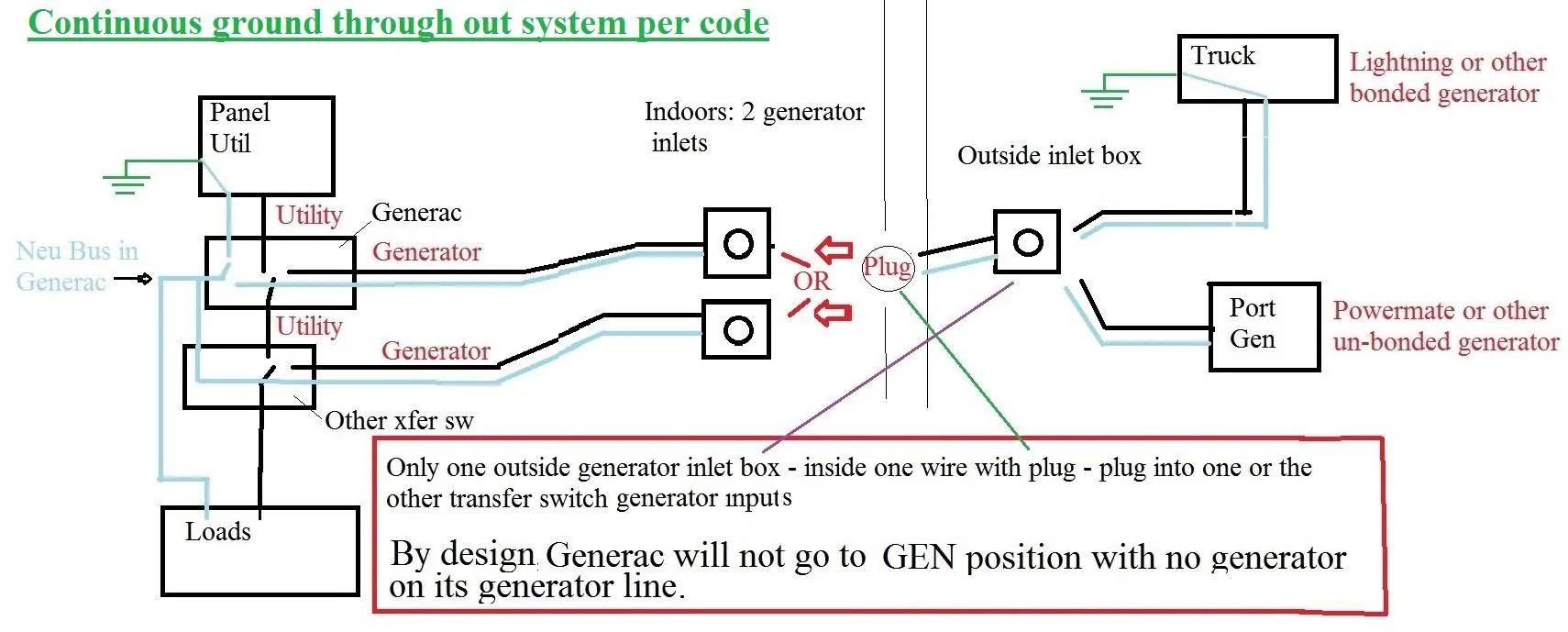

Update on my install (GENERAC 6853 transfer switch - without removing my old transfer switch):
Well, I tested it with the Lightning and got a ground fault.
In figuring out why I tested all the generator input box terminals for continuity and I found in the GENERAC STANDBY position (for generator input) there was 120V across the Neutral to Ground pins - popped the bulb on one of my continuity testers and popped the fuse on my other one before I realized there was juice there, lol.
I immediately knew that meant I had mixed up the neutrals inside my service panel on at least one circuit. So I put an AC voltmeter across the neutral and ground pins and by turning the breakers in the panel on one at a time, found the offending circuit.
It was quite a tangle of white neutral wires at the top of my panel but I found the circuit neutral wire that was the culprit - it was a place where two # 12 ROMEX wires entered the service panel through the same opening, which was why I got them crossed.
Only one circuit involved in the mix-up.
Switched them and all is well.
There is always something...
The wiring in block diagram form:

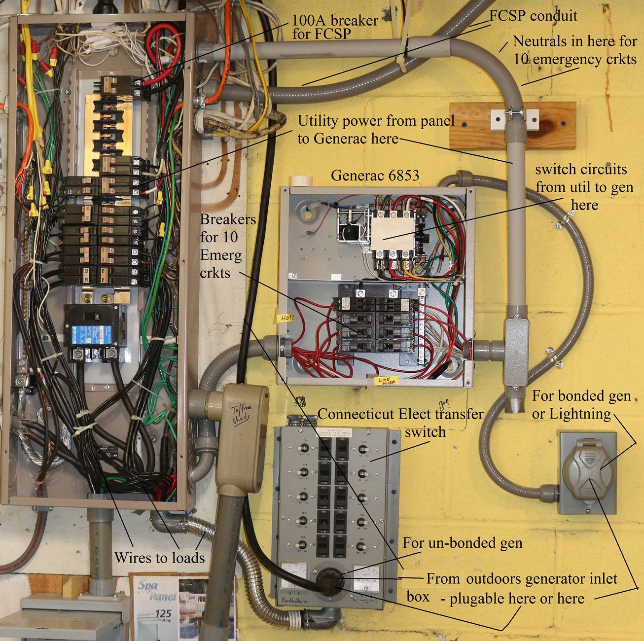

The fronts of the GENERAC and 200A service panel taken off to show the spaghetti:
Ford F-150 Lightning 100+ Amps Neutral Switching Transfer Switch IMG_5926-final wiring before gen tests
I was glad I used the WAGO wire connectors for the neutrals which made switching in the correct one easy.
Some of those wire nuts in the box were used by the electrician who upgraded the panel to 200A from 100A in 2011, and 10 of the wire nuts connect the 10 load circuit hots to the old transfer switch (black wires). The red wires from the old transfer switch go into the GENRAC which feeds the old transfer switch either utility power or Lightning/bonded source power.
