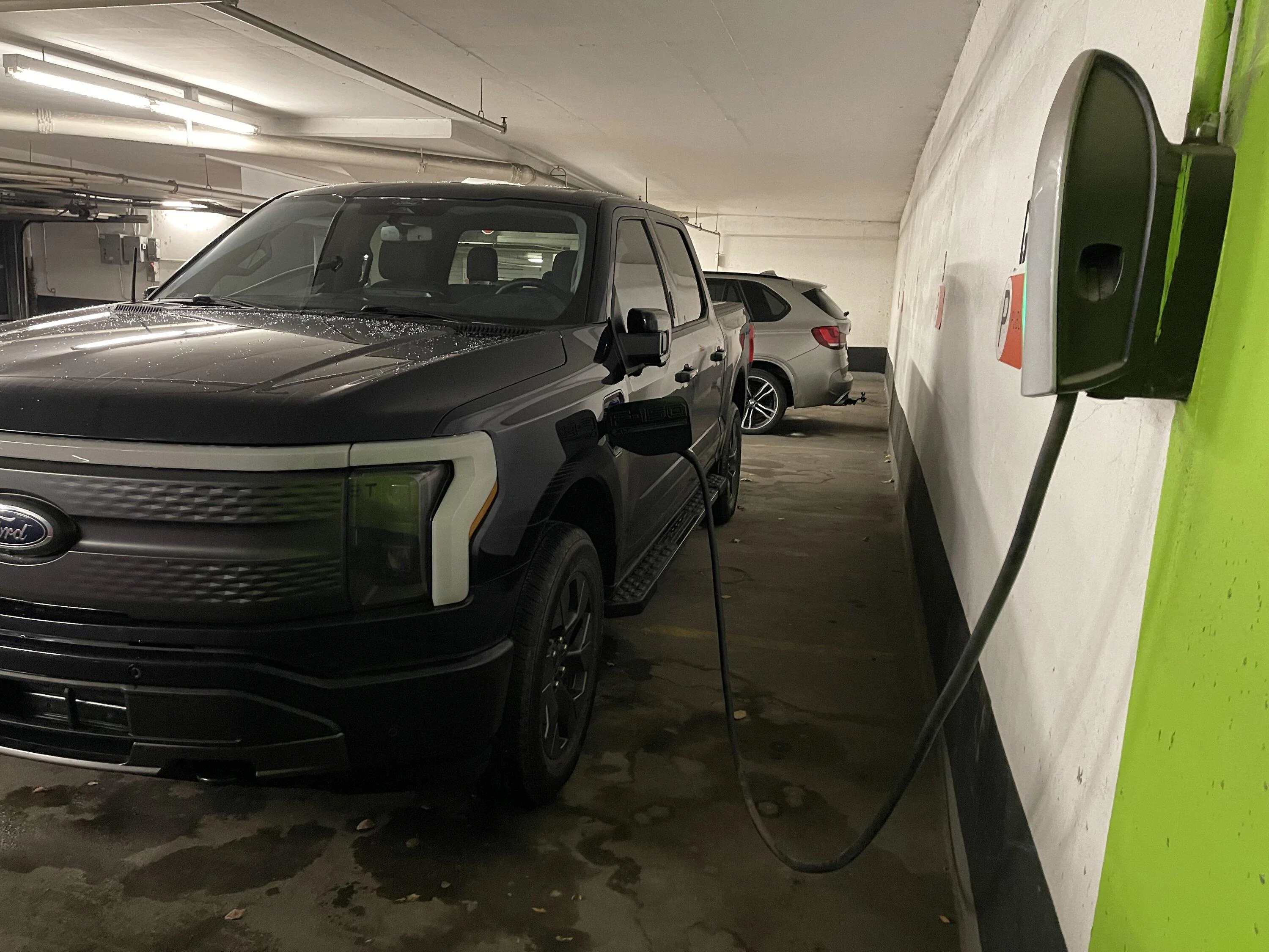

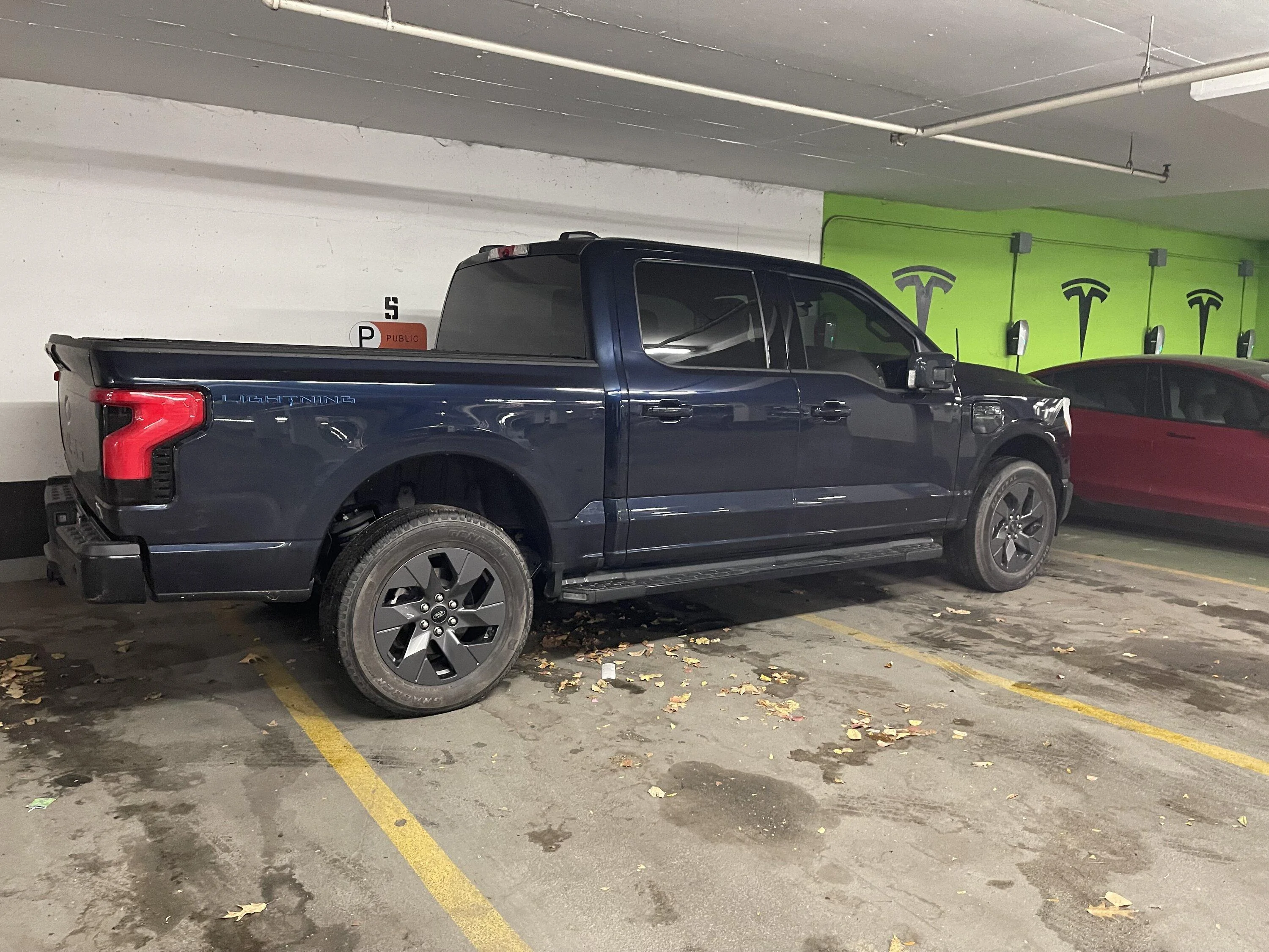

1st use of Tesla hotel charger
JRT
JRT
Jul 18, 2023
496
547
Huntsville, AL
Lightning
This is what I ordered
Tesla to J1772 Adapter-Max 80Amp 250V Tesla Charge Adapter with Security Lock, Safety Certified Tesla J1772 Charging Adapter Fit for J1772 EV, Compatible with Tesla Wall Destination Mobile Charger https://a.co/d/6G8G80y

It worked as advertised, I noticed no heat or issues. I did have to start the session in the ford app.
