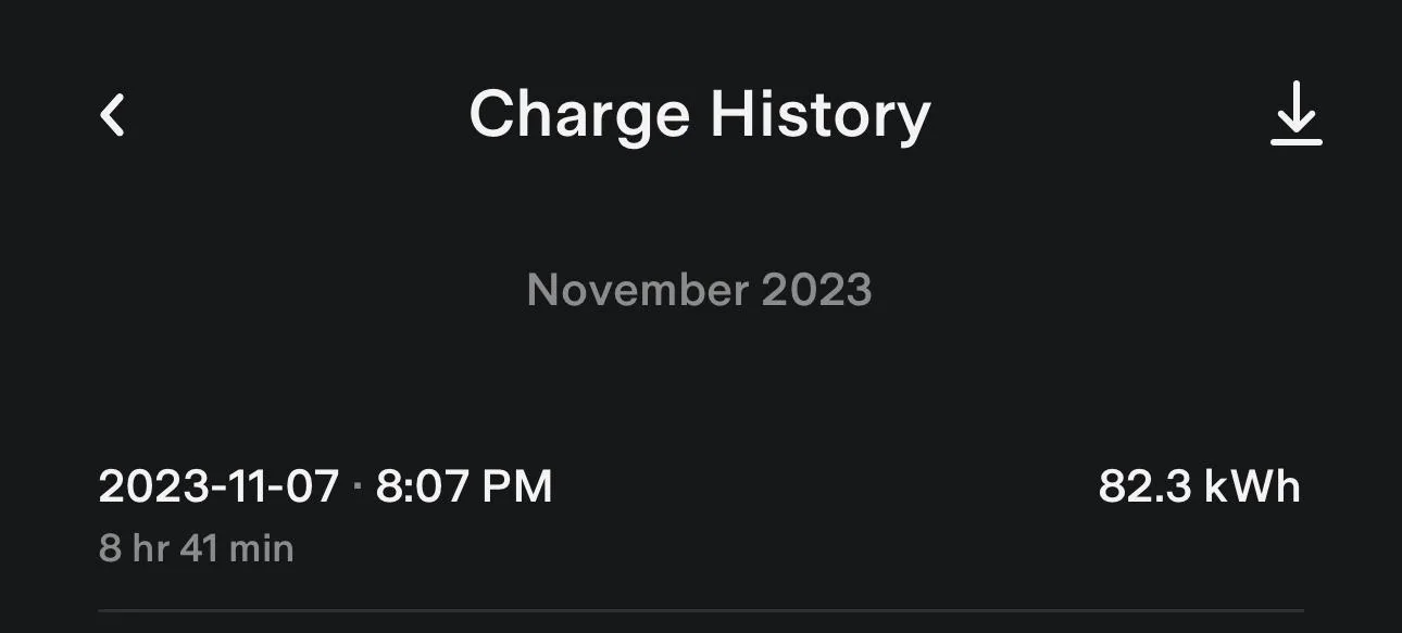

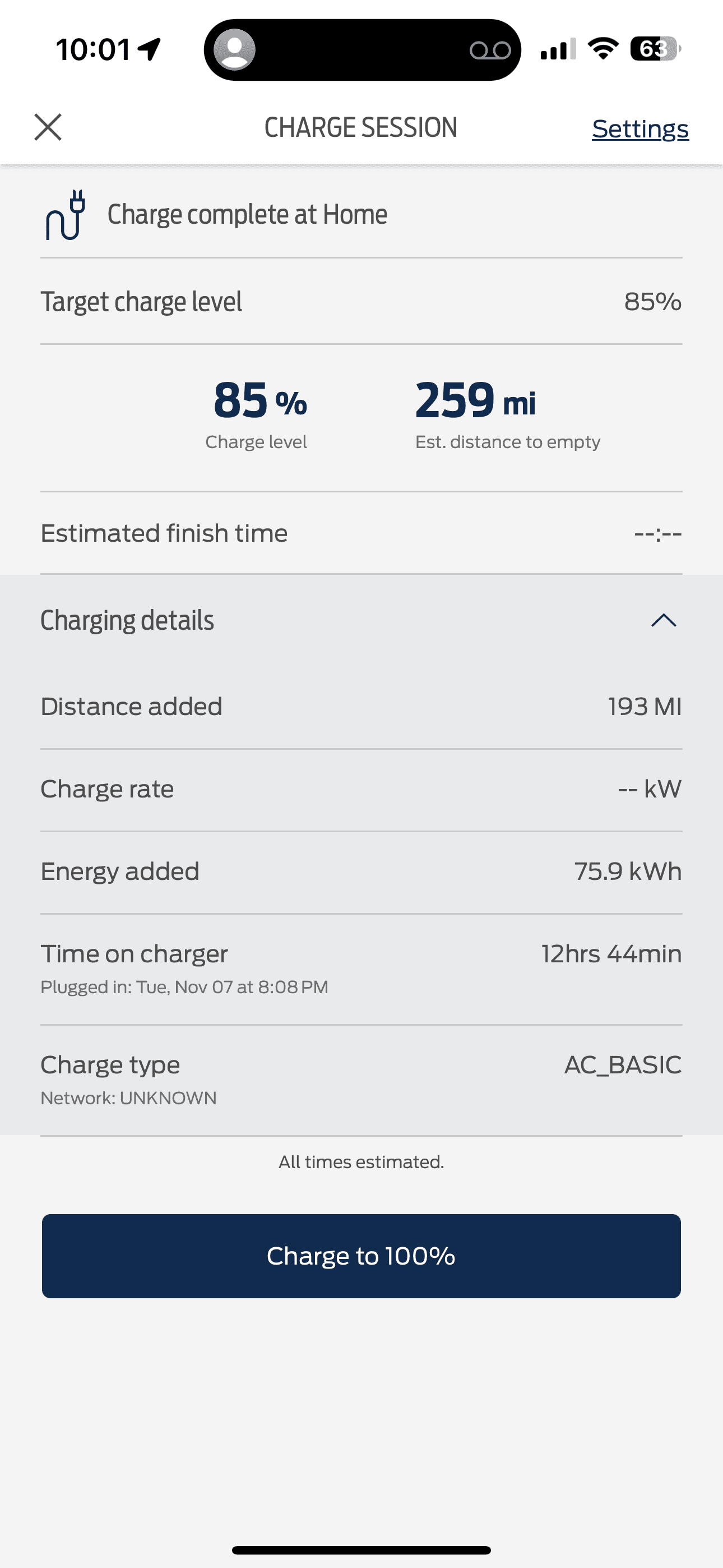

I got curious and calculated the efficiency of my charge last night to be around 93%. I verified the record from my Tesla wall connector with the electric meter on my off-peak circuit.

For comparison, my Model Y was around 96%.

Actually that math shows 92.2%, but yes, it's not 10% absolute loss. And it can vary a bit here and there. Mine is also 7%. If you charge on a different charger it might be different. 10% is easier for most people, who don't measure it, to just use.
That’s right, I was double-checking the truck’s estimate by dividing the 129.9 kWh capacity reported by the CarScanner app by the 59% incrase from 26-85%. It was close and I used the wrong number.
