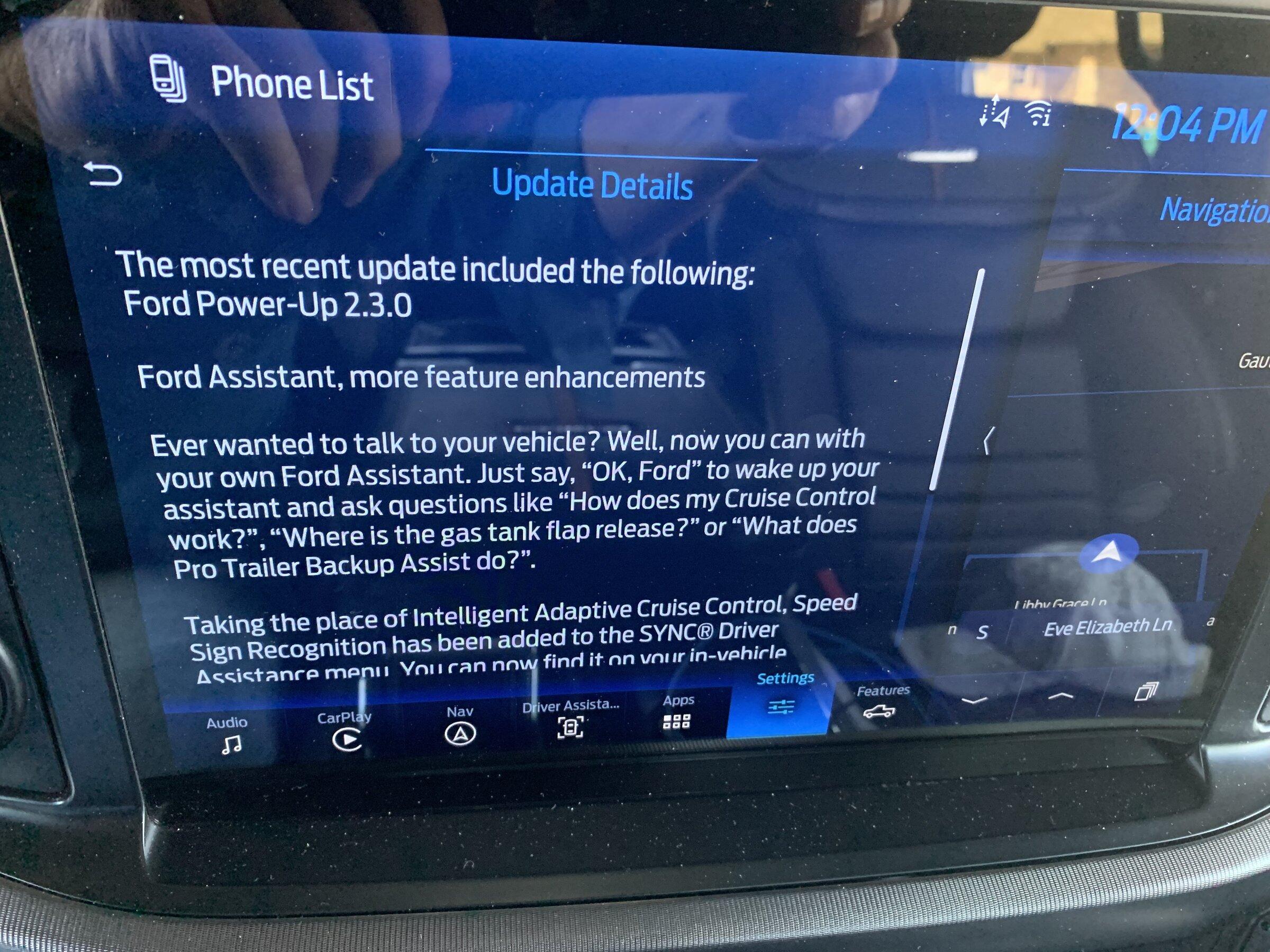

Still figuring the new stuff out, but how can you tell when you receive an update, or check your current version?
Click settings, then System Updates then Click update details.

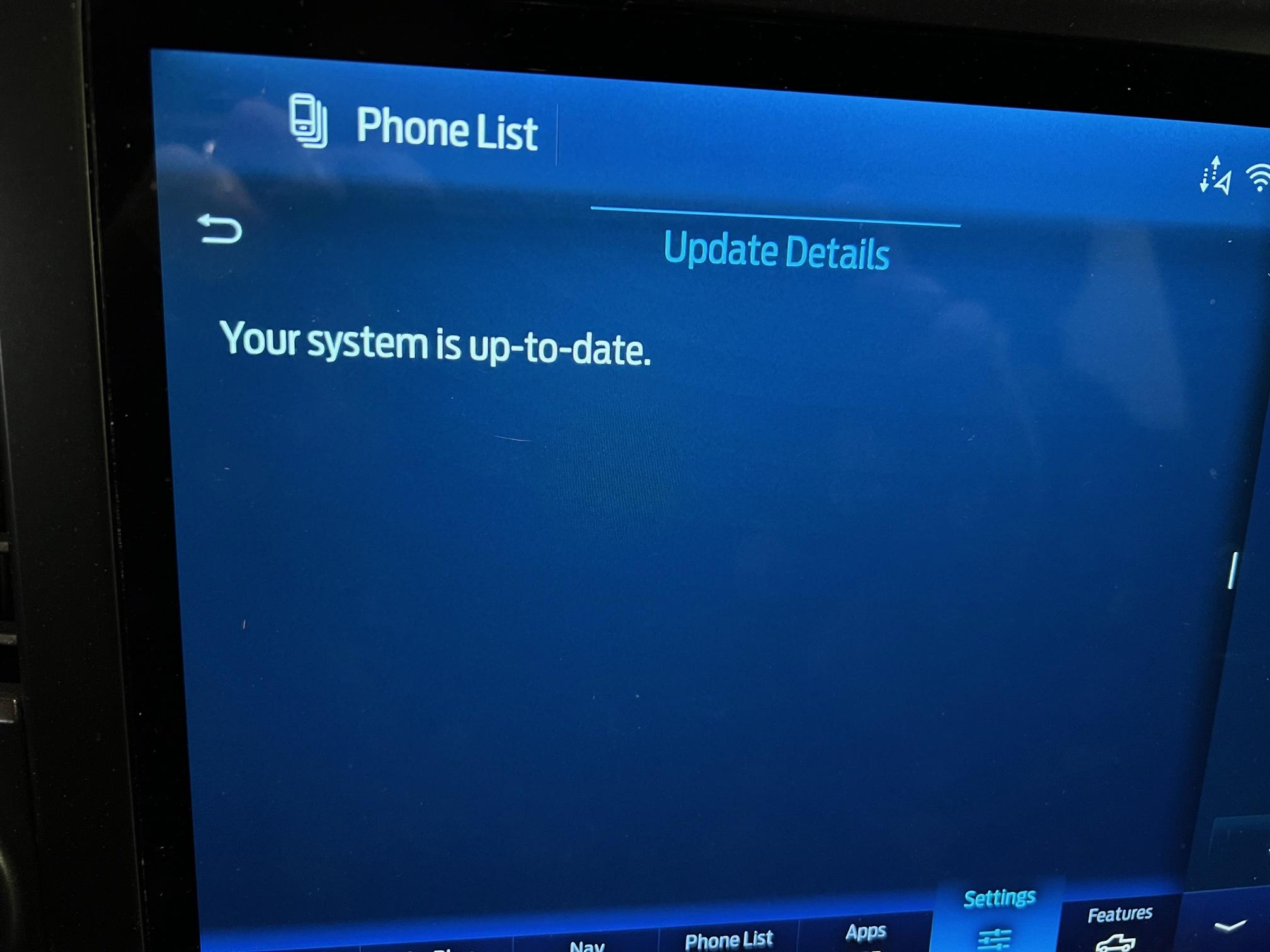

I don't get a screen like that I only see "Your System is up-to-date". Maybe I have never gotten any updates. I have Auto Updates on, Wi-Fi Connected, and it just checked for an update.
Mine was like that when I was somewhere between 1.7 and 2.3.
2.3 got it working again
