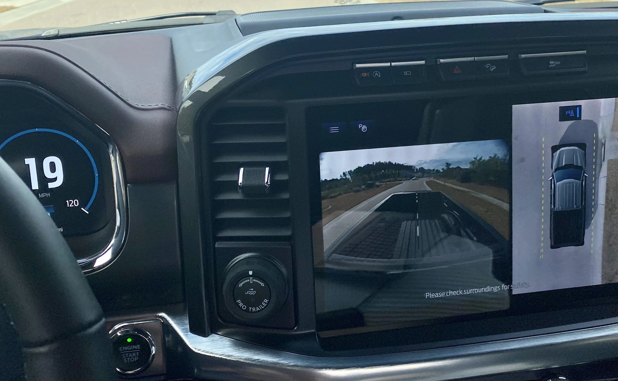

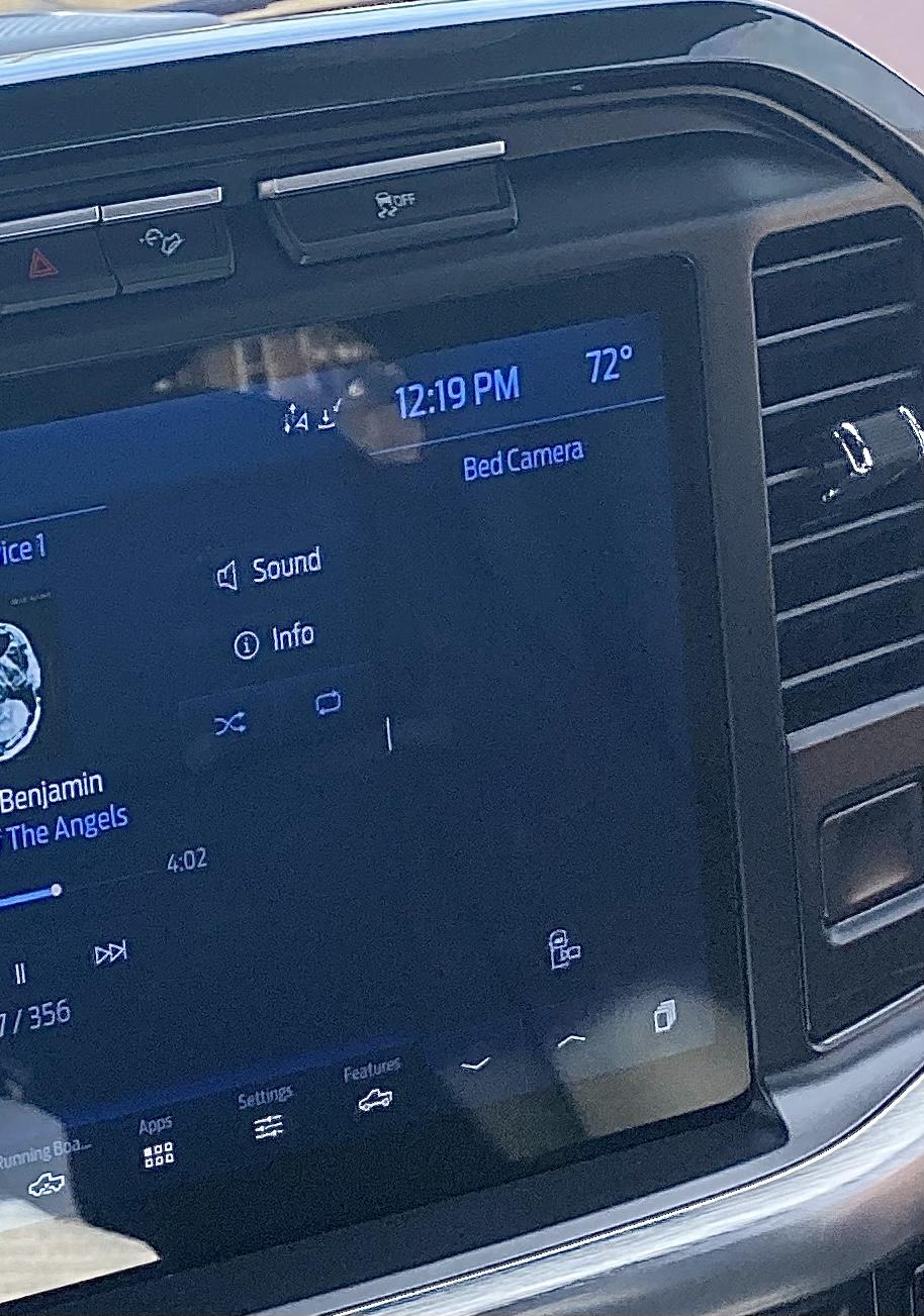

Well, one step closer. I can now look at the hitch view and bed camera in motion.
Unfortunately, I haven’t figured out how to get the side view rear cam to work. I have added the bed camera tile on the side view, but no image there. Maybe it’s one of the IPMA changes that @Jesse-Infotainment had mentioned earlier. Not sure yet if it’s an APIM or IPMA issue.
The video is there obviously, as seen on full screen, but something has to format it to the side view. Maybe a trigger command. There is a bed view soft button there as well, but it doesn’t do anything but beep.
See photos, I can press the camera button and it goes first to hitch view, press again and it goes to bed view while going down the road at any speed. I had too many other chores to do today to spend anymore time on it.
Yeah, unfortunately i believe that to be something the new IPMA that ships in the later builds is only capable of. That and the full screen Cargo cam. The IPMA did change in July builds. They are capable of both. I believe it to be the IPMA.
I haven't ruled out 100% the APIM with later builds adding it but I feel its low percentage. The onlt reason i havent ruled it out is due to not being able to test the newer build on my older IPMA. I hope to be able to soon.
It could be a combo of both the later build and newer IPMA. I messed with trying to get the cargo cam to display and could not. The calibrations are completely different between early IPMA and July IPMA>
Also it seems in conversation with livnitup the newer build limits the cam views in motion to those same views that we have with the IPMA update.

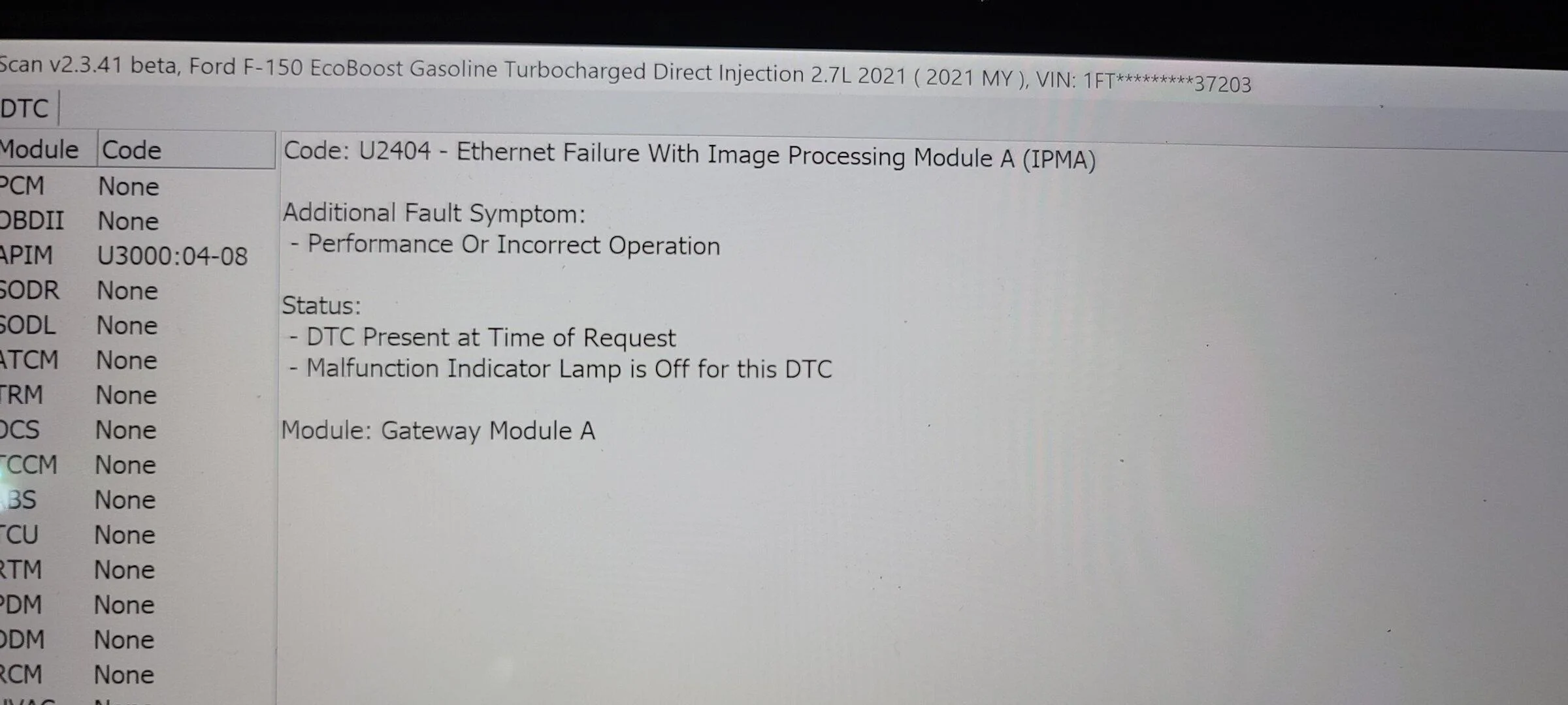

GWM, the specific module that was altered by the 2.1.0 OTA update is showing this DTC. Tried to restore the GWM module to my original factory as-built, but it said there were no changes. Tried to restore IPMA to original factory as built, and it gets to 8% and says service procedure interrupted. So, I went through and tried to write each line in the module one by one. All said no changes until I got to 706-29-xx. That one attempts to write, but shows service procedure interrupted. That particular line is for SensorCfg_DPAC_Homography3. I have no idea what that is, and I definitely never touched it.
706-34-xx has also apparently been altered, but cannot be restored. That one is listed as CustomerSetting_AHBOnOff_Pers1 (CSAHBOOP) • CustomerSetting_AHBOnOff_Pers2 (CSAHBOOP) • CustomerSetting_AHBOnOff_Pers3 (CSAHBOOP) • CustomerSetting_AHBOnOff_Pers4 (CSAHBOOP)

Yeah That DTC in regards to the IPMA ethernet was on mine after that 2.1 update as well.
What is the build date of your truck?
