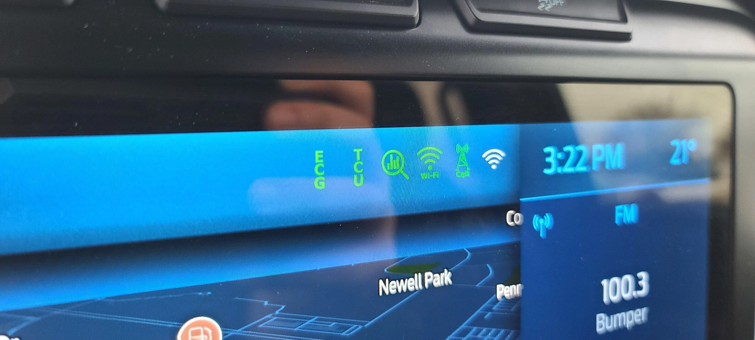

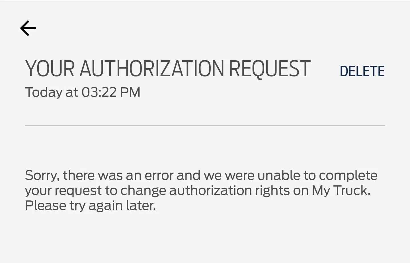

Well, I just tried that. Can't re-activate it at all now.
When I enable debugging it shows a cellular connection too. Doesn't make sense, and confirms to me that it's software related, not hardware.
