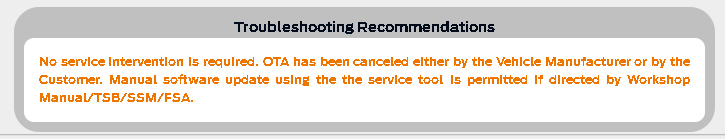

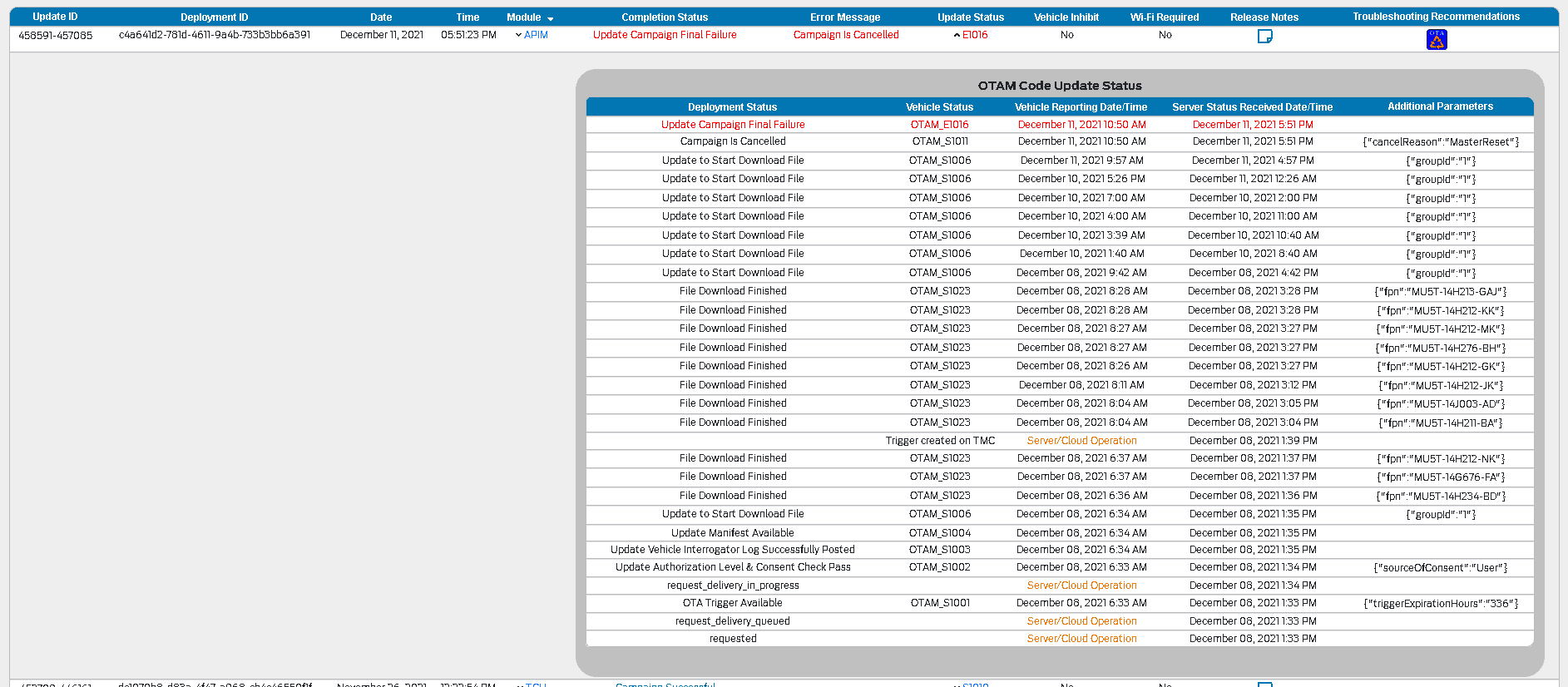

playing around with the FordPass API the following OTA info is available. Seems like for me 1.7.1 was cancelled for some reason. See below;
Yup. Your 1.7.1 is stuck. Shows as "Pending". Have you tried manually updating it in Sync 4?
Ford F-150 Lightning 2021+ F-150 FORScan List / Database / Spreadsheet ? 1639778141718
The same update was successfully downloaded and then cancelled on 12/11.
Ford F-150 Lightning 2021+ F-150 FORScan List / Database / Spreadsheet ? 1639778264999
Ford F-150 Lightning 2021+ F-150 FORScan List / Database / Spreadsheet ? 1639778293177
I’ve done a master reset and basically started from scratch. My auto update and notifications can’t be enabled, the schedule can be set but then reverts back to undefined on its own and when I click on update status it says it’s checking for an update but then comes back saying I’m up to date.

Are these screen just dealers can see? I'd be willing to pay for a subscription to see this data.
It’s in dealer level oasis. I have oasis but for me to see any of the connect data I would need permission. It would send a code to the user email association with the truck and I would need that code. Dealer level access doesn’t need permission. This would let you see any DTCs or codes without even plugging into the vehicle. Shows how many miles and even fuel level.
