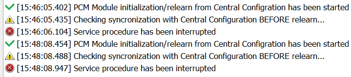

Anyone know what I'm doing wrong ?
Converted my 35x12.5R18 tires (34.5" dia) into the following because there is no direct conversion:
Ford F-150 Lightning 2021+ F-150 FORScan List / Database / Spreadsheet ? 1641171894066
Which puts out the following hex code/numbers to change in forscan:
Set BCM line 726-15-01 to the following:xxxx xxxx 0Axx
Set BCM line 726-15-02 to the following:66xx xxxx xxxx
Wrote the code successfully and then ran the PCM relearn to get rid of the codes (P160A & U0131), but the relearn never completes. It just says it has been interrupted at about 2%. Not sure what to do. Any issues driving the truck with these codes ?
You need to use the new updated version. You need version 2.3.44

Try removing the vehicle profile (vehicle-->profiles) and reconnect
I deleted the profile, reconnected the obdlink ex and still have the same issue, it just keeps saying interrupted when trying the pcm relearn
