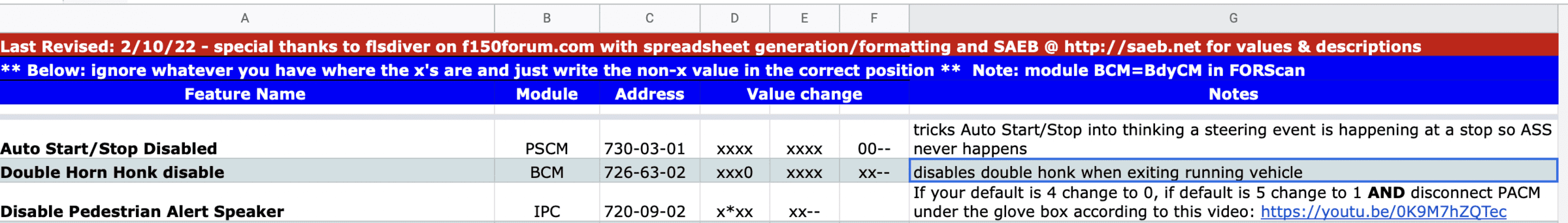

I am new at this, but I dont see the same values as listed in the reference table.
for example, I was desperately to disable the double honk, but my values are already at "0", but the guide states to change the value to "0"
Here is the guide:
and here are my values:
I have the double honk currently. What value am I supposed to change?

Not sue you had correct info to change double honk

Looks like there is a new rev of the file. I clicked the link in the first thread.
Where is the link for the new file rev?
Edit: Ah, I clicked the link for the prior MY. I only tried the double honk and removing the artificial sound. I will restore the values and look at the right list.

I've started adding FORScan spreadsheets here for anyone interested: https://bit.ly/3cJnYMS
Currently the newest version of FORScan can only change the BCM and 1/3 of the IPC (cluster) versions so when that changes I'll add the other modules as well.
